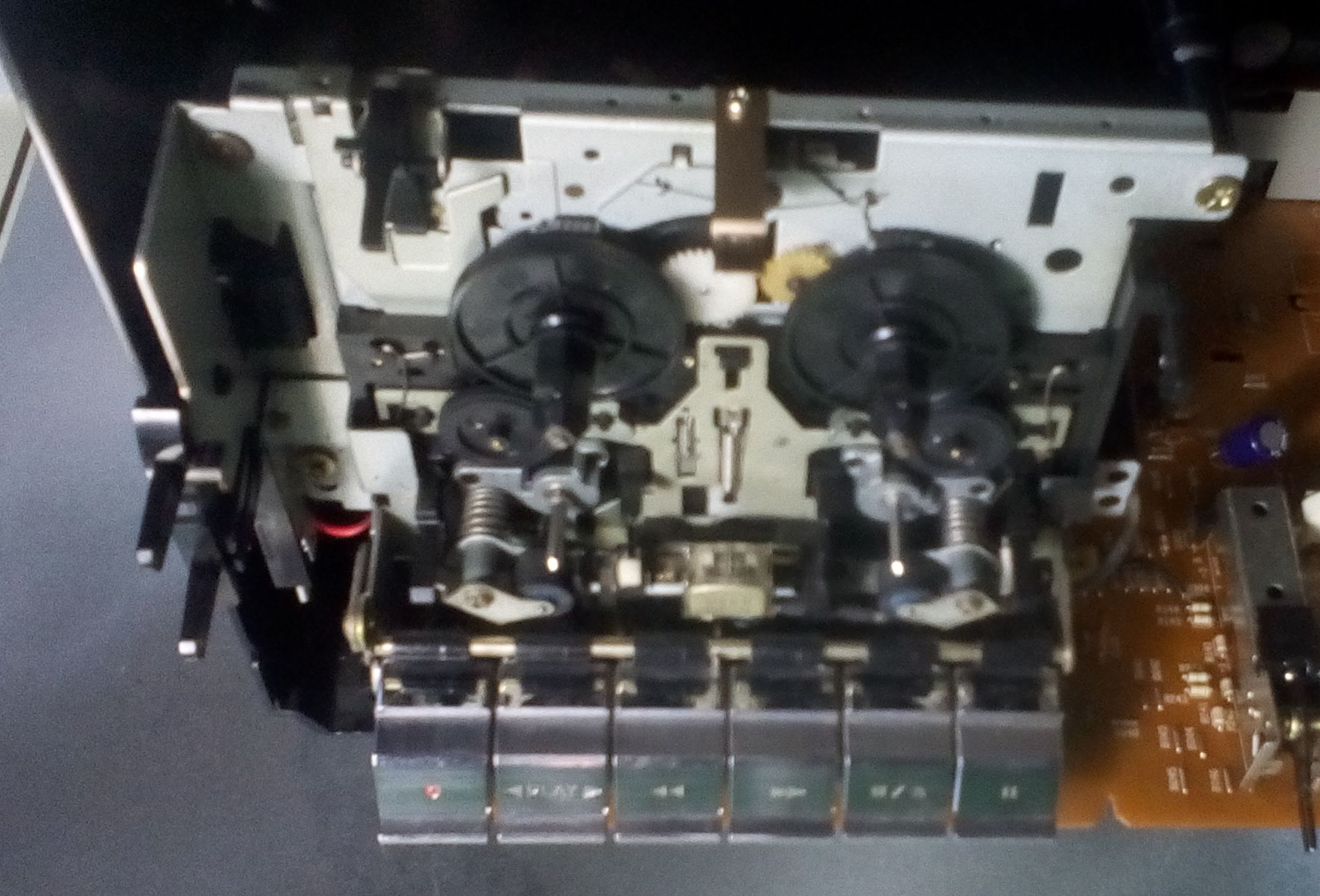

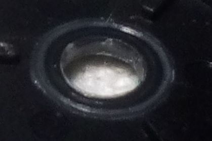

    The pictures I have taken are ugly.
    Here are two of the "better" ones:

    This is the auto-stop mechanism ?
    It's interesting that the mech looks to be a more complex variant of the Tanashin-type mechanism.
    There are 2 front idlers that connect the capstant to the table reels, what purpose do those have ? Are they for FF/REW ?
    In this type of mechanism, the clutch is usually in that small black pulley driven by the flywheel. Is that the case here ? Are there any other clutches ?
    You mentioned something about a felt pad in the toothed wheels area. Can you describe that more specifically ?

    Yes, it is the auto stop mechanism.
    The idlers are for play (right for f play, left for r. play).
    They are driven from the capstans, there is a toothed "ring" on them and they drive the upper toothed wheel of the reel assembly.
    FF and Rewind is driven by the belt from the forward play capstan to the black wheel in the center (RF CLUTCH ASS'Y in the SM) and then by toothed wheels to the lower toothed wheel of the reel assembly.

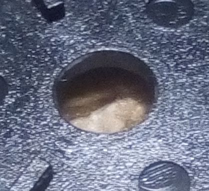

    There seems to be a felt between the upper and lower wheel of the reel assembly.
    It is visible on this ugly picture:
    To my knowledge there are at least 3 clutches, one in each reel assembly and one in the FF/Rewind gear in the center.

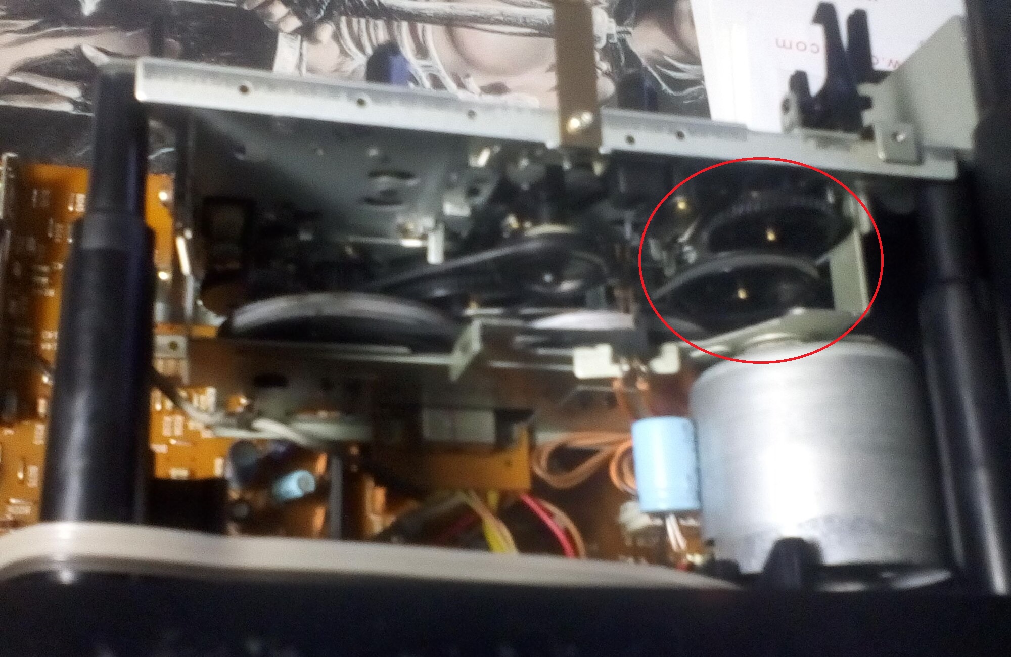

    Part of the auto stop/auto reverse mechanism seems to be under the reverse take up reel, the rest is on the right top on the backside of the mechanism.
    Screenshot from the first video:

    I have looked carefully at the videos provided, the only one that seems to point in some direction is the one in English. What has catched my attention are those 2 rubber idlers. The low reverse torque can be caused by either a slipping rubber idler or a problem with the table reel clutch itself.
    The low torque can be related to the auto-stop not engaging, if the outer part of the clutch is not rotating at all, but slipping at the rubber instead of the clutch.
    It seems indeed there are 3 clutches in this unit: one is on the belt driven pulley as in all Tanashin-type mechs, and another 2: one on each of the table reels.
    Did you replace the rubber on that 2 idlers ? Marian might have the correct dimension in stock, check his website.
    I suppose the belt driving that cam gear is not slipping, as that could also be an issue. The auto-stop mechanism itself seems similar to the one used in Sony mechanisms, with a rotating cam and a lever that gets pulled in a certain position when the drive table reel stops rotating, at which point the cam will engage the stop.
