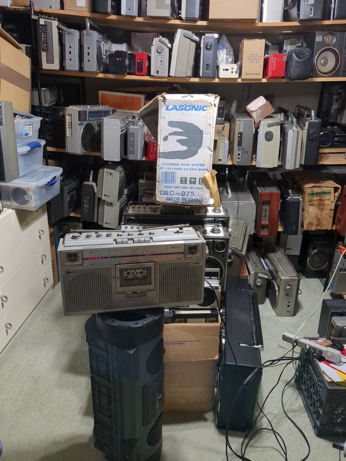

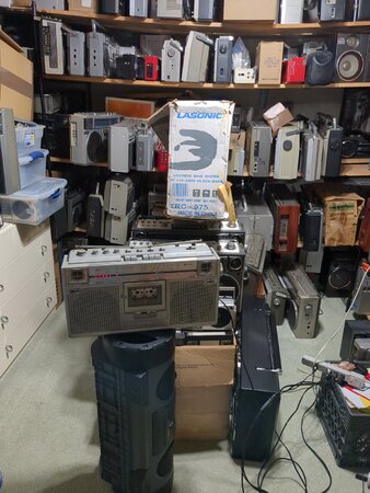

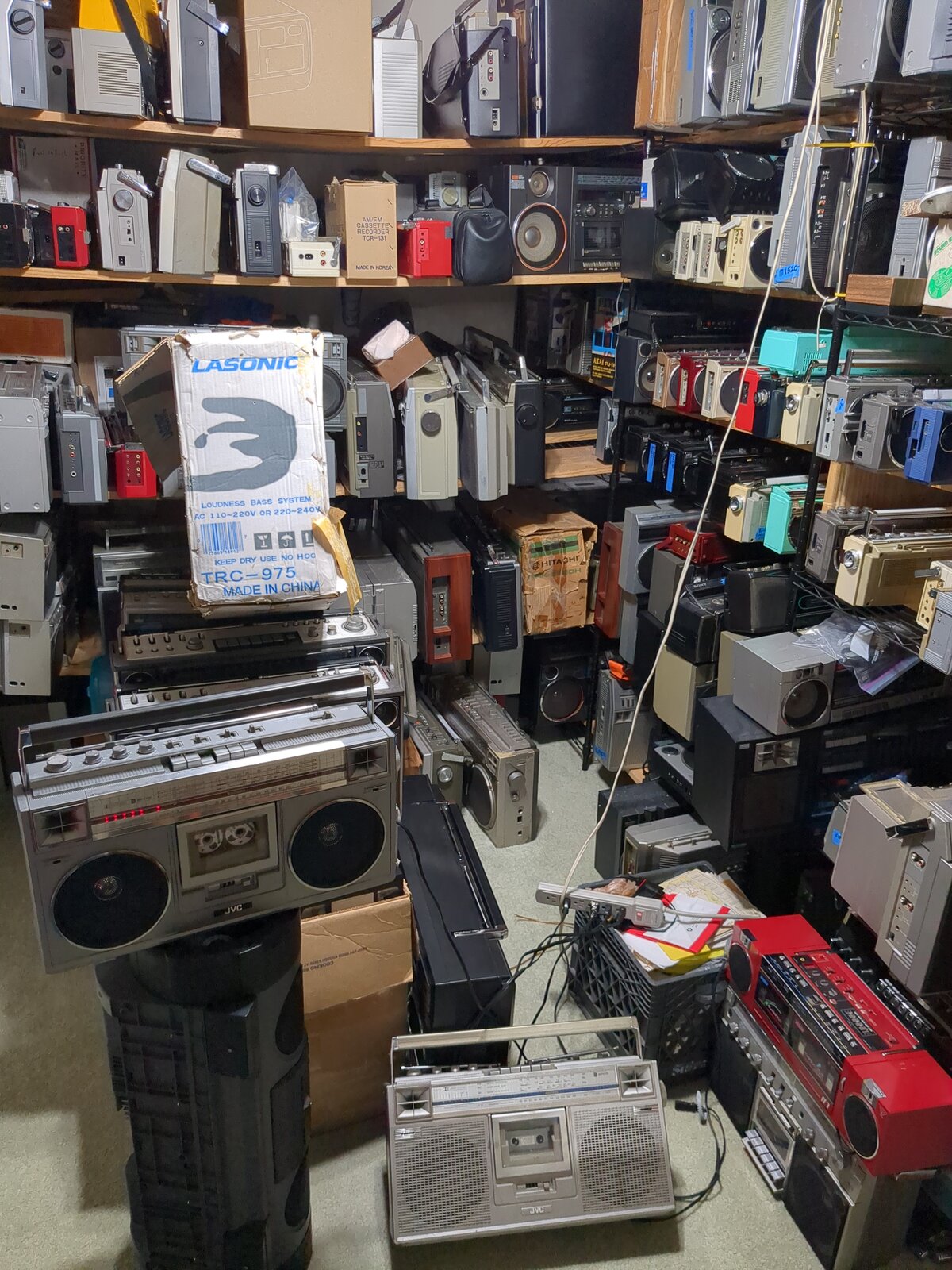

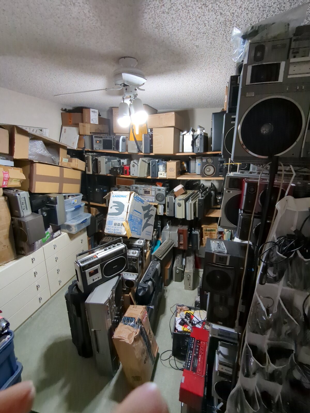

    I just pulled mine off shelf. Put a tape in it. Hit play and it popped once or twice after I worked the switch a couple times and after that it stopped. So I suggest you clean yours more thoroughly the switches and check all your grounds that I've done with mine. Mine is playing right now. My famous tape. Here's a picture. Don't mind if there's a few others boomboxes in this room. I've got a few LOL
    Did I mention I have both models?
    The other one is the JVC RC 656 c. Mark II with the blue speakers and the open grilles.
    Post script if you don't know already the c in the model number stands for Canada. At least that's what they told me.

    I have a Sony CF something but I can't find it because I have too much stuff and nobody's bought anything or even giving me an address to ship something to. And I do have some monos in here. But I just don't have enough room to move stuff around in here and show them. So I've displayed a couple on the top shelf and I found this JVC rc-443jw here's a picture.
    I do have the rc550's monos but nobody's interested in those.
