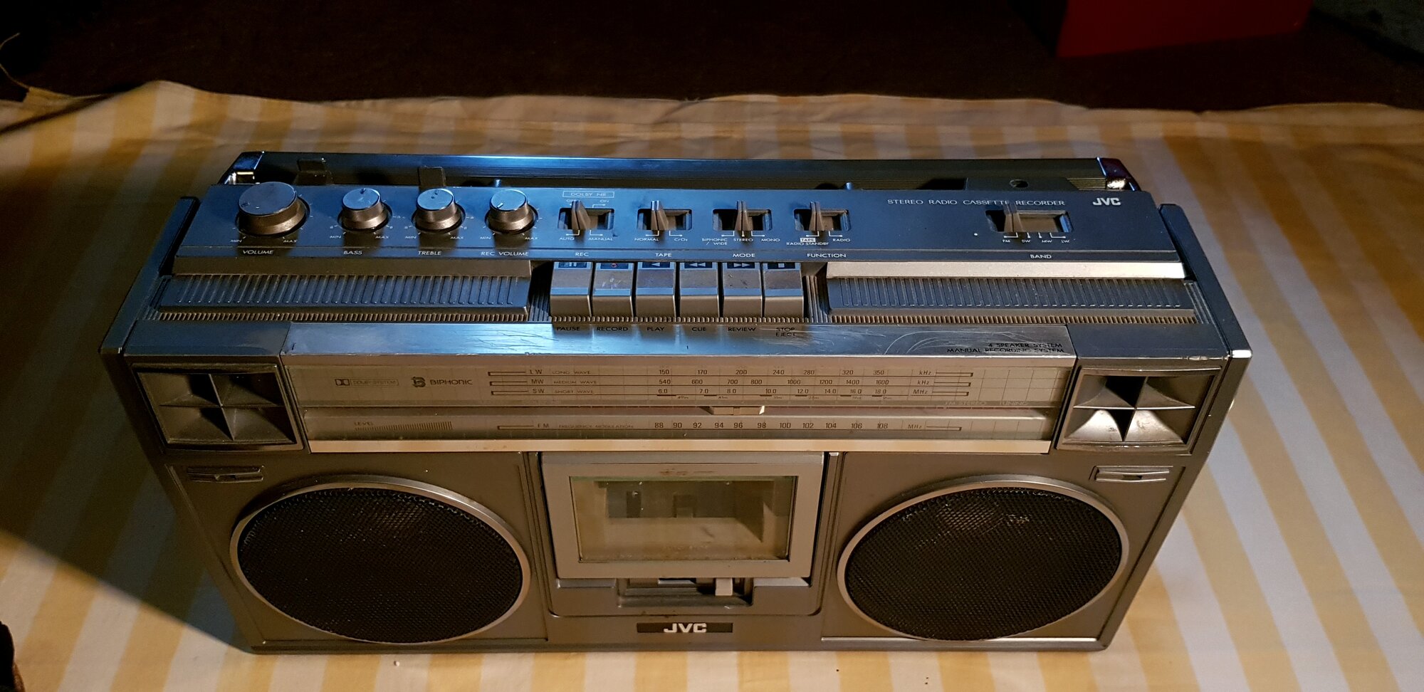

    I got a JVC RC656 Boombox, and i need help. Radio is working, but Cassette gives a deep humming, when "Play" is pressed. I have no knowledge in measurement and repairing electronics, so i`m looking for a good service, who can do a general overhaul , in Germany. My favorite is just overloaded with orders.

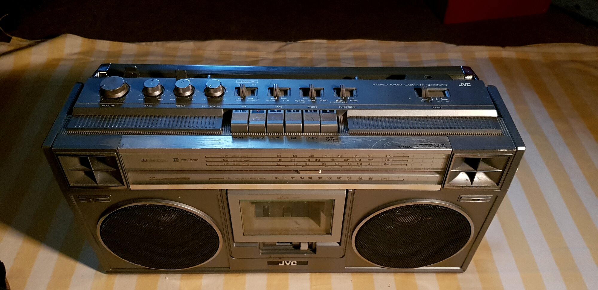

  9. Cassette2go
    1,574

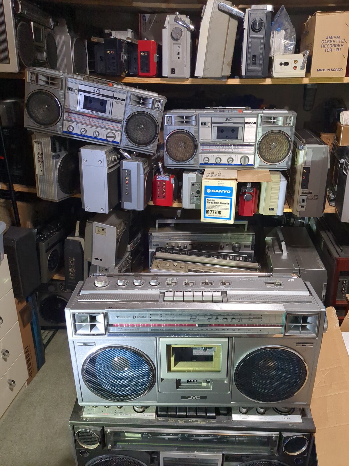

    Jvc 656C Mark II with the blue speakers and open mesh grills, I have the same model as you. Mine works perfectly and for sale if you interested in buying it. 1718649041201521951824523066864.jpg
    decentman4you2007@gmail.com and in the background is a pair of JVC RC-770jw and they both have Dolby for the cassette playback. And I made videos about those as well in my cassette2go youtube channel when I repaired them last. I'm in Dallas, Texas, USA.

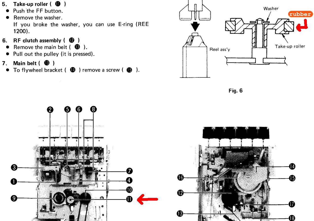

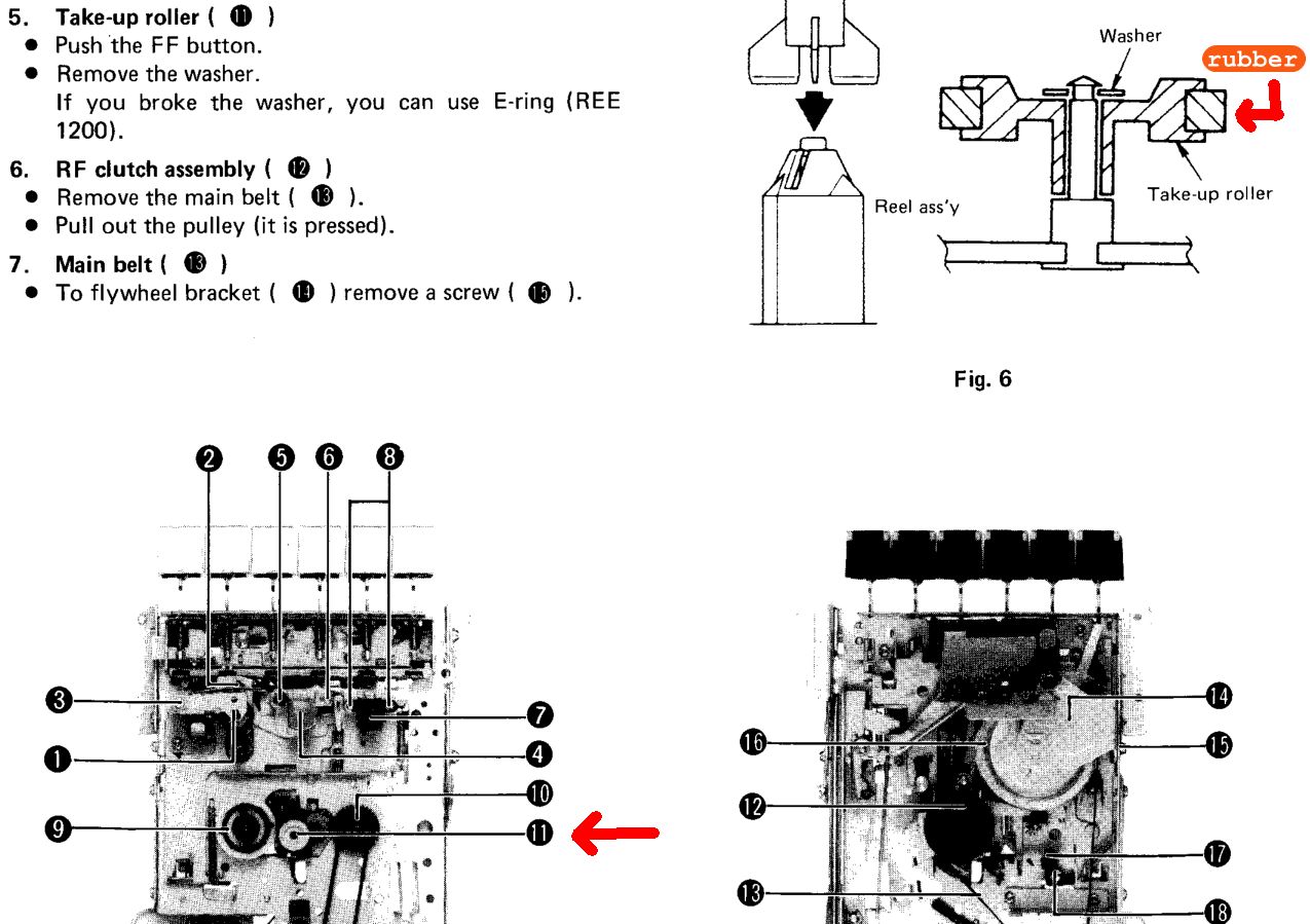

    Now i have new informations - it seems, that the take-up roller is slipping through - the bandspeed isn`t constant. I have changed the belt, its tension is OK.
    May be , the rubber of the roller has become too hard - it can`t take the driven part with it. What can i do, to reactivate the roller ?
    Or is there anybody who has a irreparable JVC ( or other compatible ) to sell parts ?
    I tried to remove the rubber - there is too much tension on the roller.

  11. Cassette2go
    1,574
    I use a straight pick two of them and I can work that tire off of The plastic wheel. Yes, there's a lot of tension because it's a small rubber tire.
    As far as getting one off of another old machine is going to be the same issue because it's also going to be worn. You need to replace it with a new tire that's why they sell them.

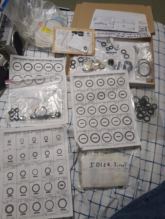

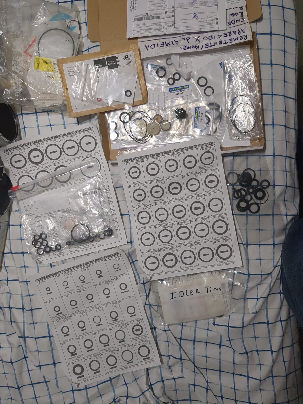

  13. Cassette2go
    1,574
    You have to measure in millimeters, the ID, the OD and the thickness and then search Google for idler tire and you'll find it
    Basically 2 mm thickness and the ID is all you really need to be concerned with
    17225890335941655173404633526020.jpg I know because I have bought them and I'm still searching for them on occasion
