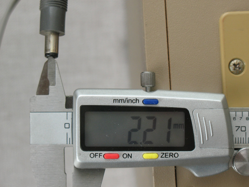

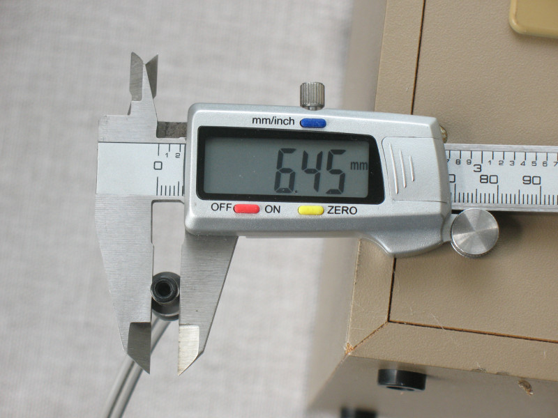

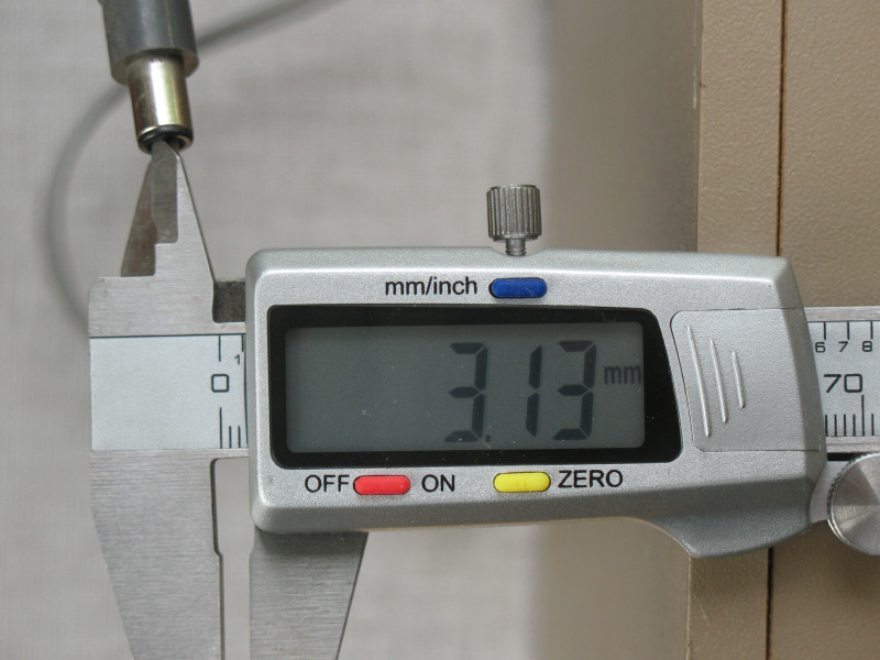

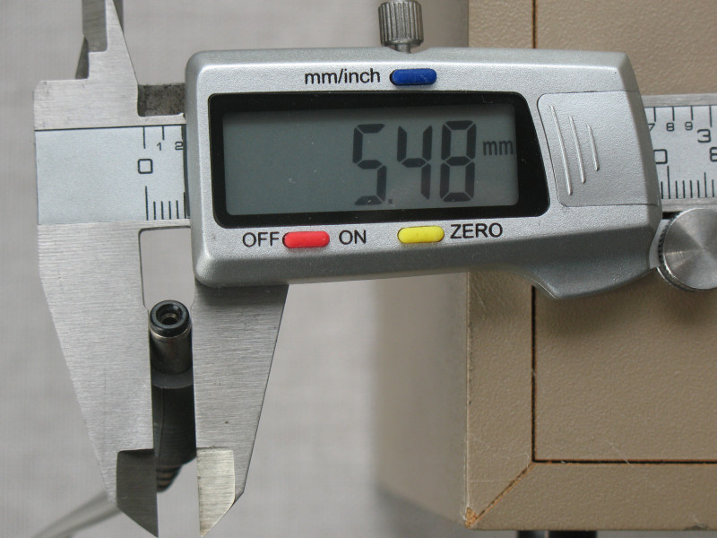

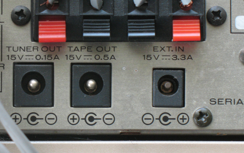

    Hi Tom,
    I assume you are looking for the measurements of these connectors.
    Notice the OUT connector is + polarity outside, the IN connector is - outside!
    The measurements of these voltage connectors are (all in mm):
    Large connector outside:
    Large connector inside:
    Small connector outside:
    Small connector inside:
    The total length of the cable is 45cm long.

  11. StaticAudio
    StaticAudio Active Member
    114
    The Netherlands
    Well, I thought, if you're measuring this, let's measure accurately :biggrin:

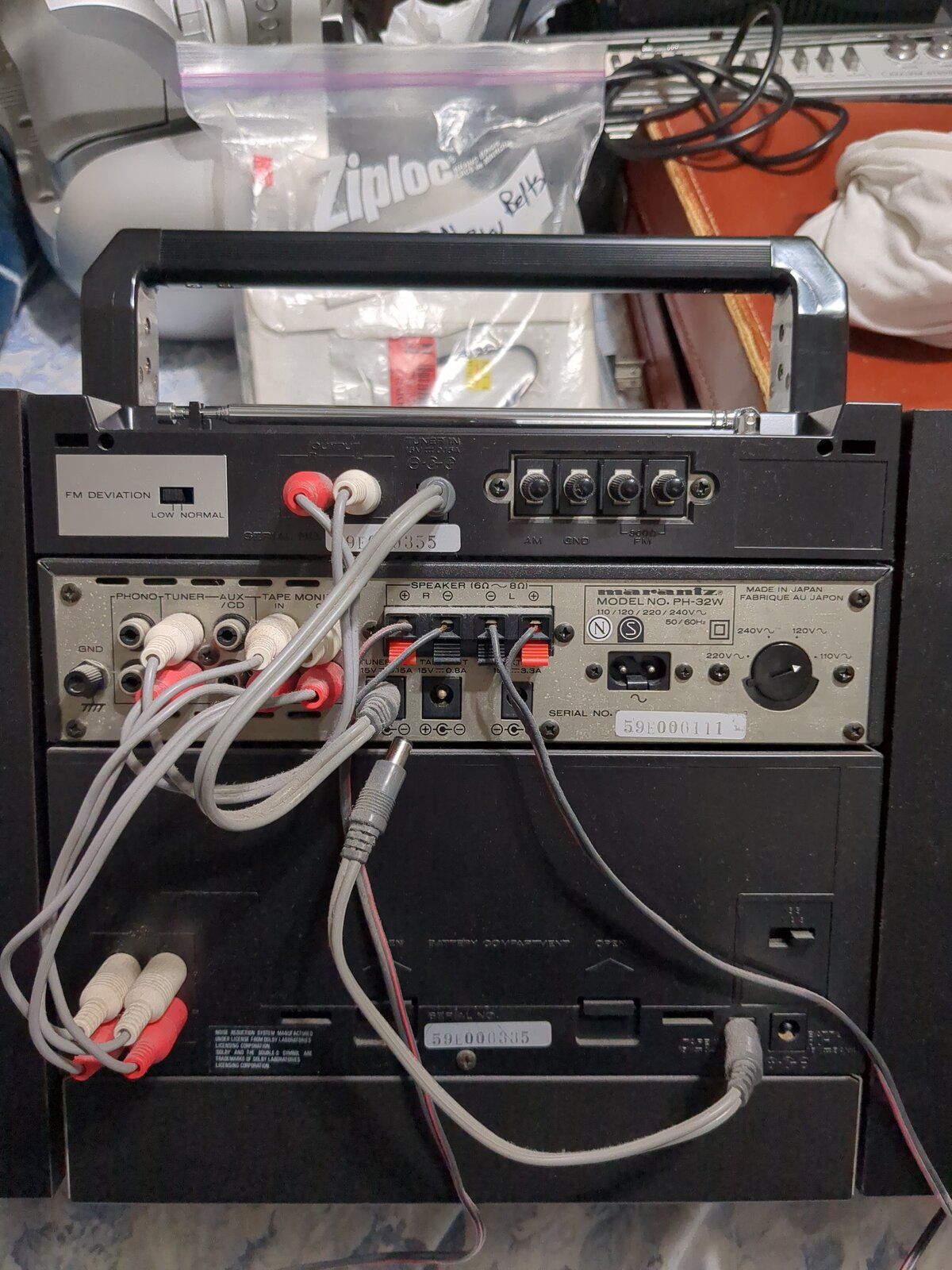

    1,574
    Here is a close-up picture of my marantz pH-32w and I unplugged the one plug, which is a barrel style plug but that's where it goes as it is nearly pointing to the hole that it goes into. I also posted a picture of the front of this model in the boombox media area, wherever that is in this site. 16 years ago I made a video about this in my YouTube channel by my same name. Oh not my same name. My old name or my first YouTube account is or was or still is, Decentman4you. And if you read under the description there, I posted a price that I will sell it for 16 years later. Oh well. Yes that plus shipping this is complete. It's just the volume. Knob is not correct but I found something that fits. 17186481118696458607780258866120.jpg
    I can't believe when I searched for my own video that it said the video was 16 years old. Yes, I've kept a lot of boomboxes in air conditioning comfort. I'm sure it needs belts and no I haven't played it in a long time but it is complete except like I said the volume control knob is different. decentman4you2007@gmail.com email me any questions. Thank you.
