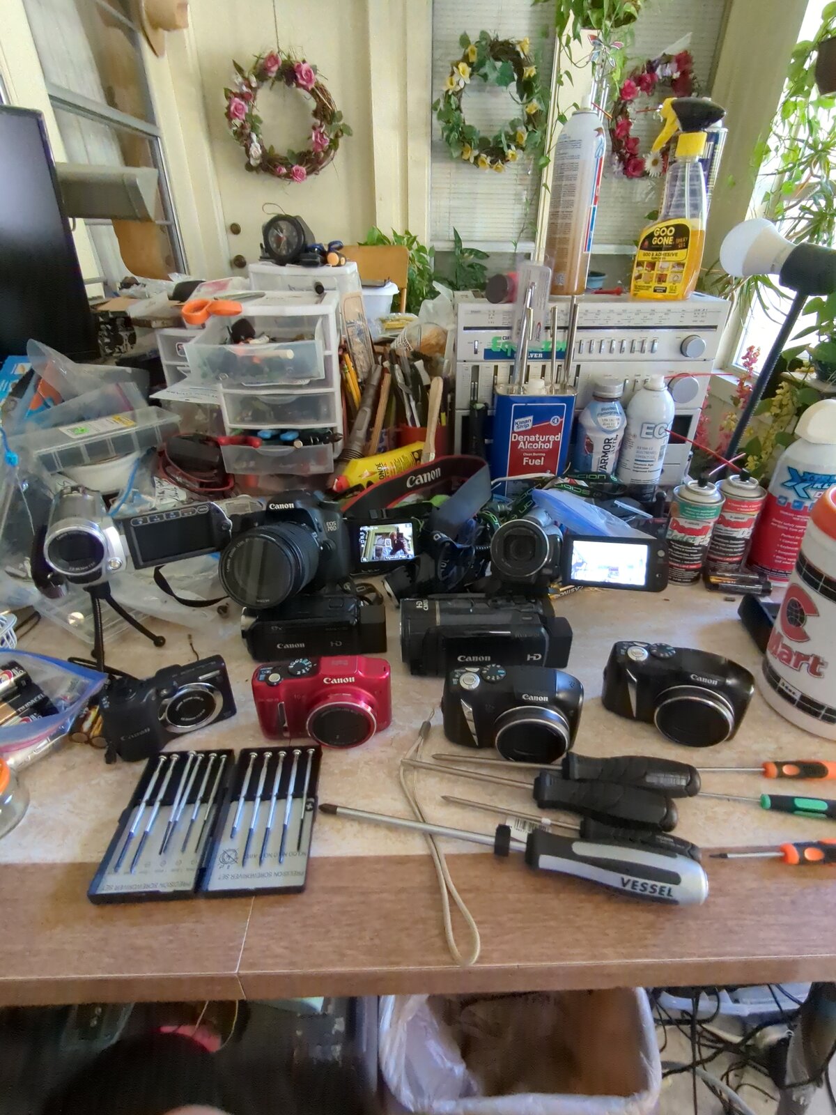

    Hello Guys,
    One the useful Items among my bench is my apple Ipad great for photos
    I use on my bench is Anti static mat with ground Get yourself nice little cabinet to store various sizes of Electrolytic capacitors and resistors plus good selection of belts and good tasklighting I also have digital microscope .
    Far as parts digi key or mouser plus Ebay but don't buy no-name capacitors .
    I have accounts with factory parts dealers too since I used to do a lot warranty work .
    Sincerely Richard
