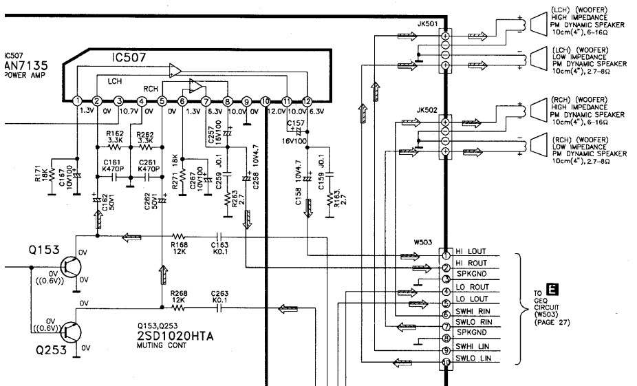

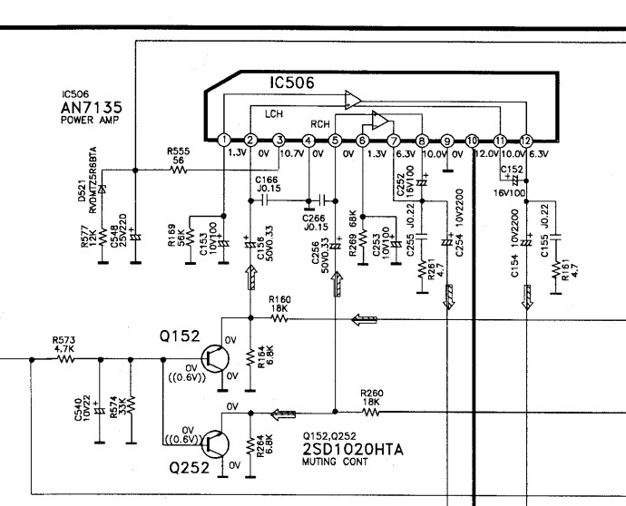

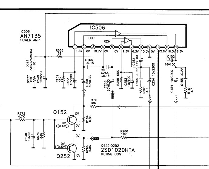

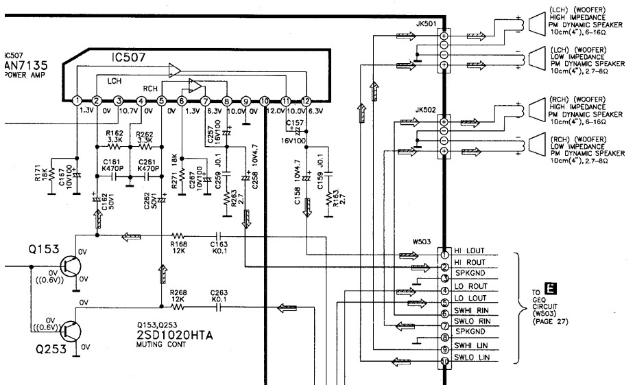

  12. Longman
    3,883
    I just downloaded and checked the schematic for my RX-E300 boombox with Bi-Amp ed speakers.
    It uses two AN7135 stereo amplifiers ICs, one for the bass and one for the treble. A big clue is that the output decoupling capacitors are 2200uF for the Bass and only 10uF for the treble. Each AN7135 also has a different filtering arrangement on its input
    Bass Amp Treble Amp
  13. Radio Raheem
    1,961
    This answers the question of using 2 old 80's amps for the 4 channels it just woudn't work imho and i would risk blowing one of the amps as i would be running a high load into a pair of tweeters which i am not willing to risk....my monitor audio are bi wired to i think all new speakers are these days.......if you ask me it's a feature that wasn't needed imho
  14. Silver965
    Silver965 Well-Known Member
    721
    Torino
    I know this configuration exists but I have never seen it in production .... 4 speakers of the same size with different impedance on woofer and tweeter and a different equalization network in input to the amplification ... each chip only amplifies the band assigned passerby ... @Longman feels okay ?? I have never tested such a thing

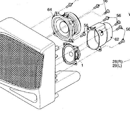

  15. Longman
    3,883
    I don't know why they claim the speakers are the same. Later in the same manual it clearly shows that the treble speakers are smaller than the woofers
    One of the Panasonic Cobras does have the bizarre arrangement where the long throw woofers (with the fancy surround the always rots) is smaller than the tweeter although even there the speakers are clearly different.
    I wonder how much of this was marketing hype (although they couldn't have labels on the speakers saying "Bi-Amp system" if they didn't have one), how much it was for better performance, and how much (if anything) it added to the cost. The AN7135 ICs (a Panasonic device) were probably a couple of dollars each for them and the resistors etc on the inputs would be cents.

  17. Reli
    1,024
    That seems like it may have come from another manual. The front page of the RX-E300 manual says the "woofers" are 8cm and the "tweeters" are 6x7cm
