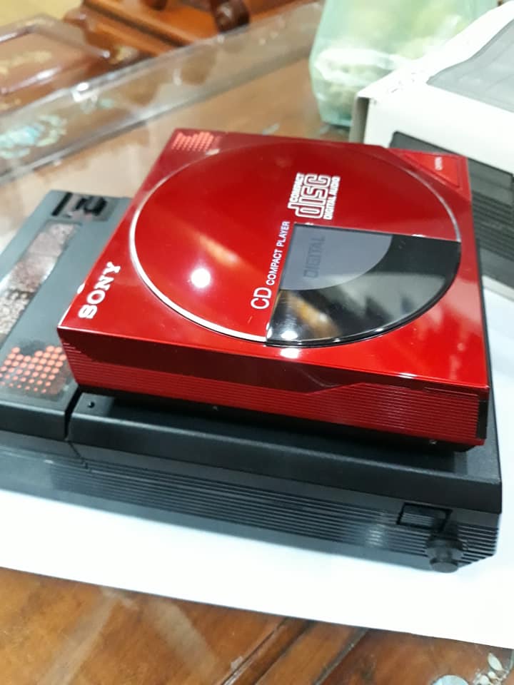

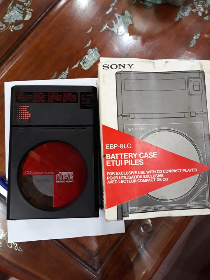

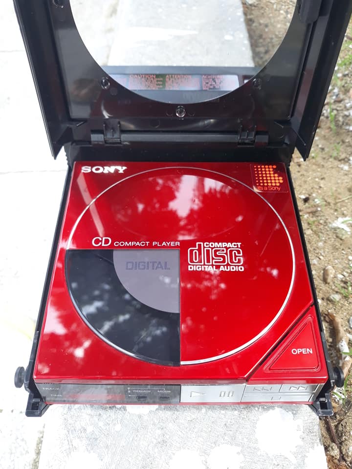

    Got this beautiful few months ago. It came with cover case and box, but unluckily can not read Disc anymore 118226280_3594655437211861_3032667712697186786_n.jpg 117769846_3545919685418770_2823037090351936706_n.jpg 117435843_3545919375418801_7016007062843753563_n.jpg .
    Here are few pictures to share with you. Enjoys. Thanks.

    Indeed, D-5 is the very first Discman ever made, came before the 'Discman' term was even invented. As with D-7 and D-10 Discmans, it is pretty rare in red or white, nice catch! Shame it is just a paperweight. The easiest fix would be to buy one working D-5/D-50 (most of them are still OK, unlike its younger brothers, D-5 is seemingly indestructible) and to switch the shell. Since yours looks New, there is a good chance laser is still strong, then it might be an easy fix.
    Just do not expect much in terms of sound quality: D-50 is the player which gave such a bad rap to CDs. Even folks at Sony must have realized that, and quickly re-designed it into D-50 MkII (later renamed as D-7) which also has brick-wall digital filter (oversampling had not been introduced yet) but sounds absolutely marvelous! My personal "dream Discman" is D-50 MkII or D-10 in red or white... :cool:

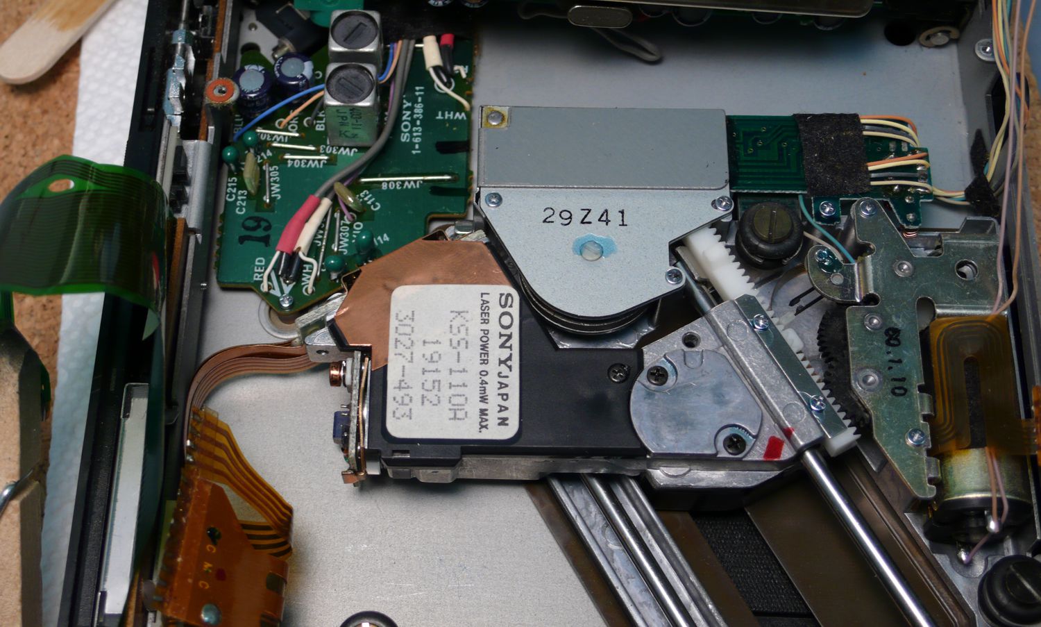

    Luckily, @koleloi Discman is fine now. But @lupogtiboy is absolutely right: practically all Sony Discmans worth buying have this problem of a 'frozen' and sometimes even broken sled gears. Most infamous models are D-150, D-250 and D-90 where Middle Gear spins on a brass pin but oil used by Sony found a way for some kind of a chemical reaction between brass and plastic. Oil itself gets rock-solid, plastic gear turns green and then crumbles...
    No such problems in D-5, but if any teeth get broken you must find another Discman for a donor. Since KSS-110A mechanism is unique for this Discman, you need to buy another D-5. Luckily, unlike D-88 this D-5 model is not too expensive and there is always a few choices on eBay.

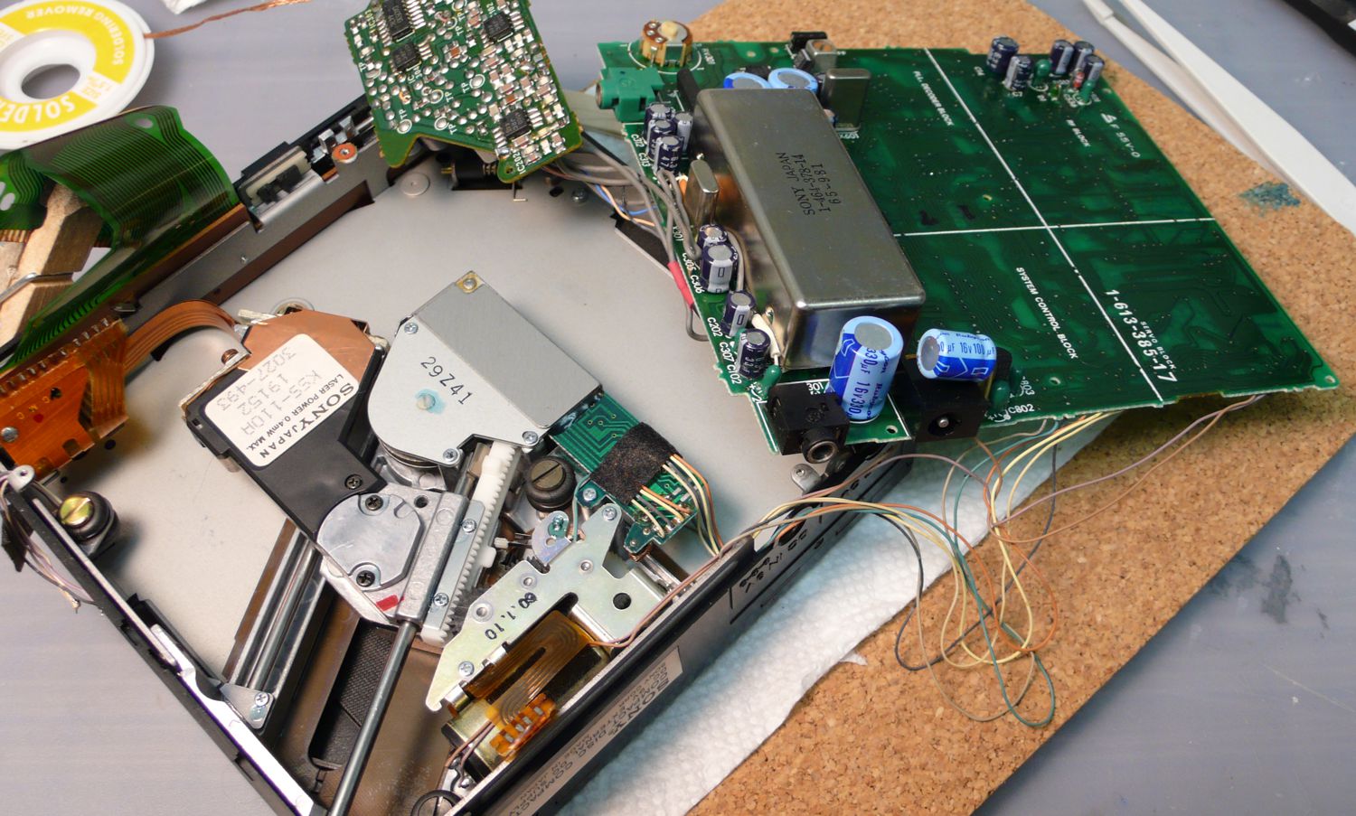

    here is my D-50 opened up for recap, re-calibration and cleaning:
    Looks very neat and considering that this is the first Discman ever made, quite easy to work on. Unlike later D-50 MkII and D-100 where things get nasty
