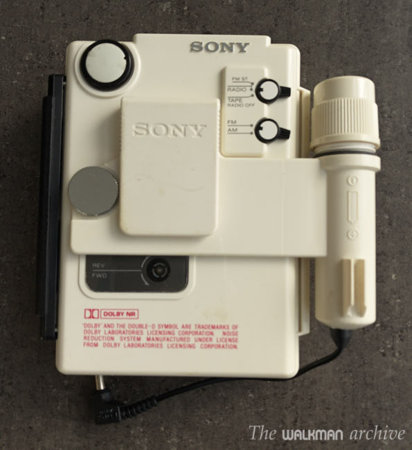

    After trying with some of my beloved walkmans, I tried with this. As you can see, it fade intro a very ugly brown-yellow (call it how you wish):
    I applied this treatment to the upper part, and here's the result:

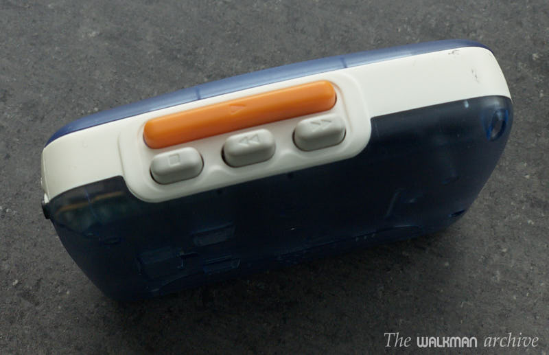

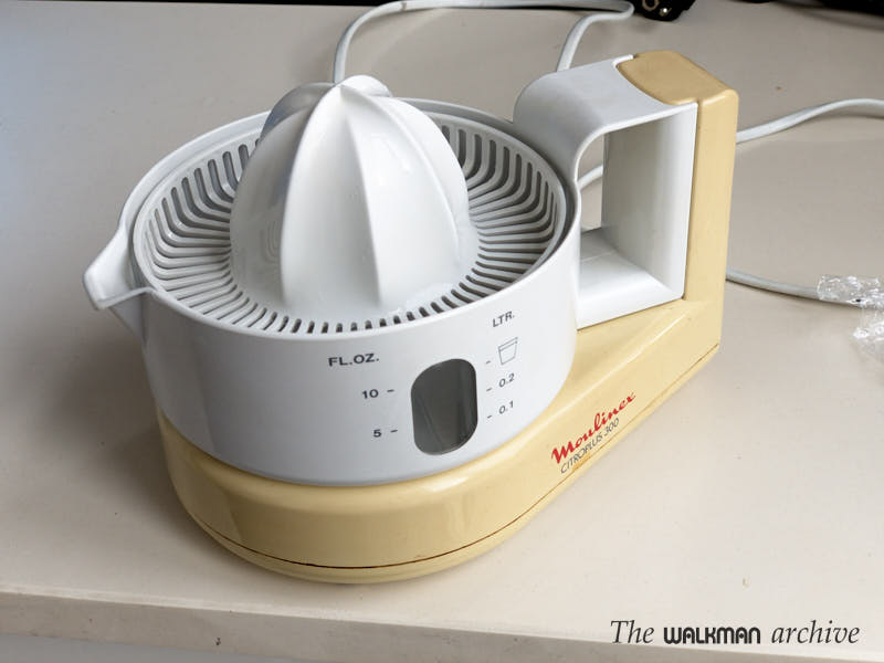

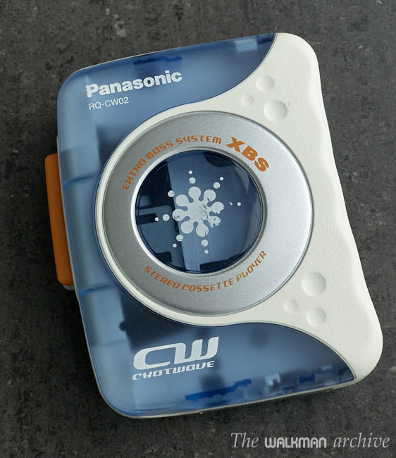

    I was very surprised with the result. So I moved one and tried with my smaller kid's walkman, a very simple Panasonic:

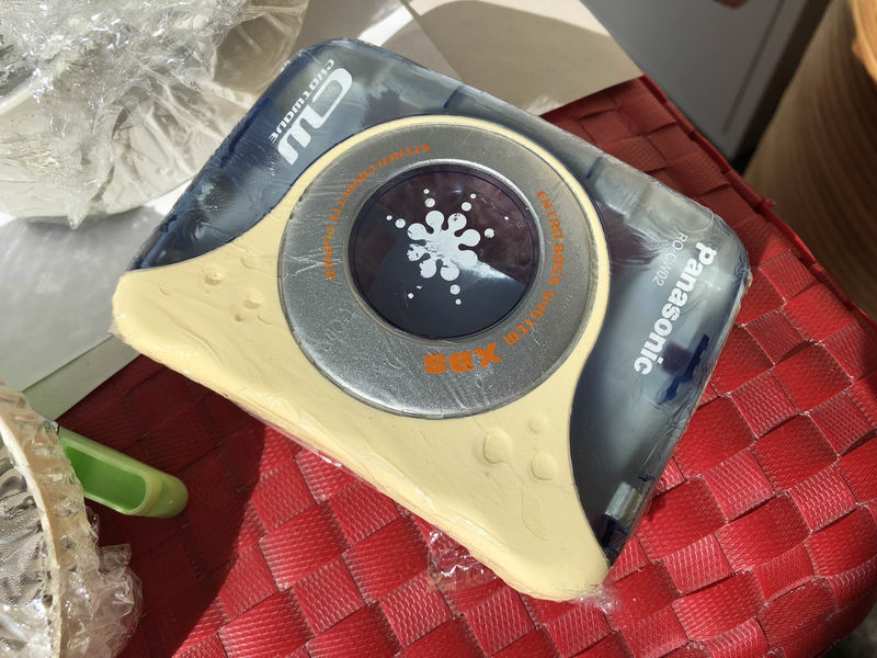

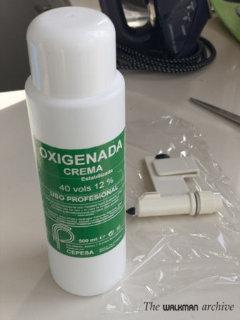

    What you need is hydrogen peroxide cream like this:

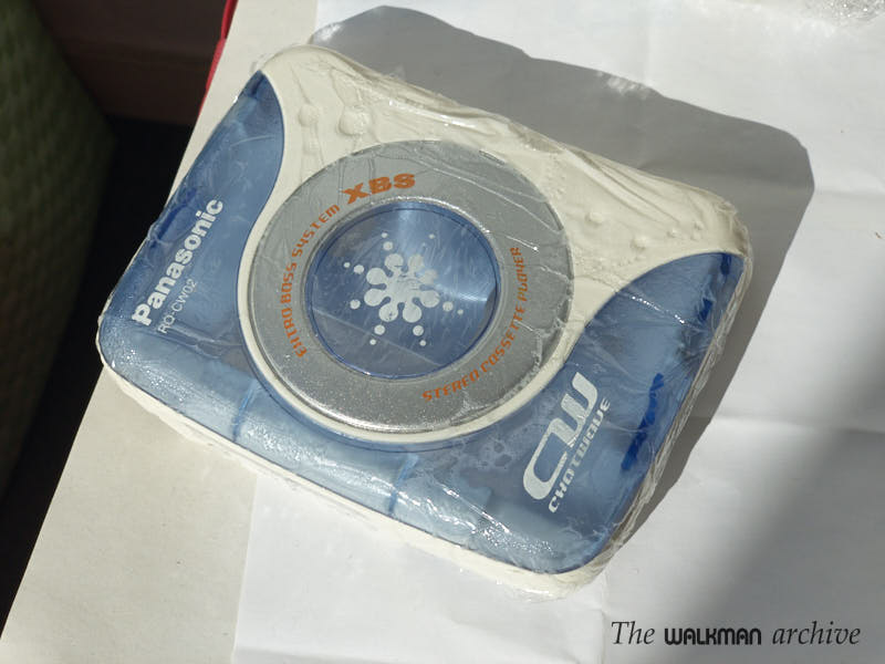

    You have to cover it with cream, with your hands. Then cover it with a thin plastic film and let it under direct sunlight for some hours. For this I dissasembled it, removed the mechanics and electronics:
    Finally, remove the plastic film and clean with water. After assembling, this is the result:
    So, yeah it works!!

    Wow, the result is significant. It's a great way to revive electronic items made of plastic. But where can I buy this Oxigenada cream? What does this product use for originally?

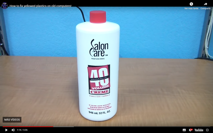

    In english is hydrogen peroxide cream, while in spanish is "agua oxigenada". H2O2 in chemical language. I bought it in a professional hair products store. I think it's used to apply coloration to the hair.
    Take a look at this and you'll see the process. He uses UV light but direct sunlight is totally enough. I've used sunlight.

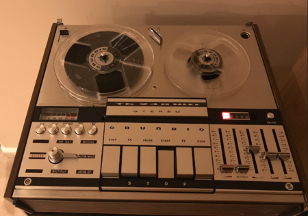

    I've used this method for some years now on anything from vintage Lego bricks (transparent or white), to walkman gears, reel-to-reel reels and cases, or even full case enclosures / computer parts.
    My favorite is Salon Care™ 40% volume, the red one in the video you posted. It's mild and there are no side effects I could detect. A big ziplock bag and a brush is all you need.
    The reels and cases in the pictures below were all treated and look really, like new.
