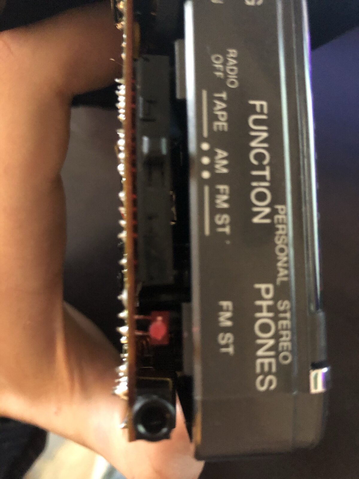

    I got this Walkman for a couple bucks about a week ago at a yard sale.. it was pretty dirty and the last owner had left the batteries in it for too long so there was battery acid all over it. That was a pretty easy fix, just ended up taking it apart (which is a lot easier when it's actually held together with screws instead of the little plastic clips that Sony uses) and cleaning off the corrosion off the springs and wiping off all the gunk from the batteries. It works now, but I've run into an issue where it only plays out of one ear unless I tilt the headphone jack a certain way. Is there any way to fix this? Would I need to get a new headphone jack for it, or maybe it just needs to be cleaned out? Any help would be appreciated, as I'm not super experienced with this kind of thing.
    (also on a side note, does anyone know how to get the gunk off of the front of the device? I hate paper based stickers with a fiery passion)
    Thanks!

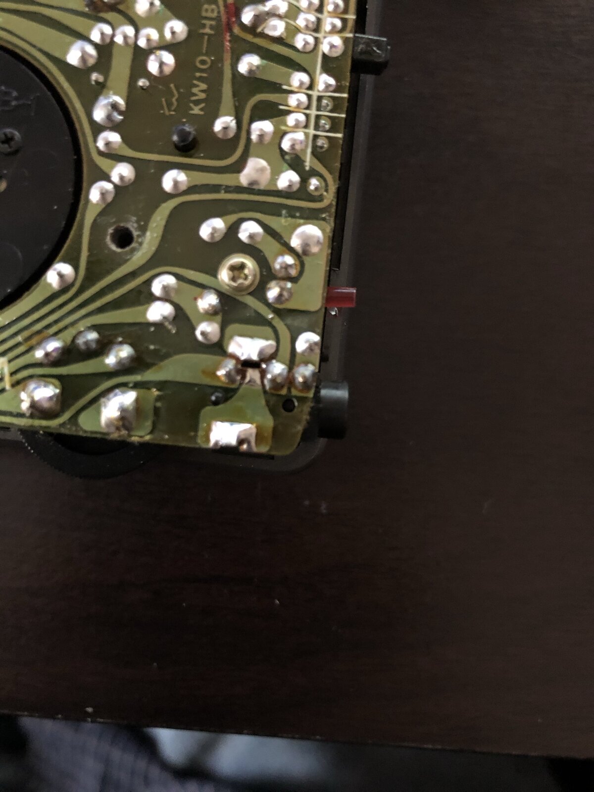

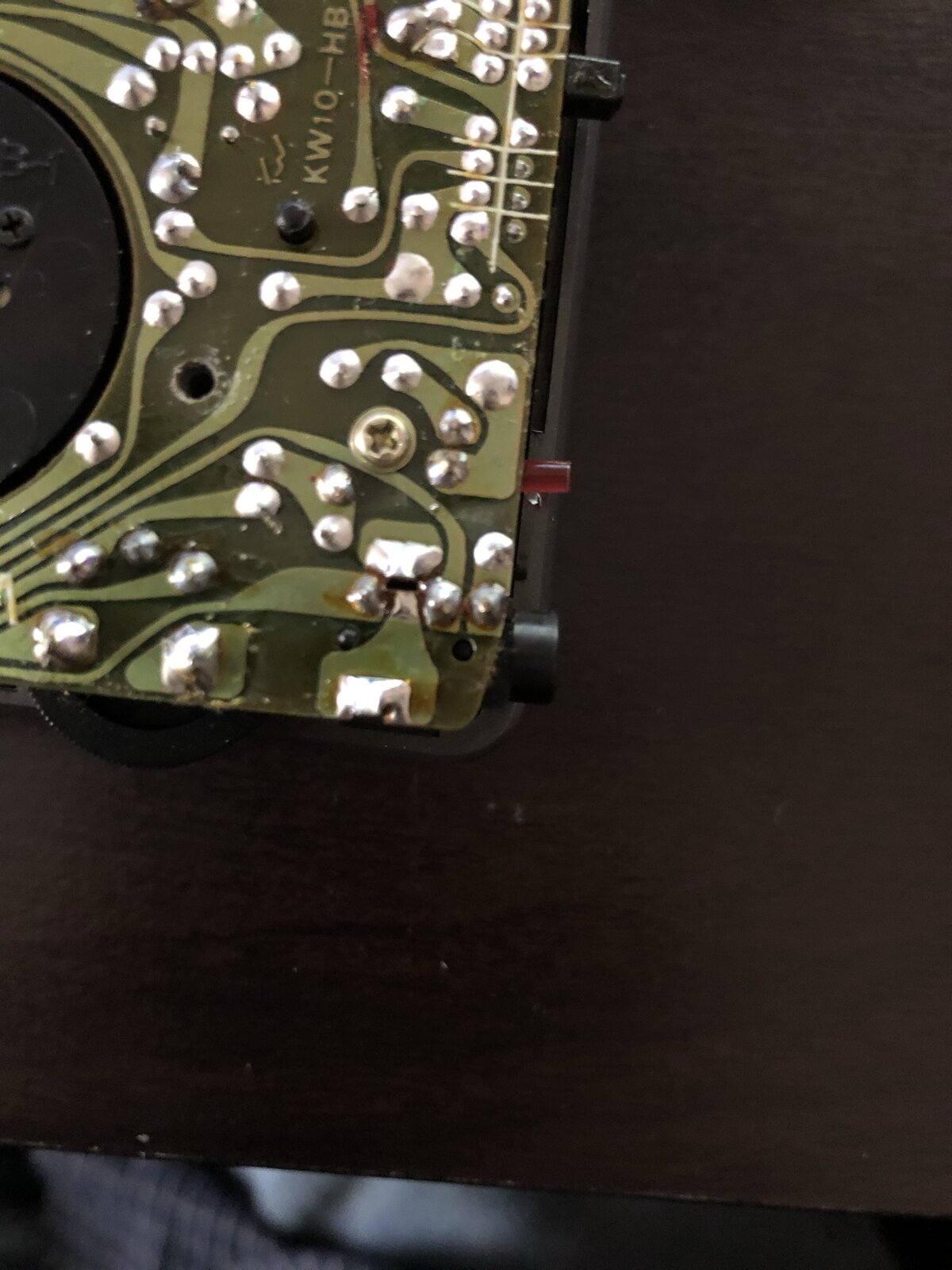

    I opened the case back up and I tried taking the main chip part out but one of the screws was stripped, so I'm not able to take it apart all the way. I've never soldered before, so I don't really know what I'm looking for but maybe this helps? I dunno how I'm going to get the screw out but I'll look it up.

    This is a great unit to learn on, it looks like the solder cracked at the headphone jack which is very common, years of pulling headphones on and off and hitting objects puts a lot of stress in this area. I'd get a TS100 soldering iron on Amazon and work on your skills.

    If the problem is the cracked joint, there may be no need to unscrew anything. You can just remelt the existing solder using a soldering iron, though it may be better to remove the old solder and add fresh one instead,
    Not quite clear, it looks like it may be cracked on the leftmost pin of the headphone socket. A cracked joint will look like this http://www.discovercircuits.com/dc-mag/Issue_11/pg-3.htm
