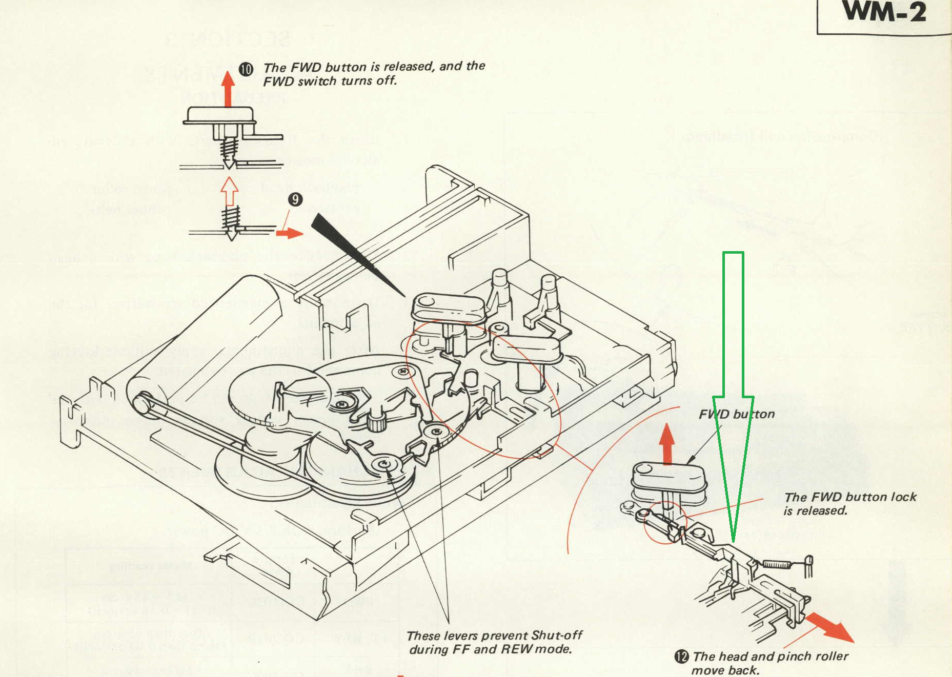

    See if this part (green arrow) is functioning properly , it's a bit tricky to configure. If you don't have the service manual , here.

    Ok, i took the cassette lid off to take a look at the part no:369 LEVER ASSY, FWD in the manual,

    Thank you Machaneus for the pic,it will help later on.

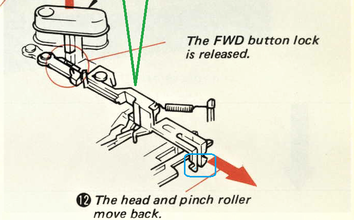

    I can't open my WM-2 right now to take some pics but from memory a point that is easy to overlook is that the lever assy at its bottom side (looks like a double hook) clips to the chassis (see picture below , blue frame ) , hope this might help.

    If you look at above @Machaneus picture of lever assy , Those hooks pulls the head and capstan down to engage it when you push play button
