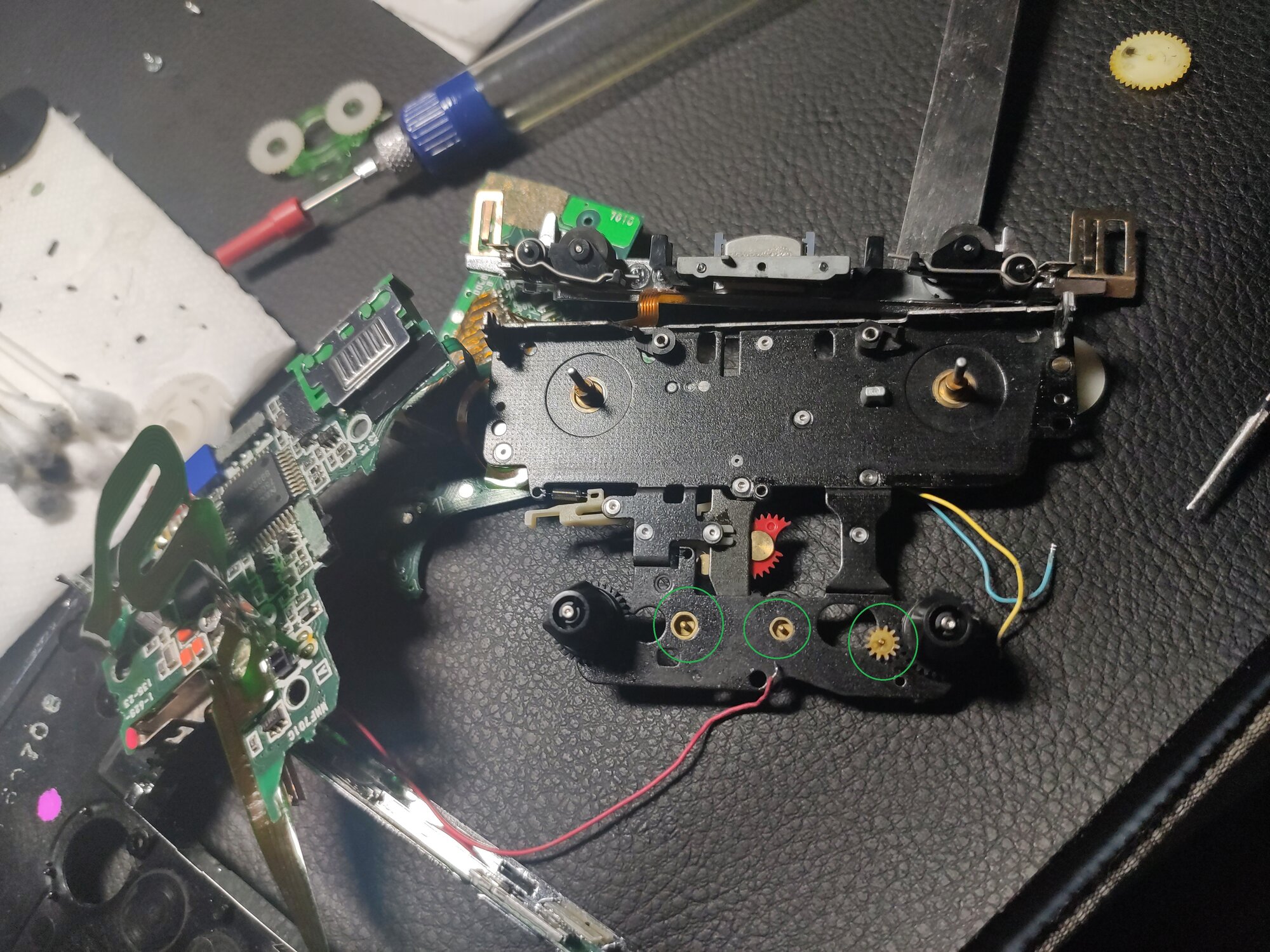

    There are 2 main problems that need to be solved on your unit:
    - checking if the table reels rotate freely: you should be able to rotate them easily by hand without significant resistance;
    If that is not the case, the gears below (see picture attached) need to be cleaned of old grease and re-lubricated with oil.
    It's a very common problem on these units, so don't try to use it without solving this as the gears may break.

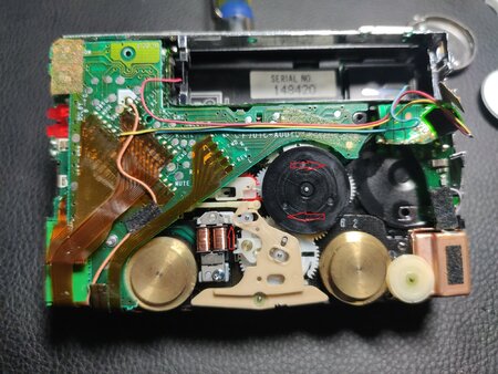

    You need to engage the solenoid with a pair of tweezers and then rotate the middle pulley clockwise. See picture attached.
    But first I would check if the mechanism is really latched. That's simple to check, you only need to see if one of the pinch rollers is engaged.
    Remove the belt and rotate the flywheels by hand. Do they rotate freely or one has resistance ?
    I recommend only removing the metal top plate (it's soldered on 2 points), not removing the entire buttons PCB as that's unnecessary.

    Valentin, thanks for the description and picture. A funny thing happened because before I saw your reply I must have moved or disturbed something and now it appears that all the transport/play/stop/reverse functions are working ok without even cleaning it, and also the button to switch the radio off etc are working correctly.

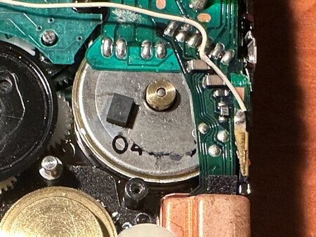

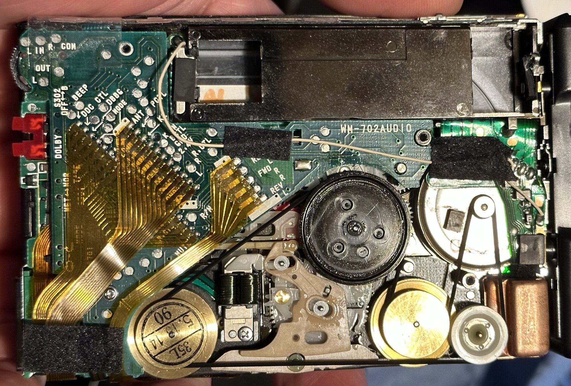

    I was looking at the back of the motor and realise I need to remove a ribbon cable from over it at the very least, or maybe remove the whole thing.
    I have looked at the guide for dismantling the motor itself and lubricating it, which is very useful thankyou Valentin, but I need to look further for any info online that shows either removal of the motor itself from the player/chassis, or just the cable if that's the only access I need at the top of it possibly. From the guide though it looks like removing it entirely is the best option.
    I have looked on youtube and google for any existing guides on doing that on these kind of model range but not found an example, so I will have to just figure it out and go very slowly and carefully, with lots of photos so I don't end up with something being a mystery for where and how it goes back again! Fingers crossed that I'll be able to do this correctly without any mistakes. I like taking things apart but I'm very aware these things are very delicate and intricate.
  10. Valentin
    1,667
    There is no guide online about this, I'm pretty sure of it.
    You do need to remove the motor from the chassis. There are 2 ribbon cables that need to be desoldered: the DC-DC converter and the motor one.
    You also need to remove the 3 wires (take a picture before) that go to these flex cables.
    After the solder points are desoldered, the flex that goes to the DC-DC converter (below the motor) must be lifted together with the outer DC terminal (can be lifter with a pair of tweezers).
    Motor itself is held by 2 screws in the cassette compartment.
    In fact you can see in my previous post #6 that the motor is removed. If you need additional pictures explaining it, let me know, but I think it is pretty straight-forward to do.

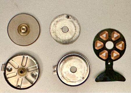

    I was a little confused about the three wires you described until I realised my Walkman is different to your photo for some reason, and only actually has one of them! You will see in the photo.
    I’ve successfully removed the motor now anyway thanks. I think I was of the mistaken impression that this motor type just opens up without removing glue, but that doesn’t seem to be the case as it does appear to be glued closed. *Edit* Just realised your guide does specifically include my model and does indeed say about removing the glue for this type, so I must have completely imagined any other way for this walkman.
    I will carefully work through removing that as per the tutorial anyway (thankyou again!) and see how I get on.

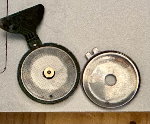

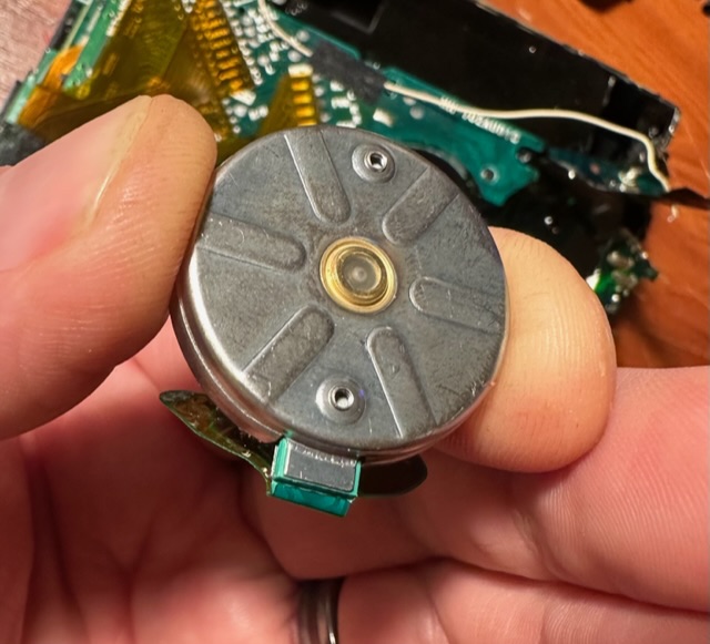

    Here are the pics so far… IMG_7579.jpeg IMG_7585.jpeg IMG_7587.jpeg IMG_7590.jpeg

  12. Jimbob
    Jimbob Member
    32
    Uk
    Ok managed to get that apart seemingly without any damage (and amazingly didn’t slash my fingers to bits!), so I need to call it a night for today as it’s too late, but I thought it interesting to note discolouration inside the lid of the motor can, and on the top disc that sits beneath it.
    I assume that’s from heat or contact between them, but hopefully doesn’t indicate it’s in a really bad condition otherwise.
    Anyway, tomorrow after work I will oil/grease it as per the tutorial then reassemble and hope it’s better after that!

  14. Valentin
    1,667
    It's my mistake, I recently fixed WM-701Cs/F701Cs (so this is what I had in mind) which now I realise have a different type of motor than the WM-702/F702.
    The 701C motor is held with one screw, while the 702 is glued as it's shown in the tutorial. In fact the pictures used in the tutorial are from a WM-702.
    Think this also explains the difference with 1 wire vs 3 wires: the 702 has only 1 wire while the 701 has 3. The picture I uploaded is from an F701C (can be seen on PCB silkscreen).
    In the big picture of things, it's not really a big deal as even the glued one is pretty straight-forward to disassemble as only the top metal cover is glued.
    The WM-EX series motors are significantly more tricky to open in comparison, as on those the very thin PCB (with coils formed by traces) is glued on the edges.
    About the discoloration, if it's just discoloration ignore it. But inspect carefully and make sure the 2 parts are not actually touching each other.
    If there are scratch marks it means they're rubbing, but from the picture it looks like just discoloration.
    Clean everything well: bushing, motor shaft, rotor, metal disc, coils plate, case. Then re-lube and assemble back.
    Turn it by hand and make sure there is no metal to metal contact before glueing the top back.

    Thanks Valentin, yes the discolouration ended up removing easily with a cotton bud and some IPA, and the bud was pretty dirty afterwards. I was surprised because the marks had that discoloured look you get when metal is hot, but I guess it wasn't that since that sort of heat mark does not usually come off with a gentle clean.
    So the motor is lubed and reassembled now, and soldered back in place. Happy to report that it is now way more quiet thankfully, so that has really been worthwhile.
