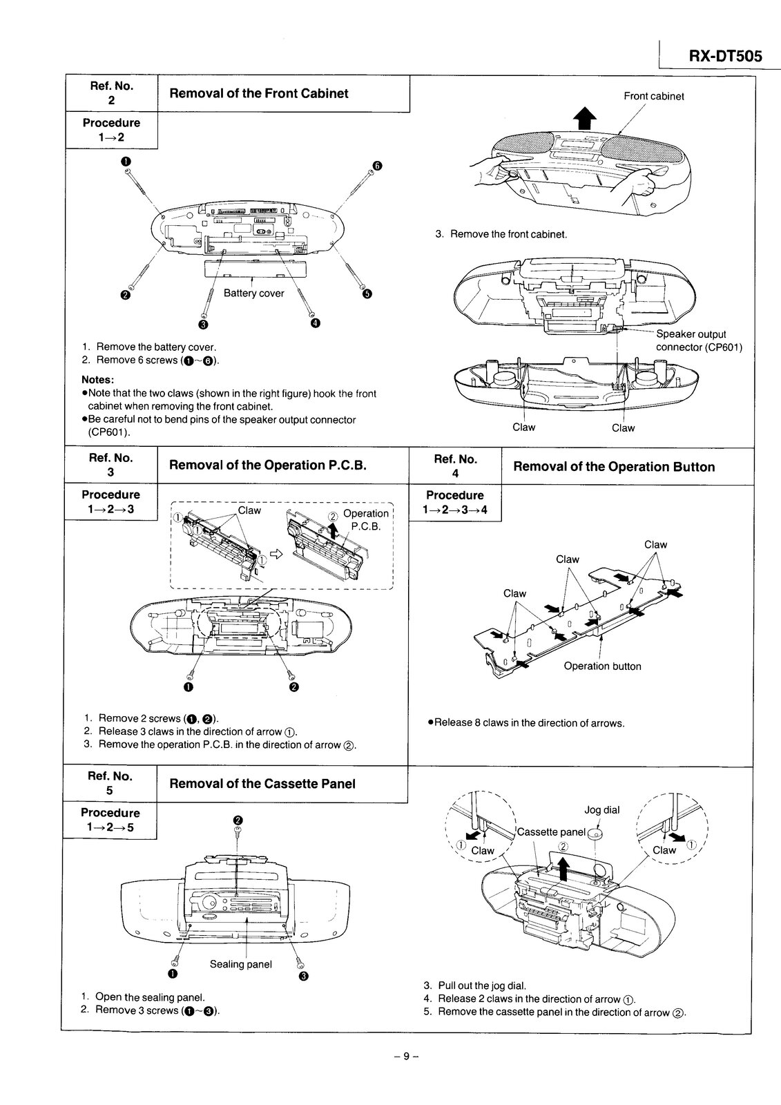

    Hello. I know this thread is already old, but I don't seem to find any better place where to post my request for help.
    I need to open my RX-DT505. I follow the instructions in the service manual and I remove the six indicated screws from the back side. Nothing else is said to be done in order to remove the front cabinet. But I can't. Something is still preventing me from removing it. Can you help me with possible causes? Thanks in advance. Regards.
    (I forgot to say that I have previously removed the handle. Just in case......)

  9. kanamaster
    kanamaster Member
    64
    Germany
    .- I had already tried by opening the cassette doors. Didn't work.
    .- Not tried the second suggestion. I will try it. But because of the design of the whole thing, I don't think this could be the cause.

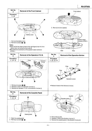

    I post here a copy of the page of the service manual, where you can see the instructions for removing the front cabinet. Only six screws.
    Thanks a lot for your ideas. Maybe some more come.
  10. kanamaster
    kanamaster Member
    64
    Germany
    By the way, if those two claws appearing on the instructions page are the cause of me not being able to remove the front cabinet, I can't even see them.
  11. kanamaster
    kanamaster Member
    64
    Germany
    @Longman -- Definitely nothing to do with the trim or the whole CD unit in order to open the fron cabinet.
    Thanks for your suggestions.
    Really hoping that others who might have opened this kind of unit also bring ideas.
  12. Radio Raheem
    1,961
    you need to pull very firmly these do not just fall apart with the screws out...
    also verify there are no more screws....forget the manual for the moment
    have done loads of these but not this one
    do you have any experience working on these my friend....if not i suggest you leave well alone bud

    I finally found a video (maybe the only one on the whole internet) that shows the opening of the front cabinet of a RX-DT505. It has japanese subtitles. I could understand the subtitles using the translator of my smartphone. I post the link of the video here so yo (and maybe others) can see that there are only six screws to remove on the back side.
    Code:
    https://www.youtube.com/watch?v=Le6FiqQhNek
    Going back to the manual (which you suggest me to forget about for the moment)...... If you take a look at the page I posted before they mention two "claws". I also mentioned them before. The problem is that I cannot find where those two claws are, although they show them in the diagram. But it is not clear to me at all. Maybe with your experience you can guide me to find where those two claws are. In the japanese video I can't see them either.
    Thanks a lot and kind regards.
    16,845
    Those "claws" can be really strong, sometimes they break. I'm wondering if there's a hole somewhere to get a long tiny screwdriver in to push them down. Otherwise you'll have to force it somewhere, maybe using something like the plastic tools they use on car trim so you don't scratch up the case.
