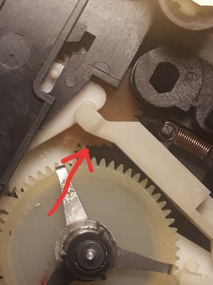

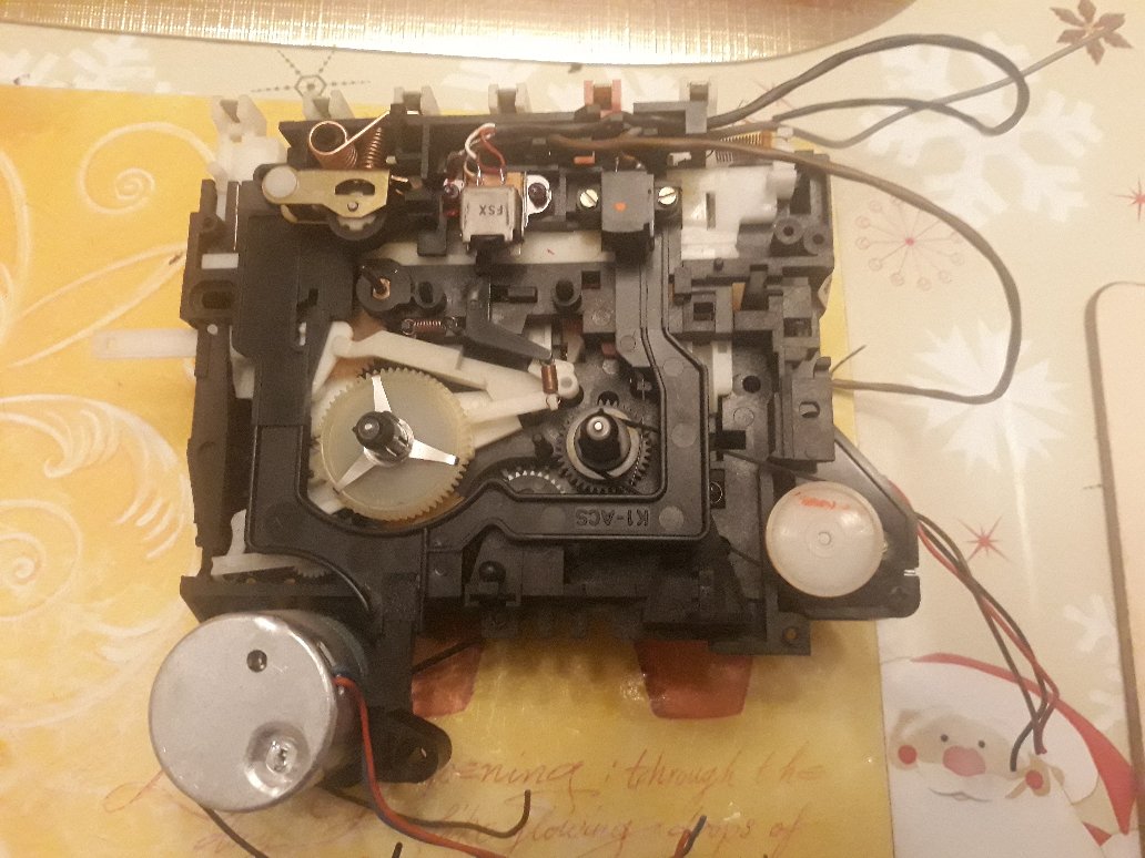

    Hi all, recently got a neglected non working Philips D8814 "Elephant". i have got, it now basically working, good radio and Phono and Aux. Best sounding unit i have ever come across.
    i have a problem with cassette unit however and it seems to be quite common with Philips units in that one small beige coloured gear is basically disintegrating.
    i have removed the cassette unit and identified the problem and i intend to either make from scratch or mod a similar gear.
    the problem is that even with the service manual, i simply cannot work out how to remove this gear. i cannot work out how to disassemble.
    anyone with experience of this or any useful advice would be appreciated.
    many thanks
    Brian

  10. stagdriver
    stagdriver New Member
    5
    united kingdom
    Thought it was time to finish this thread.
    i attach a pdf of the disassembly procedure and a brief how i made the replacement gears. If its any use to anyone else.

  13. stagdriver
    5
    united kingdom
    yes, i have since found a few other units from different manufacturers with similar gearing. it does seem possible that some of these gears were in fact made from a soft PU deliberately as nylon gears were noisy as i have found in my Philips unit where i made a replacement gear from machinable hard nylon. you can hear it as it generates quite a bit of noise.
