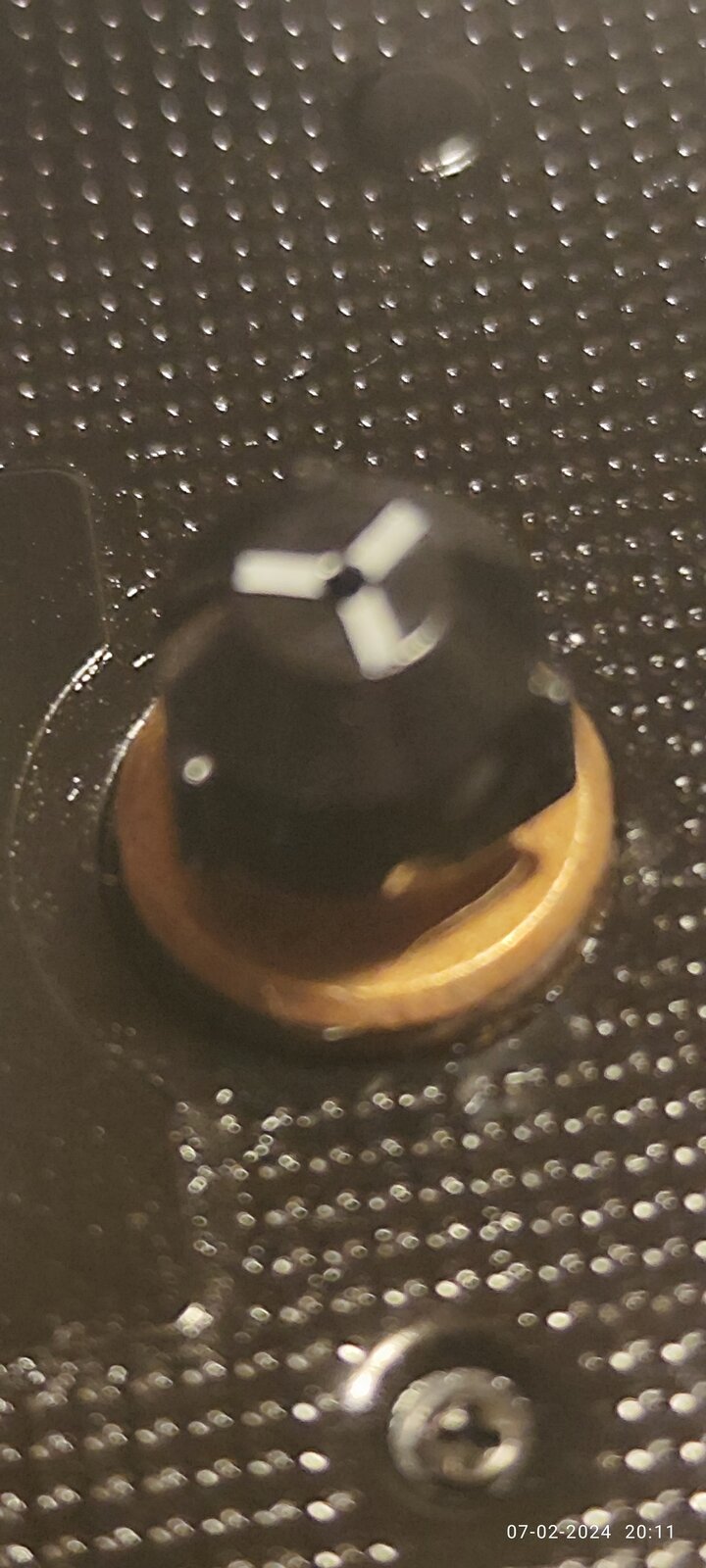

    Dear Valentin, thank you for your kind answer!! I understanding what you are saying, but do not know how... Must i dismantle something on the table reel ( cassette side)? Pic 1

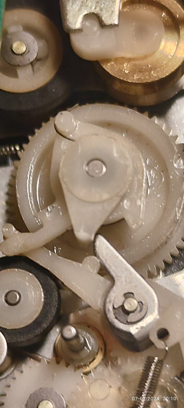

    And how to get to the shaft on the inside? Pic 2 IMG_20240207_201116.jpg IMG_20240207_201050.jpg

    You get a piece of cotton, immerse it in alcohol and get it between the reel and brass bushing (this is in the casssette compartment).
    For the other side, you need to get the piece of cotton underneath the white gear.

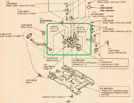

    1. Remove the entire reel assembly highlighted in attached picture. It's held in by 3 screws. This will give significantly more access to the bottom part of the bearing.
    2. Use a sewing thread instead of cotton, as this will make things much easier with the assembly in place.
    When I did this process, I opted for 1. The second option will likely also work, but it will be a bit more problematic to oil be bearing after cleaning.
