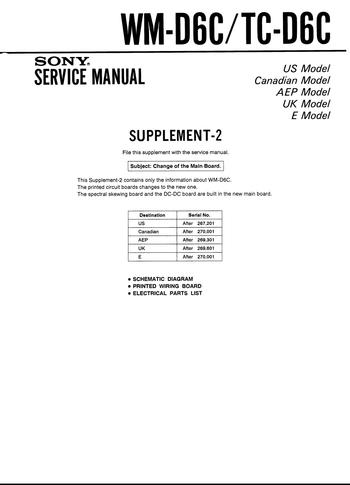

    I have attached the front sheet of the D6C Service Manual supplement which gives the serial numbers for the introduction of the SMD main board in various regions of the world. Rather surprisingly for such a major revision, the supplement doesn't appear to have a date on it.

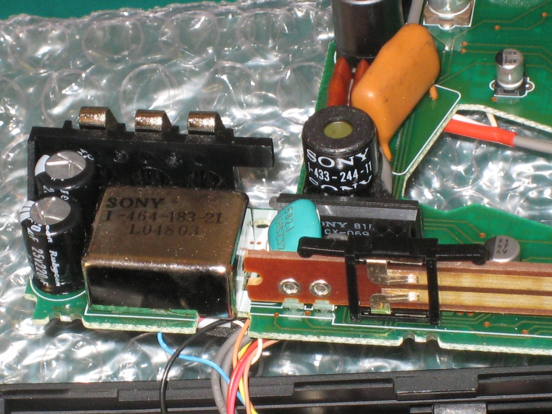

    The last major revision of the D6C took place in June 2001. The motor servo circuit was changed to use the older CX069A chip, which had been used on the TC-D5 recorders in the late 1970s, instead of the CX20084. I suspect that this was due to a high failure rate, either in production test or during the warranty period, of CX20084 chips.
    The CX069A D6Cs are very rare as they were only produced for around a year before Sony stopped producing the D6C in 2002. I have only ever seen one of these. The manual supplement doesn't give a serial number when the change took place but serial number of the one I worked on was a six figure number starting with "518".
