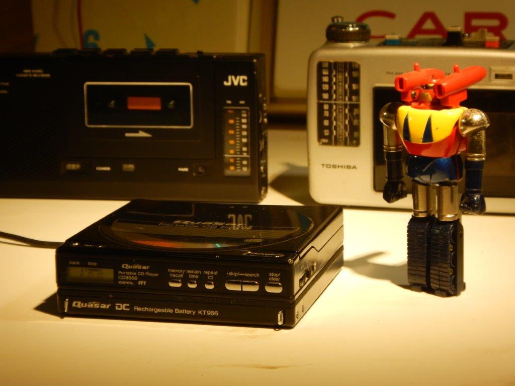

    It took me a little while to figure out we had two CD threads but this is the right one and I've got one Kent doesn't have, or maybe just not posted. I've been talking for years about never having a Technics old-school square portable CD player. There's something about the first generation that just looks like they were high-end, before they morphed into plastic egg mass-marketed players.
    Today I was at my favorite record/equipment store Go Johnny Go, and he had a Quasar Portable CD Player on the shelf. 99.9% of the time I would have left it without think twice but I picked it up and holy-cow, it is a solid metal brick, with a snap on rechargable battery. The quality seemed great for Quasar so I grabbed it along with a ton of other great equipment, including a JVC RC-S55JW (more on this later).
    After a little research on this pretty much non-existant player, I figured out it was a different version of the Technics Player, the lid and buttons are different but everything else is identical. I'm not sure what version since the early ones look very similar but it makes sense since they were made by the same parent company.
    It works great (skips alot, just like I remember) but the battery is dead, most likely not repairable unless someone has some ideas. It weighs a ton, very heavy and solid, not something you want on your waist when your jogging.

    This Quasar looks like a direct copy/rebranded Panasonic SL-NP10. Once I find a copy of its Service Manual, or get hold of the Discman itself, I will update my never-ending list of PCDPs Components and we shall see how it compares to its "hi-end brother" Technics SL-XP5... According to kaosuncd.com, internally they are the same.

    That's it, the smaller LCD matches perfectly along with all the buttons and power cord. How does it rank in the world of first generation portables?
  16. Jorge
    1,772
    If it is a copy of Technics SL-XP5, and I have no reasons not to trust Kaosun on this, then this is one of the best-sounding Discmans EVER!!!
    PCM55 for DAC :) but unlike my all-time favorite Sony D-50 MkII it also has digital filter to smooth out the edges. Headphone amp puts out 30mW into 32Ohm... only D-50MkII, D-100, and my beloved Loewe CD100 had so much power!

    Forgot to ask: skips in a stationary position or on the move?
    Again, so great looking machine! :thumbsup:
    17,151
    Thanks Mystic Traveller! It just skips when it's moved, on the desk it sounds fine. My memory of any portable CD player before 92 was that they skipped, but I usually saw the lower end machines.
