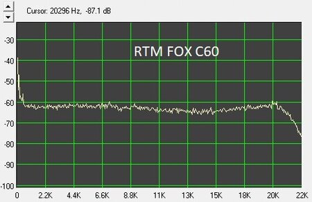

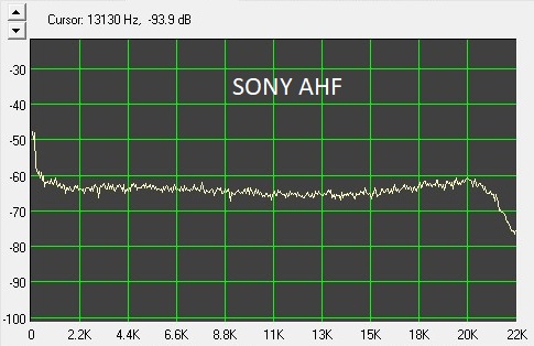

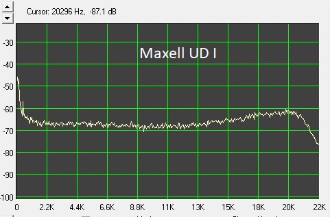

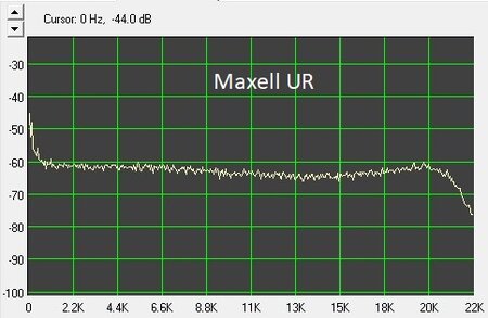

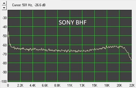

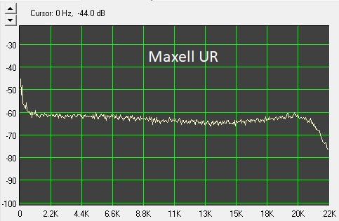

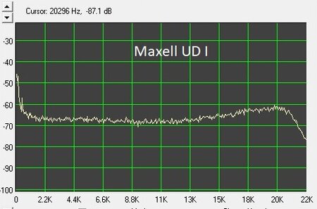

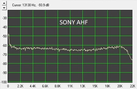

    @brunophilipe You motivated me to do some comparisons between the FOX and a few other NOS TYPE Is.
    The initial subjective impression on the RTM FOX C60 was very good, however objective measurements would indicate it's pretty close to the latest Maxell UR (which although good, is nothing spectacular in my opinion).
    The initial good impression probably came from the fact that I took as a reference a UR that was recorded with levels a bit too low (and hence the hiss seemed to be higher than the FOX).
    The pictures below represent relative noise floor measurements between the 5 cassettes. It can be seen that both SONY AHF/BHF and the Maxell UD I (which is cobalt doped TYPE I and one of the best TYPE I that I have seen) perform significantly better in terms of noise.
    The MOL of the SONY AHF is significantly better (at about +6dB) compared to the other ones (at about +3dB). The MOL of the FOX is also at about +3dB.
    What I like about the RTM FOX:
    - freshly made, so potential storage environment problems are non-existent;
    - a good quality tape, which doesn't seem to shed any significant amount of oxide;
    - doesn't have any dropouts, even at the beginning of the tape;
    - a decent noise floor: can be used without Dolby, but it would benefit from Dolby when recording music with quiet passages;
    What I don't like about the RTM FOX:
    - the performance of the tape itself is nothing to catch attention, having similar MOL and noise floor to the Maxell UR;
    - the price is pretty high for a newly made tape; I bought sealed Maxell UD Is at a similar price a couple of months ago;
    - the shell of the cassette is very basic and feels cheap; can't not compare it with the UD I that looks and feels way better;
    NOTE: The Maxell UD I tested is the one from 1991-1992 (with transparent oval window).
