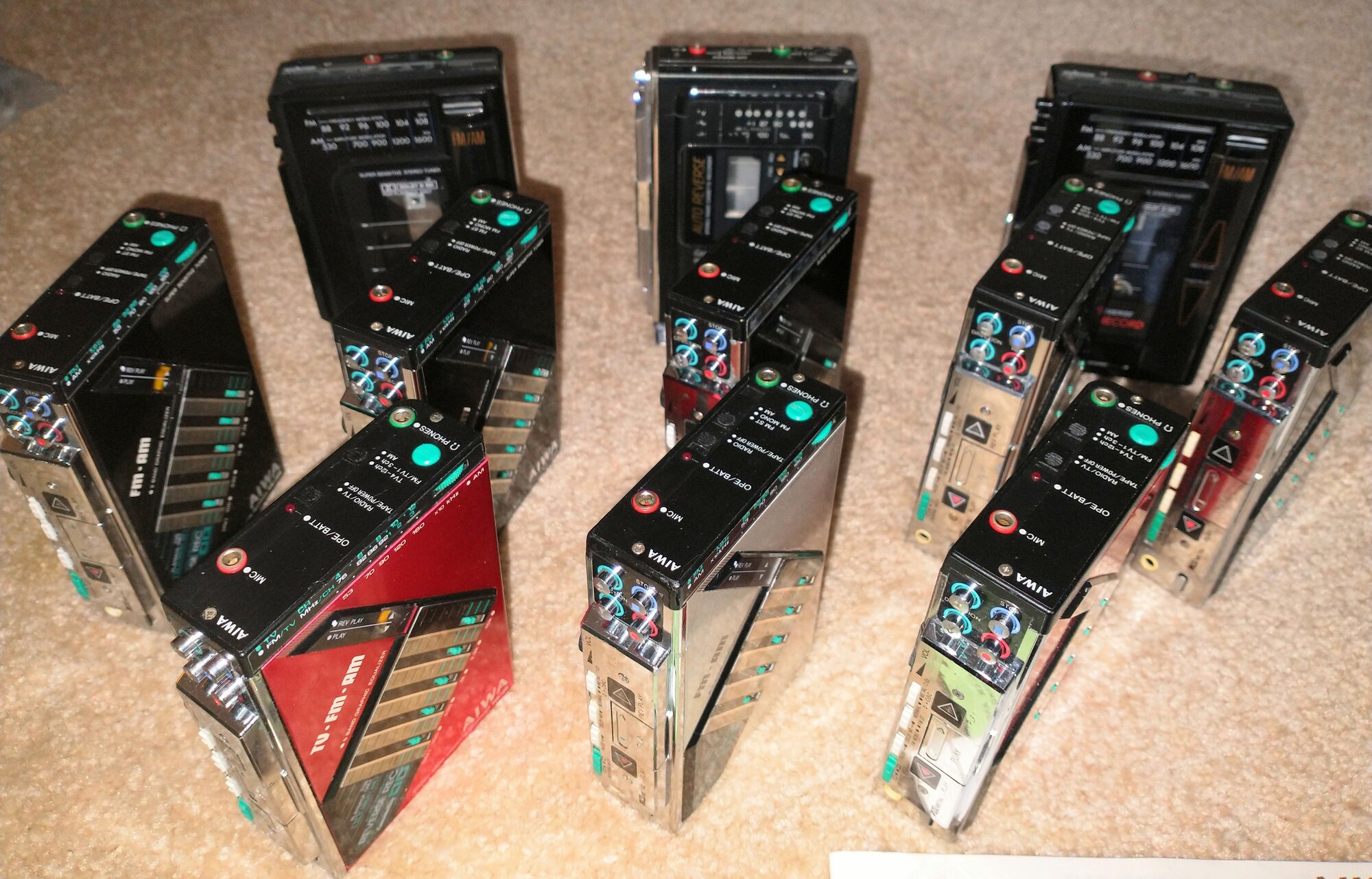

    I've worked on nine Aiwa HS-J9, J09 and J600 (which are the same except for TV audio reception on the J9), plus one each of J36, J360 and J10. They were bought as medium to worst condition units. I don't buy nice or costly ones.
    These have very similar electronics and all use the Aiwa 2ME-7 mechanism. To help people doing searches find this thread, I'll include an imperfect list of the players I think use this mechanism.
    My use of condition designations is that units that can play cassettes at a basic level are "repaired" or "working". I use "refurbished" for units that have all the parts and all the functions basically work. But not necessarily perfectly. Some cosmetic parts may be reproductions or non-standard (such as screws). The units I work on have some improvements over the original build.
    To me, "restored" means having all OEM parts and functioning to at least original quality, which requires instrumented calibration. If they are also in perfect cosmetic condition I think they are called "museum quality". I don't consider my own work to be restoration.

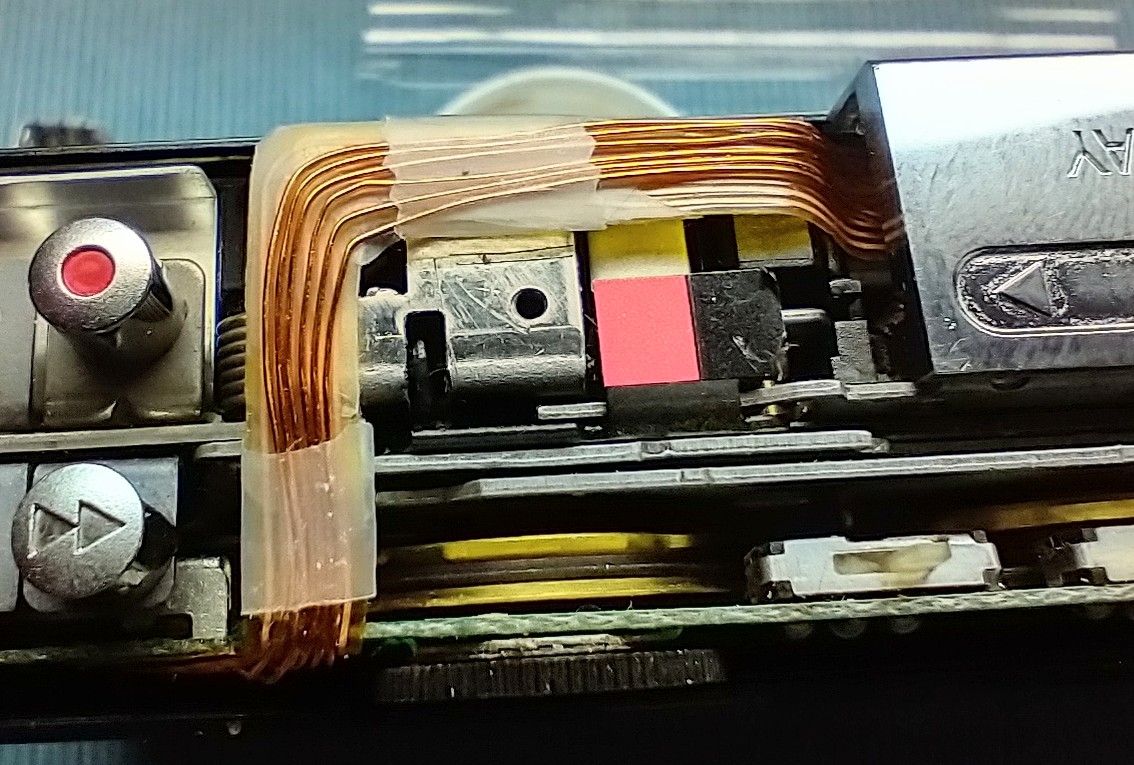

    The risk of tearing the cables can be reduced by reinforcing them with strong tape while you work. Manipulating the parts can also cause breaks at the cable terminals. These can be hard to find.

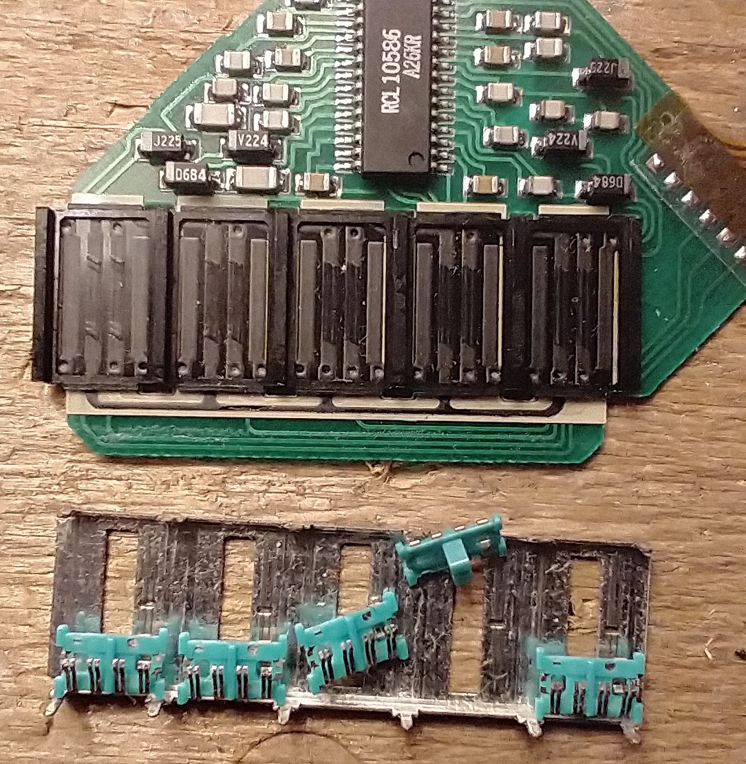

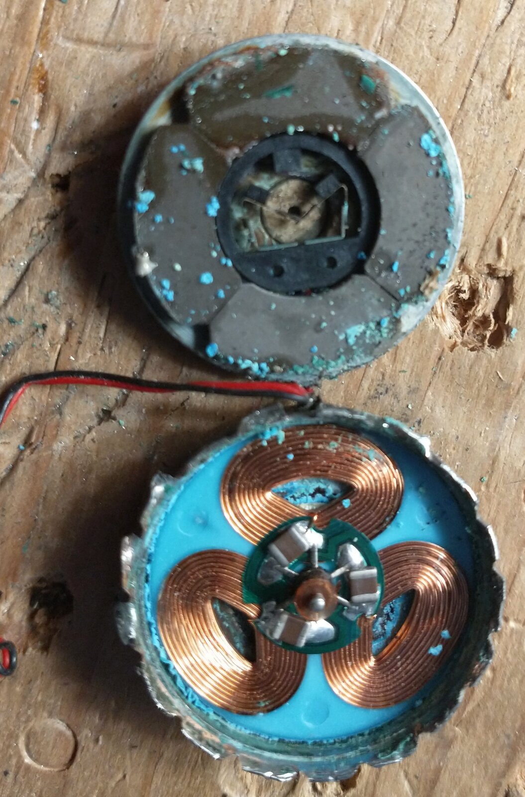

    1. Equalizer
    A bad equalizer can prevent both radio and tape audio or one channel, or, with some sliders in some positions, some audio.
    I think a bad equalizer could be bypassed by shorting the right and left channels at the main board connection for the equalizer flat ribbon cables. But I don't know if there are risks besides obviously losing the equalizer function, and I have not done this.
    The 12 metal tabs holding the equalizer to the equalizer board can be pried straight. The metal shell of the equalizer then comes off, exposing the loose parts underneath. The only electronic component is the graphite traces bonded to the board. These are just potentiometers. The real sound alteration happens in the adjacent IC's.
    Each slider has 4 delicate plastic tabs, and great care has to be taken not to break them. Each slider has 4 metal prongs that rub along the embossed traces, and a 5th prong that only functions to mechanically engage with the holes in the metal shell. This provides a haptic dedent at the neutral position.
    Delicately clean the traces with a swab wetted with isopropyl alcohol. Don't rub hard enough to remove trace material. I've had mixed success doing this, restoring function in some cases and not at all in one case.
    I also scrape off the contact points for the 4 active prongs on each slider. If any of the prongs have been flattened, I carefully bend them back so they engage the traces.
    When reassembling make sure the 5th prong engages the holes in the shell, and be very very careful to line up the sliders so no delicate corner tabs get broken off. Broken tabs means the sliders won't track straight.

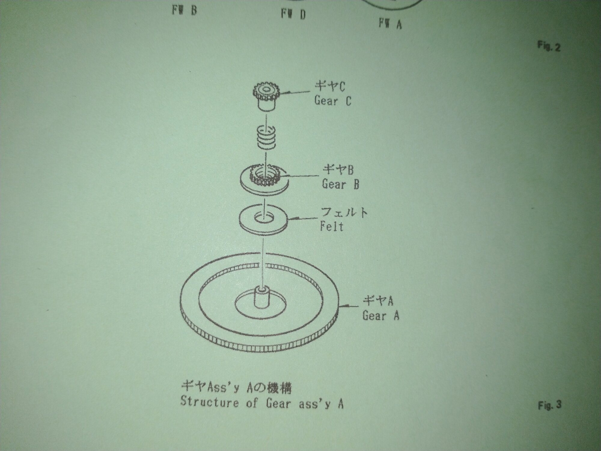

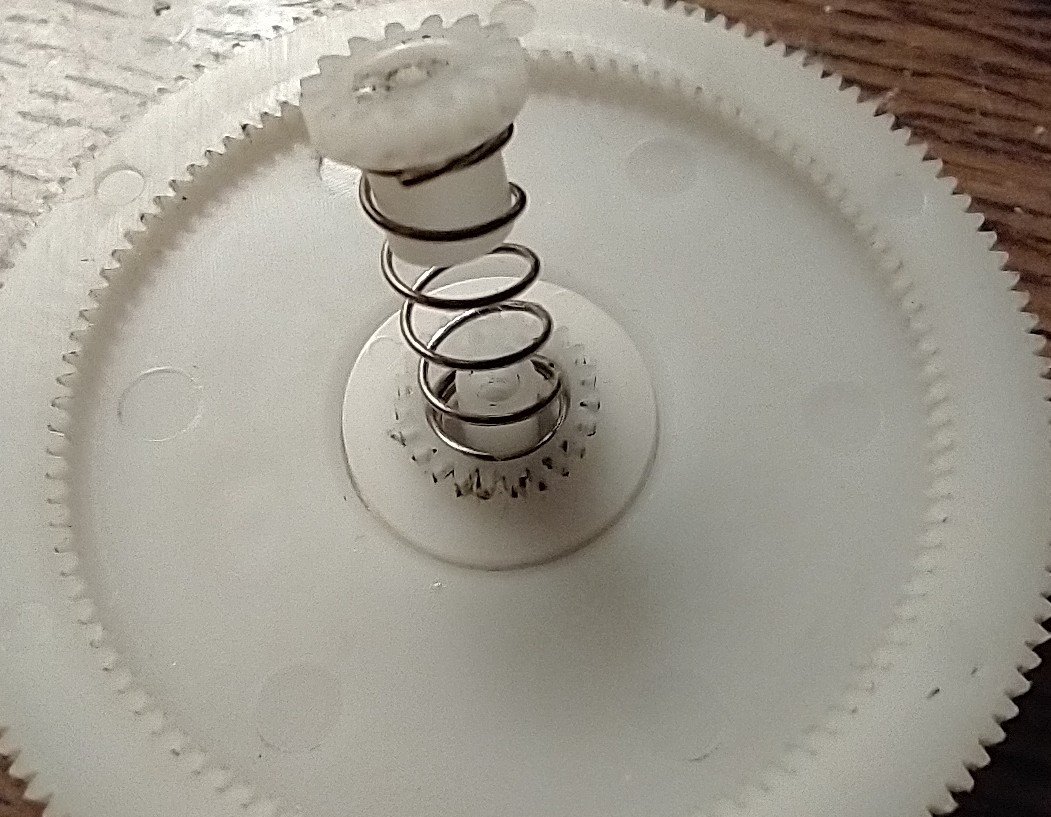

    2. Gear assembly A
    The symptom is that auto reverse doesn't work. Auto reverse failure can also be caused by:
    - dirty leaf switches #7 & 8
    - faulty switches #1 & 2
    - the pivot plate holding the 2 partial gears needing lubrication with respect to the chassis
    - the main board has been attached to the mechanism with switch #1 in the wrong position. This will also cause music to be played backwards.
    This requires removing the main board, the belt and two of the brass pulleys.
    Then you can remove the e-clip holding gear assembly A, visible as the large white gear. Be careful because the assembly should be spring-loaded.
    Gear assembly A has 5 parts. The small gear C must be fixed with respect to large gear A. Gear B can turn independently but with friction from the spring pressing it against the felt washer. I still don't fully understand how this works as a clutch.
    Gear C is fixed to a post on gear A using a very tight press fit. Of course this causes huge tension on the barrel of gear C. And over time, it splits. Auto reverse won't work until it is fixed or replaced. I have heard later units such as the J10/36/360 have an improvement that solved this failure. While I can't see any difference, those 3 have arrived with gear C intact. I did this repair on them anyway.
    There is a YouTube video** of someone fixing gear C on an HS-G600. While I admire their setup and expertise, I don't like their repair. They demonstrate how to glue the crack on gear C. Given the forces present were sufficient to crack intact plastic, I don't see how a glued crack is going to last very long. The first and only time I tried glueing the crack, it failed immediately.
    My method is to carefully scrape down the sides of the post on gear A so that the stress on the barrel of gear C is reduced but not eliminated. I then put the assembly together with the mating surfaces of gear A and C epoxied. I mount the assembly on the spindle with the e-clip to achieve the correct spacing of the components, before the epoxy sets. Apply the glue very sparingly or you will bond gear B to gear A.
    I have had reason to take this apart after the epoxy has fully hardened, and I cracked the gears apart by putting the assembly in a vise and applying pressure. Putting pliers on gear C to rotate it will only cause unfixable damage to the teeth.
    I found one gear A with a long crack. I fixed it with glue, but it was also warped. So it was never going to work 100% and I replaced it with the gear from my donor unit.
    Though very helpful, this video is flawed.
    - the black trim panel inside the cassette bay does not have to be removed for this repair.
    - only the two brass pulleys overlapping gear assembly A need to be removed, not three pulleys.
    - each pulley has a washer on both sides. The rubbing sound the author did not resolve at the end of the video was because he did not have or reinstall all the washers. This would throw off the pulley spacing.
    - as I said earlier, I don't think this repair will last.)

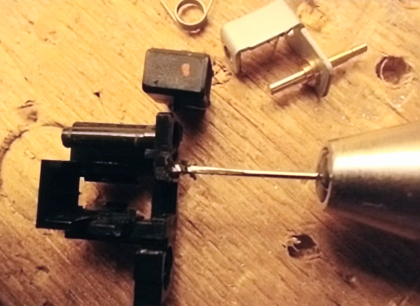

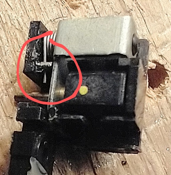

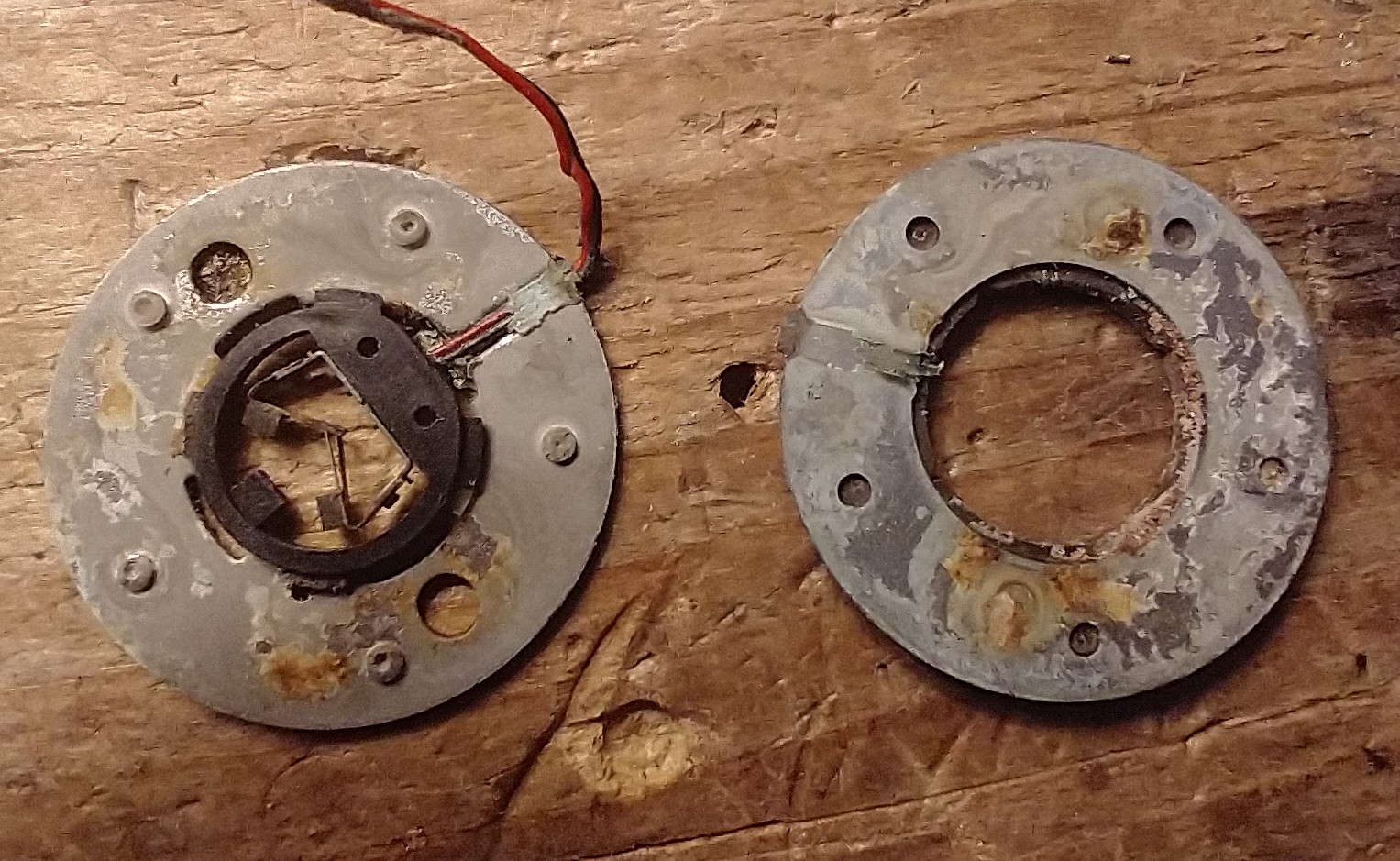

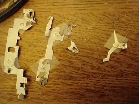

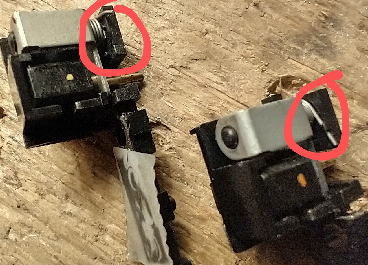

    3. Erase head springs
    The symptom of this is that the Play button jams halfway down. And rewind and fast forward are unreliable. To further diagnose it, remove the chrome control panel. If there are one or two spring ends sticking up near the tape direction indicators, this repair is required. If you see a unit for sale with the Play button halfway down, it has this problem. I buy mid to low condition players, and most of them have this problem. I didn't know what the problem was, and at first just resigned myself to those players having this unrepaired flaw. But after I got a scrap unit, I figured out the problem and how to fix it. I then went back and fixed all the players affected by this.
    This requires removing the main board, the belt, three of the brass pulleys, gear assembly A, much of the mechanism, and the head.
    This took me quite a while the first time, using the 2ME-7 service manual and carefully photographing and documenting everything I did. By the 5th one I could have it apart and reassembled in an hour, without using documentation.
    The problem is that there are tiny tabs that are part of the black molded plastic erase head carrier, officially called the tape guide. These tabs retain springs that are essential to guiding the erase heads as the head carriage engages and disengages. When the springs are out of place, the erase heads jam, which in turn jams the head movement and the Play button.
    Several layers of the mechanism have to be removed. I call these "plates" but the official term is "levers". They come out in a certain order and I put them aside in that order, with the clips etc. taped where they came from. Several springs have to be removed and they must go back exactly where they came from and the right way around. Or they will come off or scrape on a pulley or the belt.
    As I expose the mechanism, I put a bit of glue on one end of the smaller springs. This allows them to be disengaged, maintains their orientation, where they came from, and prevents losing them.
    The two deeper levers can be manipulated out of the way without fully removing them.
    Finally there is access to the two screws that hold the tape guide to the chassis. Remove them and the tape guide. The roller arm, retainer, erase head and spring can now be removed.
    I use a hammer to flatten a cut off, straight dressmaking pin. I then use a sharpening stone to fashion the end into a drill shape. This isn't as good as a real drill, but it suffices for plastic. I drill a hole near where the tab broke off.
    I then cut a piece of straight pin. This has to be long enough to go through the side of the tape guide and retain the spring, but not so long as to be unable to pass the end of the spring past the pin. With the right length, I epoxy it in the hole I drilled, taking care to ensure it is flush with the tape guide's mounting surface.
    After the glue cures I reassemble the erase head parts. The last step is to get the spring end past and in place under the new pin.
    Then reassemble this whole sequence of parts. You can oil them or use very light grease as you go.
    This repair is far stronger than the original flimsy arrangement and will be permanent. Proper operation of the buttons is now very satisfying.
    Illustration of mechanism plates removed in order, with fasteners taped at installation locations.
    Retainer tab present and broken with spring end free.
    Drill made from straight pin
    Finished pin with spring in place.

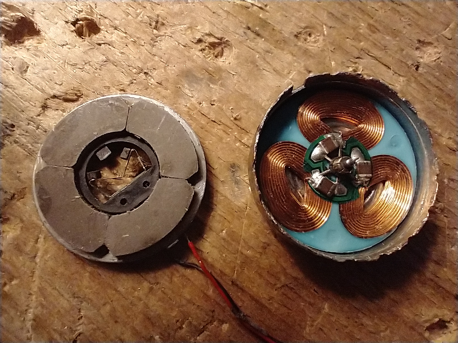

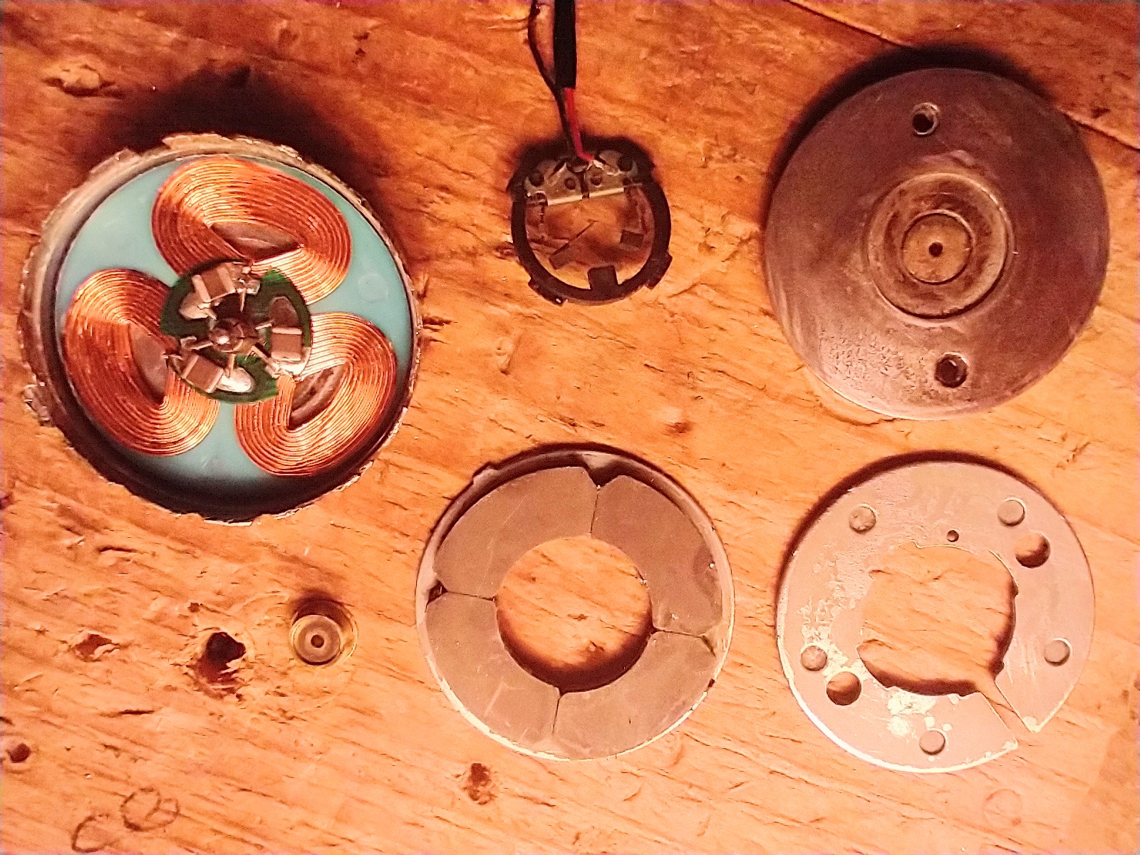

    4. Motor repair
    This requires removing the main board, the belt, and desoldering the motor board.
    The motor has a small hole in its case that looks like an oil port. It is not. It does not go through. I don't know how to lubricate the motor other than soaking it in oil or disassembling it. It is not designed for disassembly. Yet corrosion from rotting batteries seems to easily find its way inside the motor.
    First, pry the belt pulley off the spindle. This is a press fit that will get looser every time you remove it.
    I filed out the dimples in the case to separate the cover part. I also had to bend the metal between the filed grooves. Then there are several layers of round metal plates. Some are held in place by the motor magnets. You have to carefully document the order of these plates and which side is up or down. Some take force to pry apart. The corrosion doesn't help.
    There are some hair-sized wire brushes in the commutator. Carefully record how they are arranged before you remove these parts, and how the two wires thread through the plates. These brushes are EXTREMELY easy to damage. Anything you wreck means the motor is a write-off.
    I thoroughly cleaned all the corrosion out of the motor. Putting it back together properly required several attempts, and in the meantime the pulley became loose on the shaft. My attempt to tighten the fitting by impacting the end of the shaft resulted in damaging something inside so that the free rotation I had achieved, was no longer free. So the repair was wasted. Next time I would use thread locker to attach the pulley to the shaft.
    IMG_20250312_175104862.jpg IMG_20250311_114114951~2.jpg IMG_20250311_135056983~2.jpg IMG_20250311_133340569~2.jpg

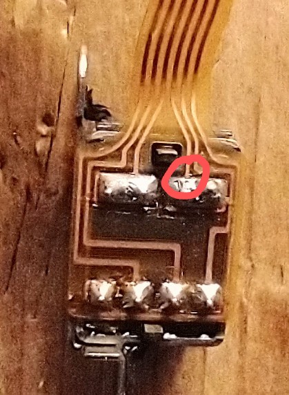

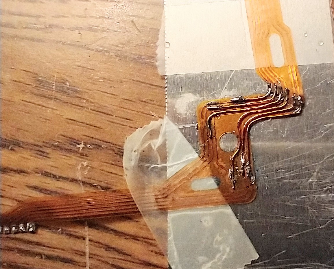

    5. Ribbon cable tears
    These players have flat ribbon cables for the head and another for the equalizer. They are a total nuisance when doing repairs. They are very easily damaged and very difficult to repair. A person I contacted who does SMD repairs simply refused to touch them. These cables are impossible to obtain except from donor units. And equalizer cable in my donor unit was rotten beyond use.
    Desoldering them from the main board as part of the repair sequence greatly lowers the chance of damaging them. But at the cost of the extra work and risk of damaging them while soldering. Remember the rule of not applying the iron to the work for more than 2 seconds.
    There is a YouTube video of someone repairing them. That person succeeded in neatly bridging the breaks using only solder. I've been unable to accomplish that and I have to use jumper wires instead.
    The simplest way is to jumper between the terminal connection points of the ends of the cable. The damaged cable can be used as a base guide, and the repair supported with durable tape such as fiberglass reinforced tape.
    The next and more presentable repair is to solder jumpers made from thin transformer winding wire, across the breaks. This wire has a fairly tough insulating coating, as it must have. Staggering or separating the points where the jumpers connect to the traces lowers the chances of inadvertently loosening one while you heat an adjacent wire. Which will happen if the connections are beside each other.
    Choose the solder points and scrape the coating on the flat cable until about 2mm of trace is exposed. Using flux and solder, get a bit of solder to adhere to the exposed trace. Prepare the jumpers by baring and tinning the ends to get a bit of solder on the ends. Then it's easier to get the wire end to solder to the trace. This is still finicky work at best, but the more you do the better you'll get at it. Done properly the connections are very secure. Done improperly they will look ok but soon come apart.
    So be sure to check for continuity before reassembly. Consider reinforcing the repaired area with sturdy tape.
    DutchNick and Valentin like this.

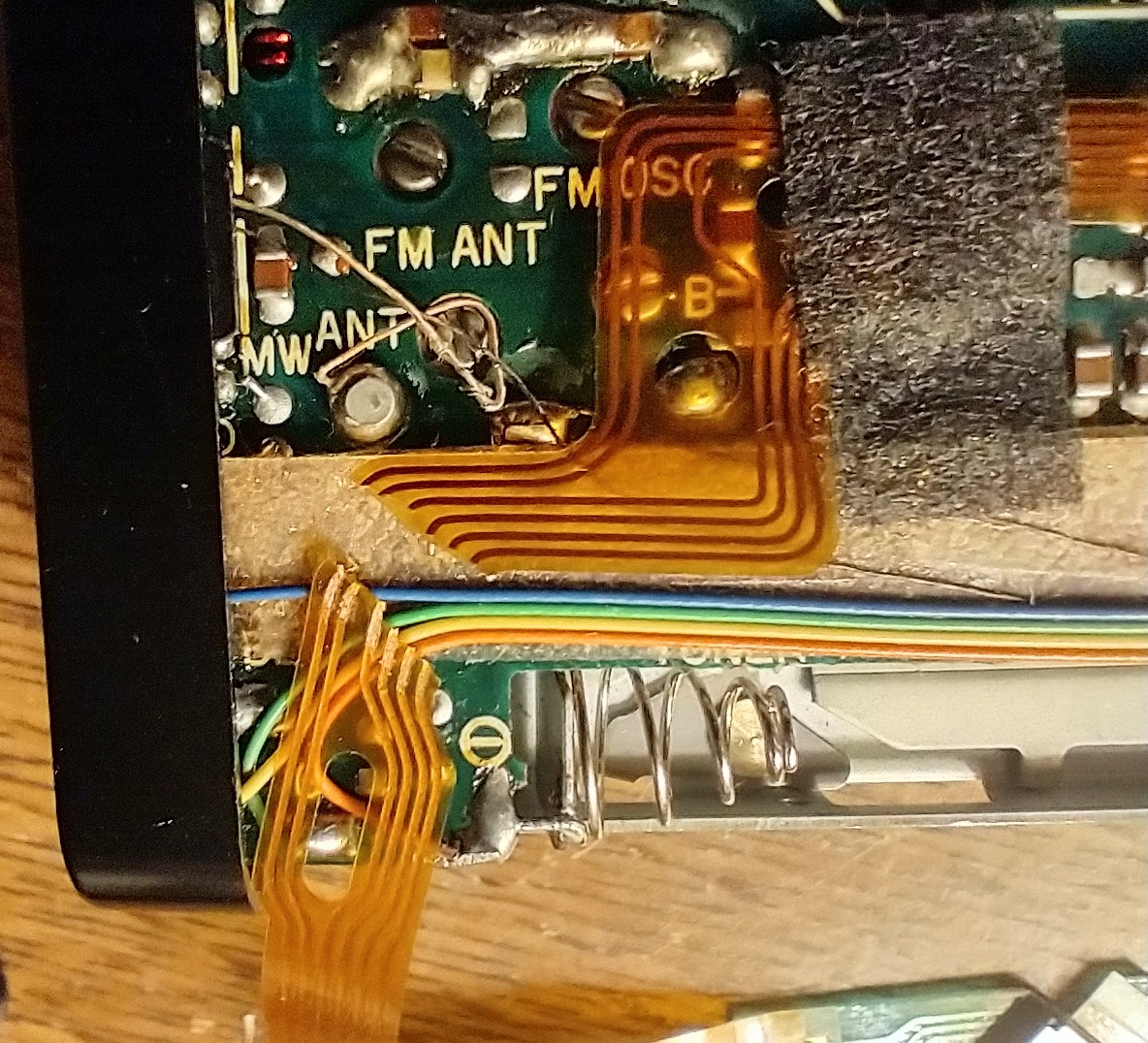

    6. Ribbon cable connections
    Many of these players have broken or cracked flat ribbon cable terminals. Every time the Play button is pressed, the head ribbon cable is flexed where it attaches to the head. Every time you move parts around while doing repairs, ends of the cables are flexed. Sooner or later a trace or connection will break. Some models have a brace for the head cable, but this only changes where the flexing happens.
    This is the place to note that improperly replacing the control panel can jam against the head cable where it attaches to the main board, and damage the cable. The cable must be flat against the board.
    Cracked traces show up as loss of one or both channels. Equalizer cable breaks will affect both the radio and playing tapes. Head cable breaks will affect only tape playback. Because these breaks typically are not visible, continuity checking is the go-to approach for finding them.

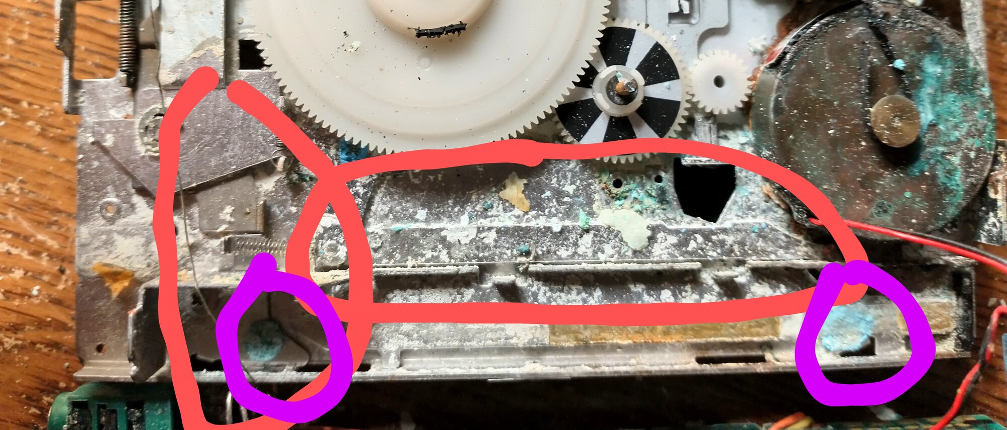

    7. Cassette detect levers corrosion
    This requires removing the main board from the chassis, and disengaging springs attached to the levers.
    This is why the record button won't work on the players that record.
    The Aiwa 2ME-7 usually has levers to detect inserted cassettes, and on units that record, levers to detect the no-write tab state of prerecorded cassettes.
    These levers are right next to internal battery compartments, and one of the first areas to be invaded by battery corrosion. You can see one end of the levers in the bottom of the cassette bay.
    There are two corrosion problems. One is that the sliding or pivoting levers get stuck due to corrosion between them and the chassis.
    And when you go to fix that you find the levers are attached to the chassis not with e-clips, but with press-fit brass fittings that also provide the pivot friction. You can make the fitting to rotate in the hole in the chassis, but the proper fix is to have the lever rotate with respect to the brass fitting.
    The solution I worked out on the donor unit is to lightly hammer out the brass fitting from the other side of the chassis. Then you can separate the parts and remove all the corrosion. Reassemble and gently impact a small centre punch or equivalent to resecure the brass fitting to the chassis. Don't overdo the hammering. Replace the springs and oil it. The levers must move freely with only the spring tension.
    The stuck levers are circled in red in the photo. The corroded brass pivots are circled in purple.

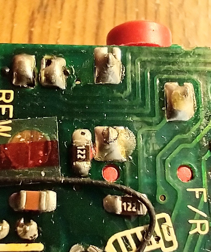

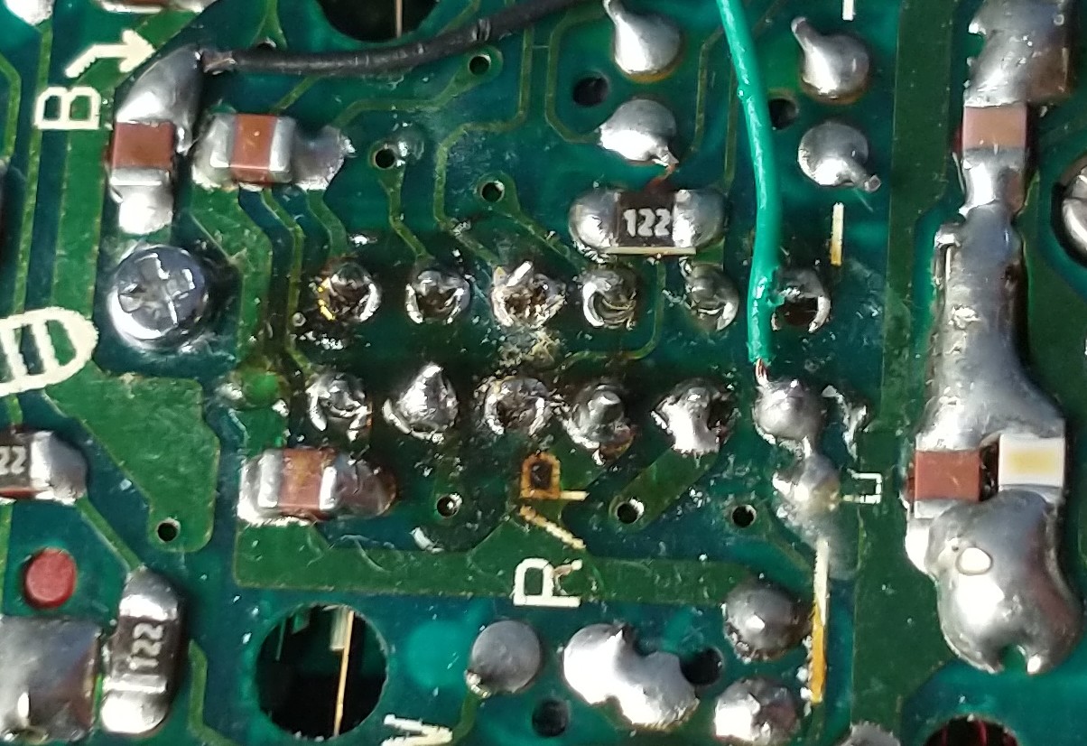

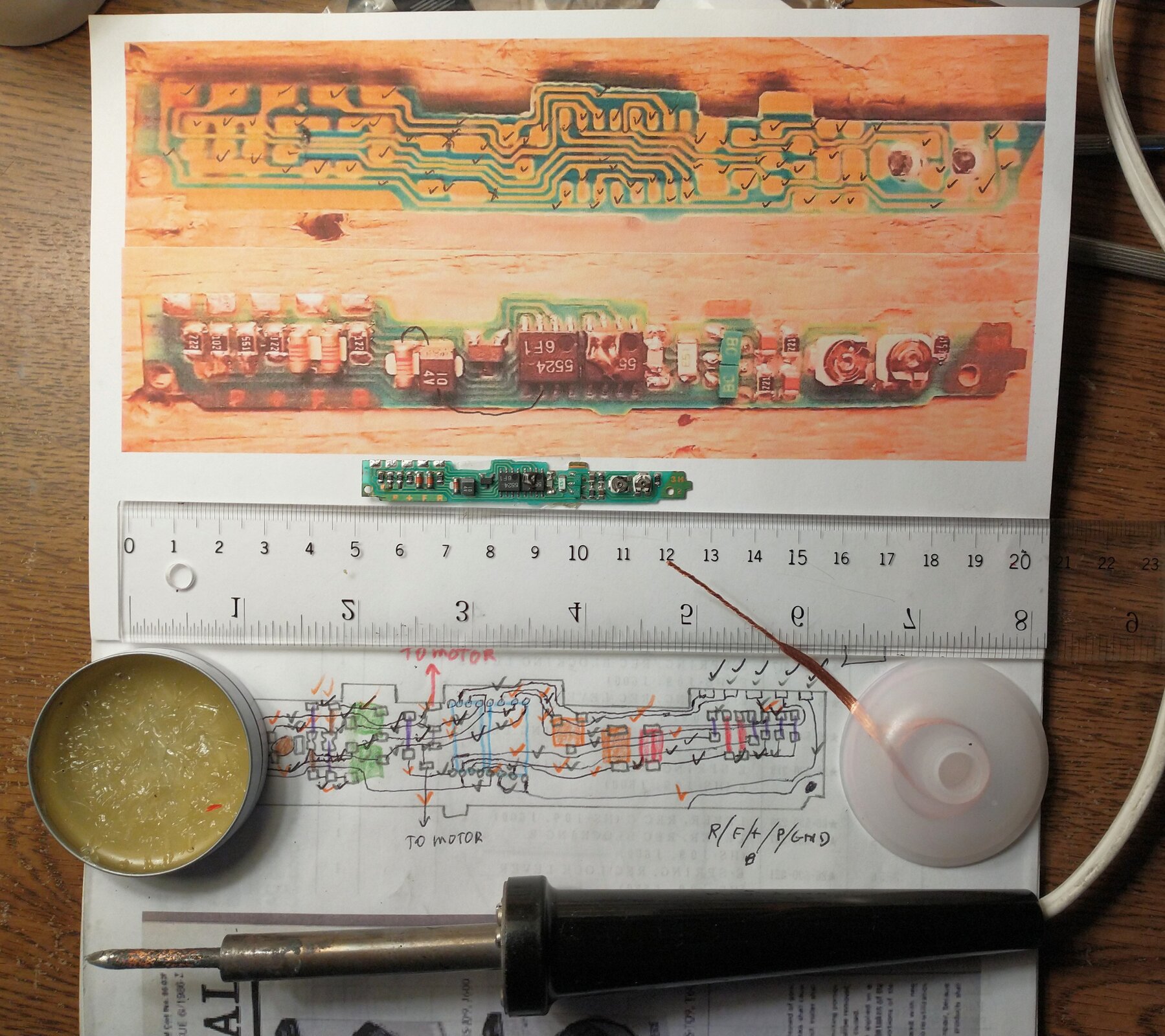

    8. Main board soldering
    I have found broken or "cold" solder joints in all sorts of places on the main boards in these players. A bad capacitor had fallen off the Dolby board of the J10. An inductor had broken off next to the earphone jack in the J10. A couple of invisible breakages of a diode from a motor board in a J9.
    On one of my units, switches Sw1 & 2 were not soldered properly to the main board. This appeared to be a factory defect. It may have passed quality checking, but probably never worked properly and so the unit has almost no wear. It's amazing it was never just thrown out.
    Besides using the circuit diagrams to check for continuity, you can also use the rare voltage specifications to locate problems. The alternatives are very careful visual inspection, using something like a toothpick to poke at things with the unit powered up, and as a last resort, swapping components with known good ones.

    11. Cracked battery solder joint
    This is where the white plastic bracket attachment and the negative battery terminal lid solder to the main board.

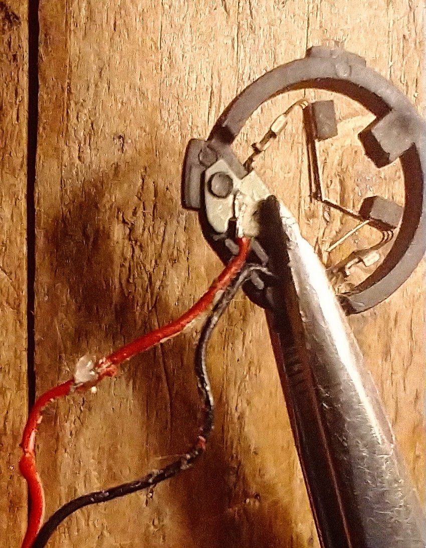

    16. Sensor wires
    This mechanism has a gear with a strobe pattern. There are 4 wires attached to the sensor for that gear, and the wires can be broken off the sensor when the unit is serviced. This will prevent the motor from running. The breaks can be hidden under the black glue.

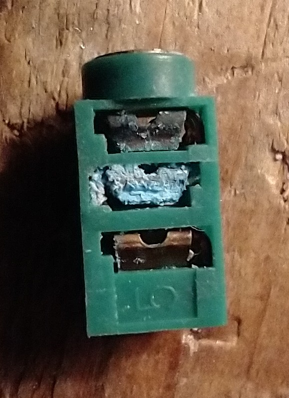

    18. Earphone jack corrosion
    This is common. Desolder the 3 connections to the main board and either replace the jack, or carefully push out the brass components and clean them. They may require bending to get proper contact with the earphone plug. Especially the one in the bottom of the jack. I used a spare male 3.5mm stereo jack to check for continuity through the female half.

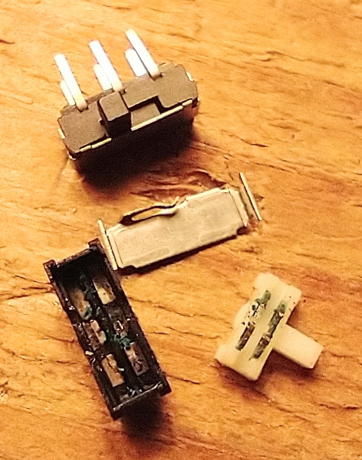

    19. Switch damage and corrosion
    The little slide switches can be corroded or broken. Replacements are available with different contact layouts and knob vs pin arrangements. Disassembling them for cleaning is relatively easy. My attempt to fix a crushed switch was a waste of time. Unfortunately like a lot of this stuff, to get one you have to buy a bunch of them. On the other hand these things are cheap.
    Photo of a corroded and disassembled switch, with a new replacement.
