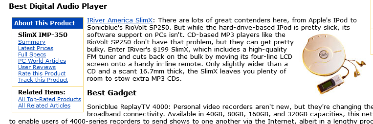

    16,888
    A lot of the photos are down on the archived site but here's a jotting for the best of 2002. You might get lucky if you randomly hit links, they do have support information but it's difficult to find.
