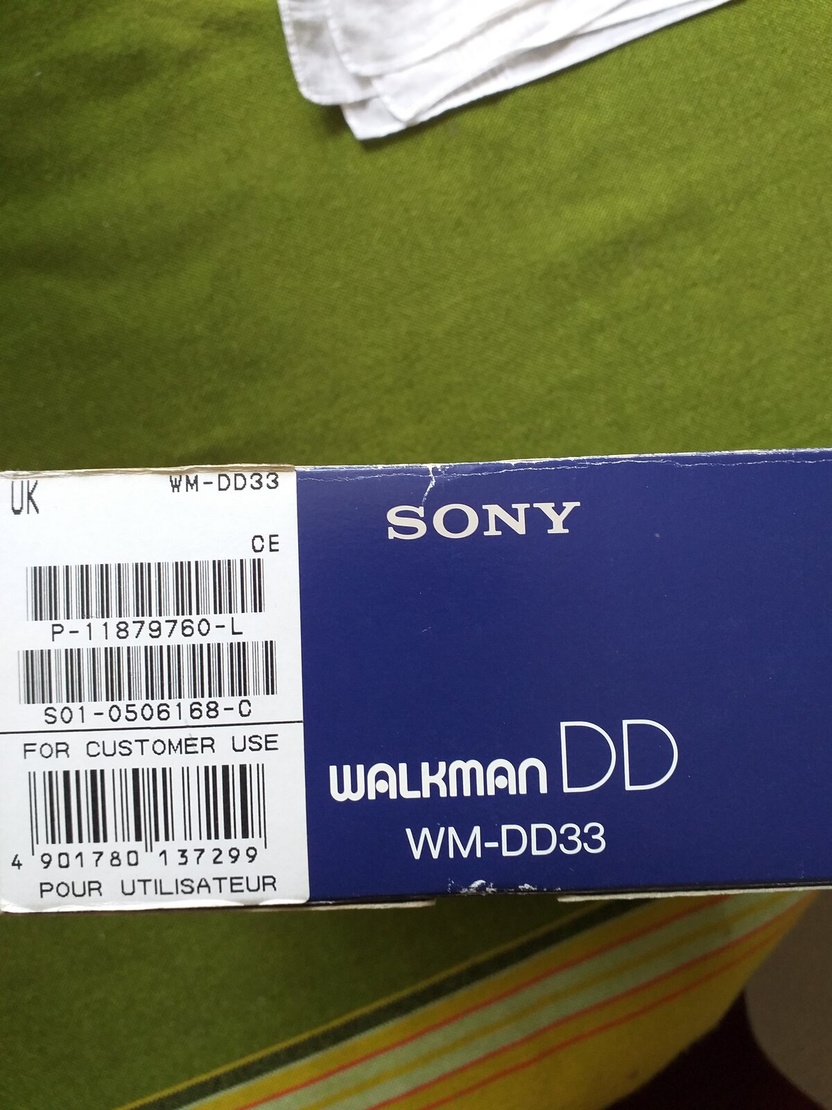

    Hi everyone. The serial number on my DD-33 Walkman is 506168. Is it a high number? I ha vev no idea. How high did the serial number on the 33 go up to. So let's see who has the highest serial number. The reason I am asking is could Sony have somehow strengthened the centre cog on their later 33's. I have been using my 33 every few days for years now but I have never used fast forward/rewind or cue/review on my unit. I only used these on my D-C2 AND TC-D3 (D3) when I first bought them and they both developed the centre cog split. I only very occasionally used them on my D-6C'S but not now. I use a separate unit for that purpose. So my question is could there be a connection with using the fast forward/ rewind function that could contribute to the splitting of the centre cog over prolonged use? So post your unit's serial number and see who has the highest one.
