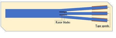

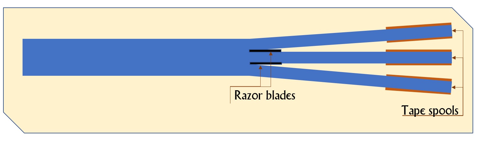

    probably, though im curious as to how you split the vhs tape into 3.
    ive made a diagram, something such as this?
  19. CosmicDownpour
    CosmicDownpour New Member
    utah
    Close, I actually just used the cassette reels to space the blades such that it would cut them at reel width and ran the tape from VHS spool to VHS spool with the cutter in line with the tape transport path.
    I'm finding now, however, that 5 razor blades are needed, not 3, as the VHS tape width is actually slightly wider than 3 cassette tape tracks.
    You also need to keep tension on the tape as it has a tendency to want to bow in a bit otherwise, and that widens it.
    I'm going to buy a cheapo VHS player from a local thrift soon and try to make a simple automated system to do this.
    In fact, you don't really have to open the VHS housing to do any of this, so it can be stored with the cut tracks untill you get around to spooling them into cassette shells.
    Either way, I started asking about VHS to Cassette conversion on the tapeheads forums (with mention of this thread of course), and they're saying that while all this is plausible- you'd have to mod your deck to get any high quality recordings onto this tape.
    VHS uses a slightly different type of chromium tape from cassettes.
    I'd love to know what software you used to make that diagram btw.
