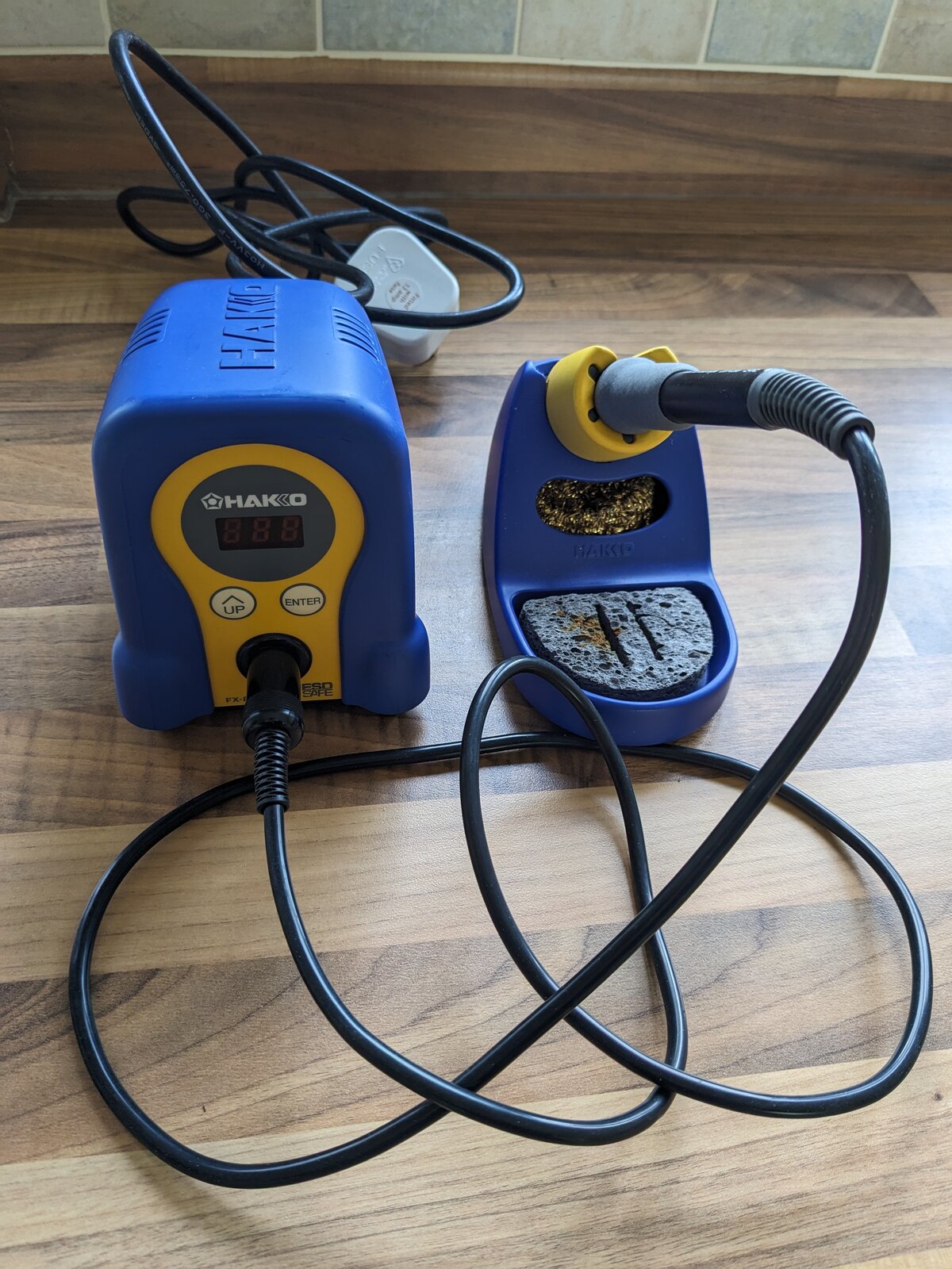

    Just in case you all wondered what I ended up with, the 2nd hand Weller was sold. Searched online and a reputable seller 8000+ was selling their Hakko, showed all the photos to prove it wasn't a copy etc and price I thought was good as it came with extra genuine Hakko tips, solder and desolder braid. Paid £100 so happy. It arrived this morning and the first thing I can tell is this is a quality unit in my opinion. Anyway thank you for your help. PXL_20240319_140643466.jpg

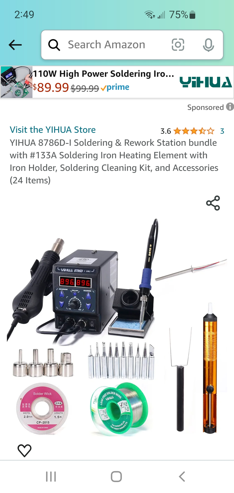

    I now using the YIHUA 8786-D Rework Station. Temp settins are very stable and precise. Thought I would chime in! upload_2024-4-3_2-50-28.png

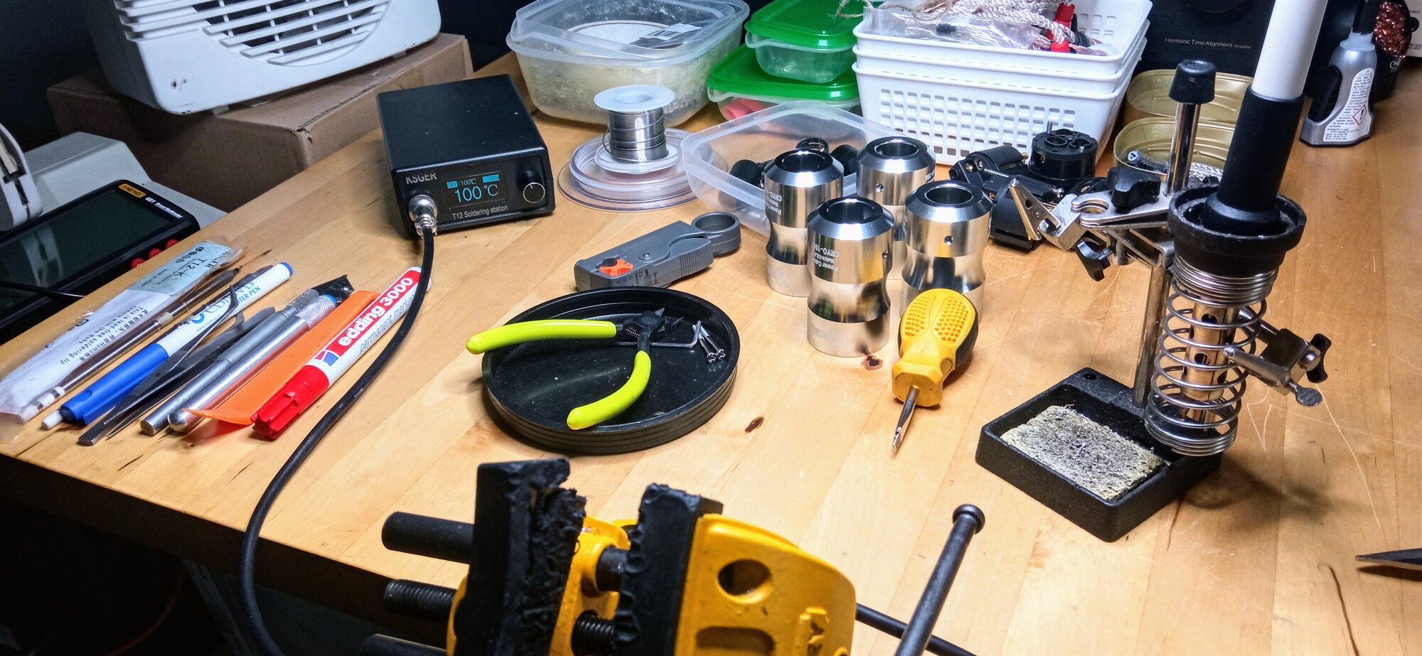

    I used to have a Hakko until it went wrong. Admittedly it did get unceremoniously pushed off the end of my workbench which probably casued an internal issue. I had a poke around and couldn't find anything fixable so I determined it was dead and sold it on Marktplaats for scrap for a tenner.
    I intended to replace it like for like before someone pointed me in the direction of the KSGER T12 solder stations as sold ubiquitously on aliexpress et al. I was of course a bit skeptical - Chinese build quality etc. But at around €50 including a bunch of tips and free delivery I thought it was worth giving it a try.
    Had to wait about 2 weeks for it to finally arrive, during which time I was subject to using my lamentable standby iron and I was tempted to just order a one-day delivery new hakko via Amazon but I'm so glad I stuck it out and waited!

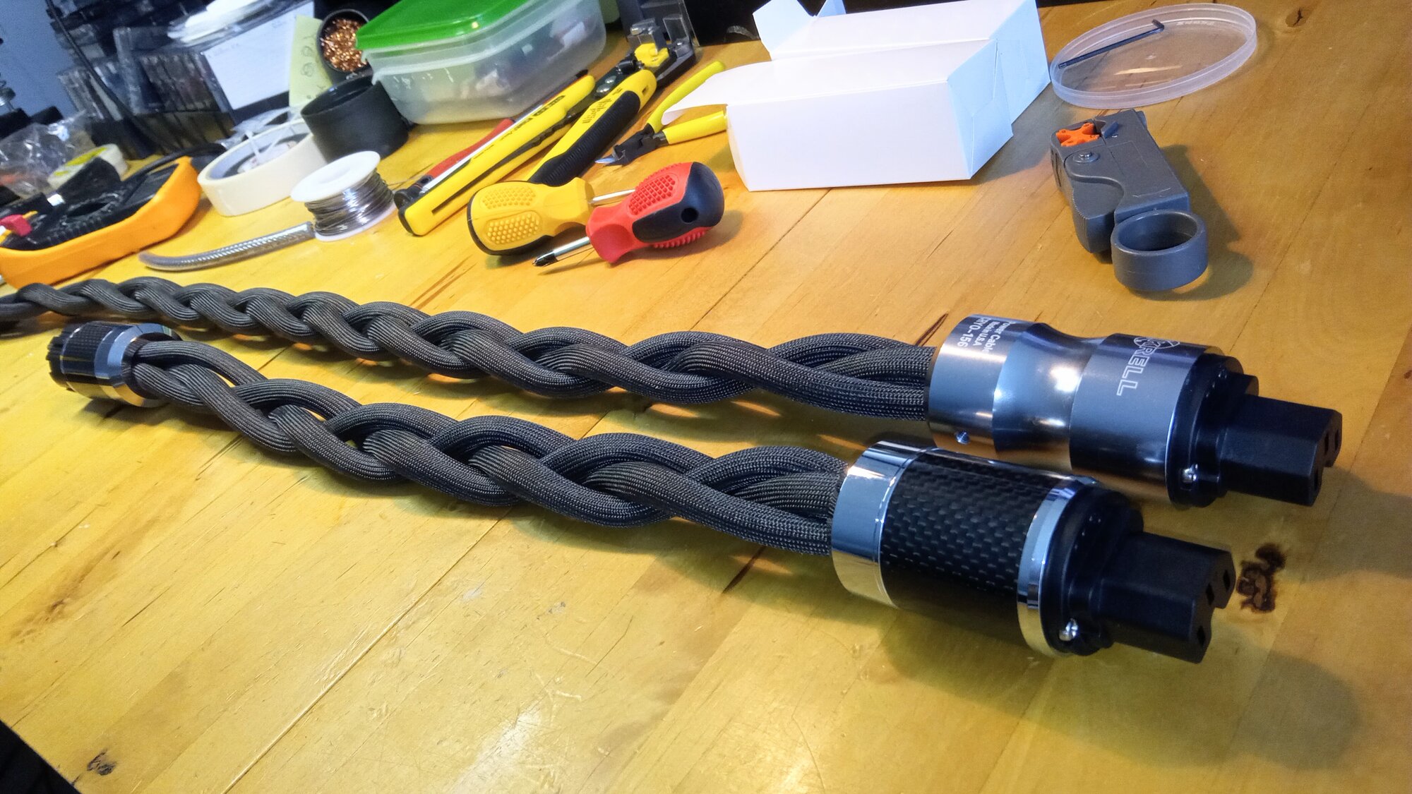

    This thing has been a revelation. I've been using it daily for about the last 2 years (I'm a cable-maker by trade these days) and it hasn't skipped a beat!
    I bought extra replacement tips, thinking they would wear out as fast as the Hakko tips but whatever they're made of (maybe tungsten carbide) they look as new as when I started using them! I use predominantly the D16, D24, JL02 and K tips for different types of work.
    Has all the features of the Hakko including fast heat-up when lifting it out of it's holder / shaking it etc. Goes into low power mode when not in use. Gives temp read-out (handy for low temp solders, esp if you use Oyaide SS47 like I do). Calibrates to the tips.
    I'm thinking about getting a 2nd one as a standby just in case as they're on offer at the moment I saw.
    I really ought to think about getting a proper solder station extraction hood for the amount of hours per week I'm soldering. I use a fan to blow away the fumes and keep a window open but I know that's not really sufficient.
    Anyway, highly recommended from me!

    Really enjoying my Hakko but I don’t think I’d paid full price though. Ironically 1 day after buying the SS on eBay Amazon put an offer on the weller of £124. The KSGER T12 looks good for the money and maybe a prezzie for my best friend later in the year.
