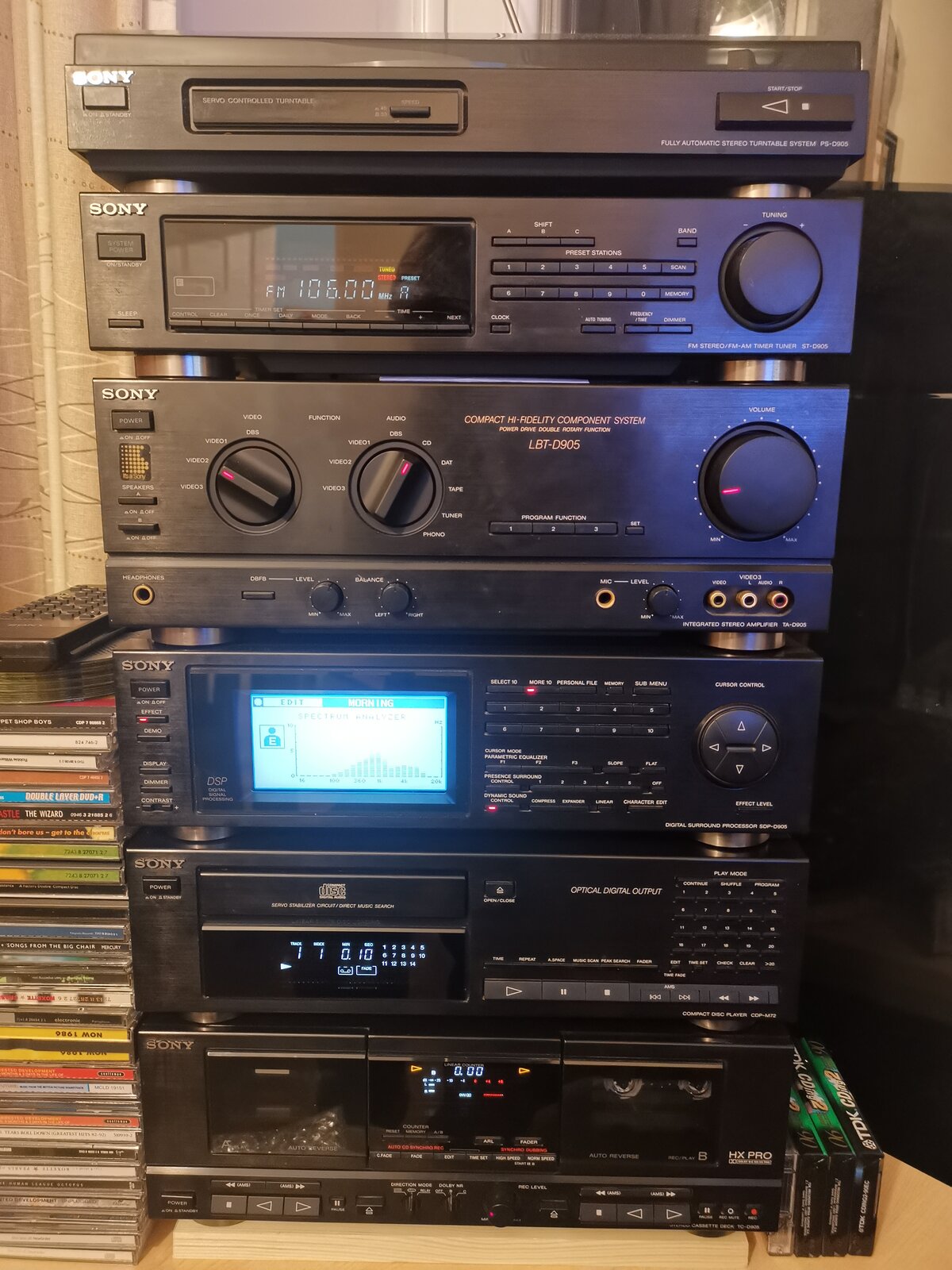

    Hi All - The Amp on my LBT-D905, is not ouputting any audio for the first few seconds.

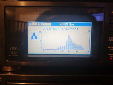

    It is powering up ok, and the DSP`s screen is showing the `spectrum analyzer` Ihave had this system for almost a year now, and its just started this issue.
    The Amp is TA-D905. Any ideas why I`m having this problem?

    startup is all kit turned on, and then powering up the tuner, kicks everything else into life with a good few relay clicks.
    The LED on the volume knob flashes a few times and then when it stays on - thats it fully booted and audio starts. Usually.
    Just tried it again, and no audio, but when I moved the volume a tiny bit, it started to come on, but quite at first - then over about 10 seconds, it seemed to of reached the correct volume.
