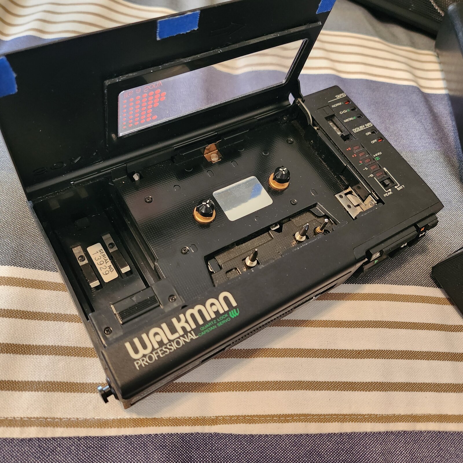

  2. Walking_Man
    Walking_Man New Member
    26
    Canada
    Here it is, with the serial number

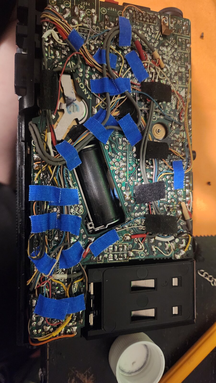

    Update! Finally received my new meter today, upon opening the unit...I found something strange...here are the pictures...I don't think the blue tape is OEM, and the chips...seems like they've been replaced? I'm really confused. Unfortunately there is no way to contact the person again as he deleted the ad off of my local marketplace...
    Regarding the voltage testing, there was zero voltage on the 11v pin, and 5.5v on the 6v pin...seems like i know what my next step is...rebuild the DC-DC converter?
    Anyways, thanks for the help again Deb64. If you can give me anymore pointers that would be very much appreciated, thanks again!

    The blue tape is definately not factory tape. The tape is normally black.

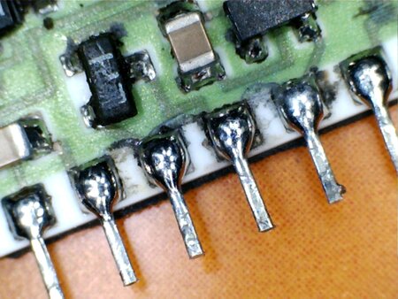

    The CP602, however, is very interesting. It looks as if somebody has removed the CX20024 chip (not to be confused with the CX20084 used on the D6C) and tranferred it to a new printed circuit board. It is a GRP board with screen printed component idents. The original board is a ceramic base with printed resistors and no screen printed idents. The CX20024 is not available and hasn't been for many years which is why the original one will have been used.
    Some years ago I was asked by another repairer about the possibility of making a new circuit board for the CP602 and transferring the CX20024 to it (as has been done here) but never got round to it. It is interesting to see that somebody has done this and good news for @Walking_Man as the CP602 repair has been carried out already.
    The problems with the old ceramic board, apart from being difficult to solder on, are possible chemical changes in the green solder resist over time and occasional dendrite formation, normally between the pins at the edges of the potting compound.
    When repairing a CP602 module, I clean between the pins thoroughly and also scrape away the green solder resist around the FET and NPN transistor which I replace.
    I also clean out any remaining potting from under the pins of the CX20024 and check all the solder joints of the chip and other components. I have found some very bad solder joints on these modules underneath the potting. This cleaning and reworking needs to be done thoroughly otherwise the wow and flutter will be affected.

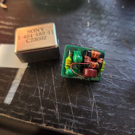

    Update, upon disassembling the DC-DC converter (hopefully i didn't break anything), I discovered more strange things....it appears to be different from the one shown in Mikhom's guide...is this a different variation? Or did someone temper with this as well? Or am I missing something? Really appreciate the support so far.

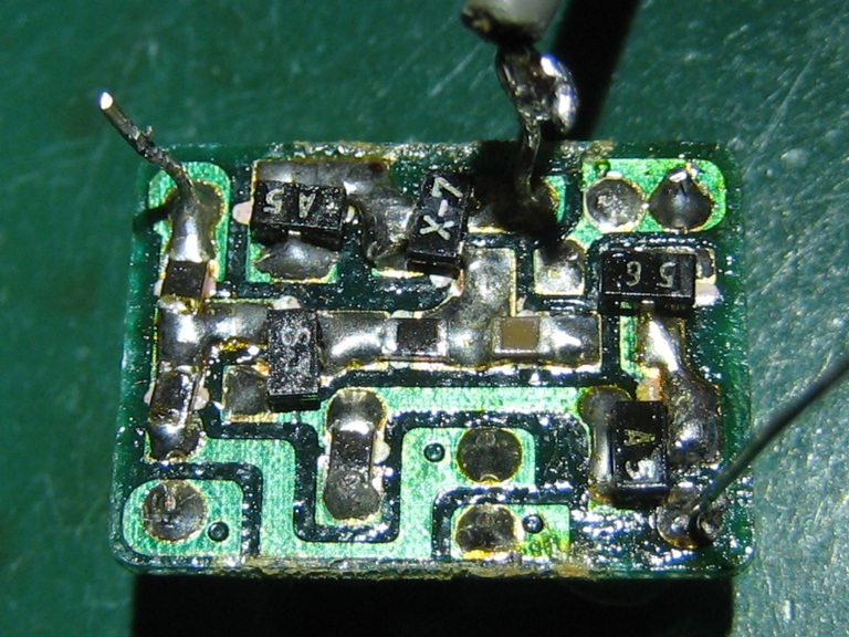

    The DC-DC converter is an earlier version, which was used on some D6s. I have repaired at least one of these.
    The principle is the same; replace the two tantalum caps and the open circuit inductor and replace the 2SD1048 transistor (marked "X-7")
    The 33uH inductor you have found looks OK but check the physical size before ordering. There isn't much room inside those small cans. This also applies with ordering the tantalum caps.
    Don't forget to check the operation of the converter before sealing it back inside the can.

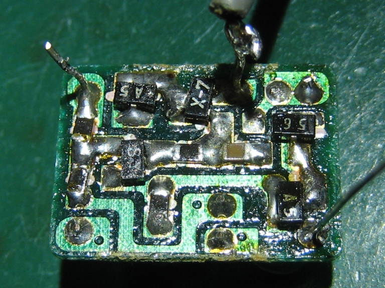

    Update ...bad news? I think I've managed to fix the DC-DC converter, as now I am getting 11V on the orange pin. But the problem persists, still running fast. However, I am getting sound. So there's an upside, and it sounds quite good despite being sped up. Rewind still doesn't work, but that's a later issue. I'm going to try to do some more research; in the meantime, any comments would be appreciated. Thanks a bunch.

    After some testing, I am ninety percent sure it's fixed. Finished calibrating speed and head position. I tried to manage the wires to the best of my abilities...why so much wires...
    Anyways, there's still one little thing. I discovered that the rewind reel is cracked, so I glued it onto the shaft. Still, it resists to rewind. I'm thinking it's something to do with the clutch, because when I press it, it starts rewinding but slows down gradually. Its not the dried grease as the inside of this is extremely clean, and all the grease looks new; The last person who worked on this was clearly a professional. Also, with no tape in the machine, both reels turn oppositely...and the VU meter/LEDs doesn't seems to work when selecting "peak". I guess those are my next tasks.
    For now the rewind works while paused. So it kind of works.
    Thanks again for the massive help Deb has provided. Thank you so, so much.

    Firstly, congratulations on getting the DC-DC converter fixed and sorting out the FG wires. I saw your first post this morning and was going to suggest checking the FG wires but you beat me to it.
    The rewind problem sounds rather unusual. You should not get both reels turning if you put the walkman into rewind with no tape in it. Also the fact that rewind works when the machine is paused seems to suggest that the take up reel is being driven when in rewind. It sounds as if the take up spool is being driven by the small rubber idler, as it normally is when in play. When you press "pause" the small idler is moved away from the outer edge of the take up spool drive assembly.
    When you press stop, the small idler should be moved away from the take up spool assembly and from the black plastic belt driven gear, which drives the small idler. You should check if this is happening.
    The level meter not working is possibly the TA7654P LED driver chip. This is a standard Toshiba chip and it is normally possible to find a replacement on Ebay. First of all check that you are getting 6V on pin 8 of the chip when the switch is set to "Peak". When in "Batt" mode, the chip is disabled by removing the 6V power supply from pin 8. I have had a couple of these chips fail on D6s before now.
