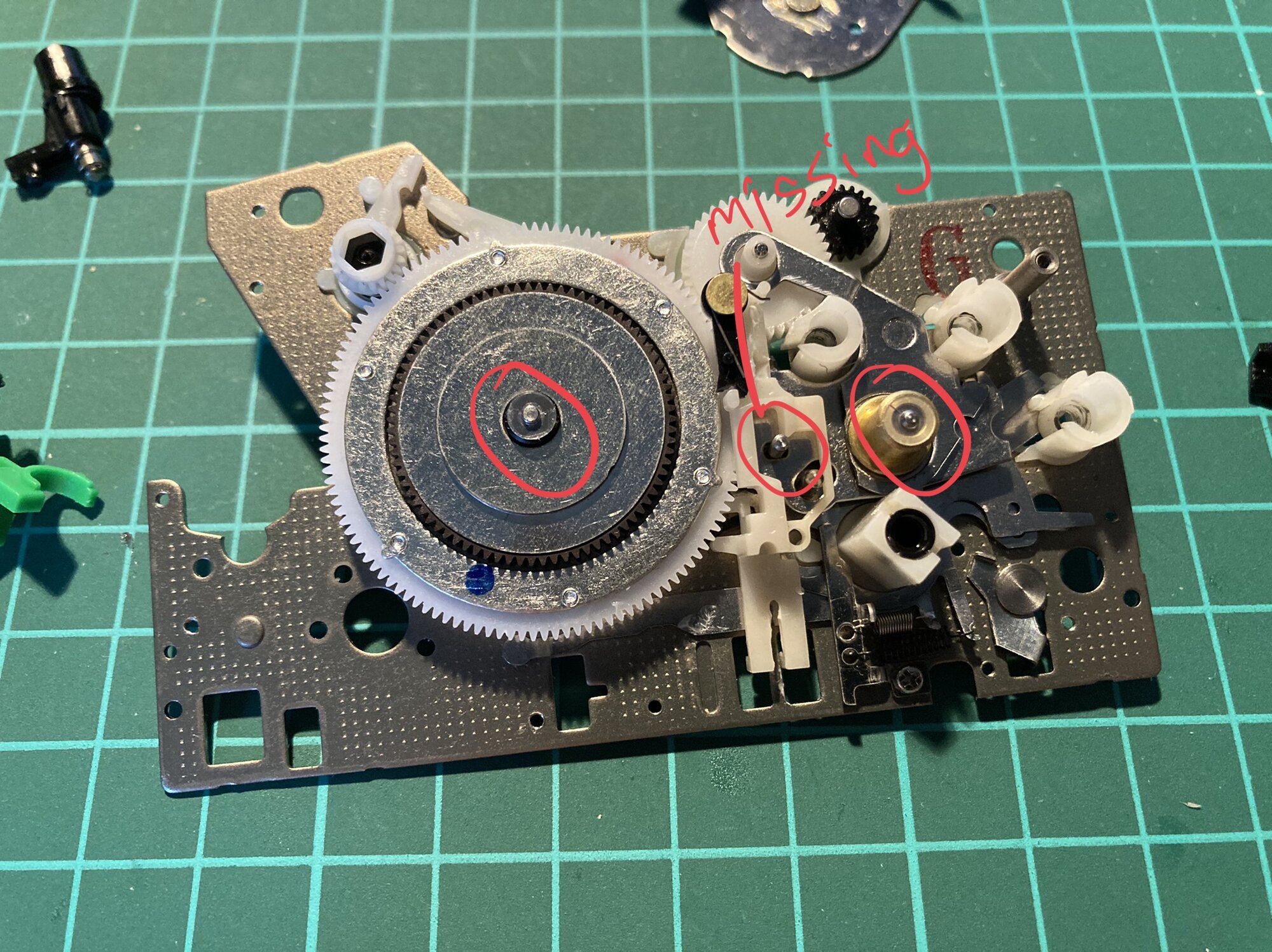

    Hey all, so I’ve been busy repairing my DC2 walkman, the usual stuff - new drive gear, new small reel gear, new capstan rubber (may even go pinch roller too) Having stripped it all down and got to the barebones of the drive gear I dismantled it and placed the 3 x clear plastic washer clips in a line on my work mat.
    and guess what. I’ve lost one. While I was reassembling I was telling myself “I’m sure you had 3 of those and now there’s only 2” I’ve been on my hands and knees with a torch for hours looking on the carpet and around my work area. Cannot for the life of me find it.
    So this is a plea, to anyone out there with spare parts for these DD walkmans! I can’t find any info online about buying a replacement. Can’t believe a seemingly inconsequential part could ruin my dreams of a click-free DC2!

    These seem a lot thinner than that one. I’m not sure if it would hinder the movement being too thick? I’ve been googling all last night and can’t find anything. I’m wondering if I could make my own using some thin plastic and leather punches 3D43457A-EADC-486C-9B03-3B4AE55F54E1.jpeg
  3. Valentin
    1,676
    The thickness could be adjusted with a file or sandpaper. The problem is the center hole diameter, which is too large.
    The one in the post I deleted seemed bigger since it was for the capstan, so I don't think it's suitable.
    You could certainly make your own as a last resort.
    But I would search for the lost one a little more, maybe you find it. Also search in the mechanism itself, it could be stuck somewhere and hold in place by oil or grease.

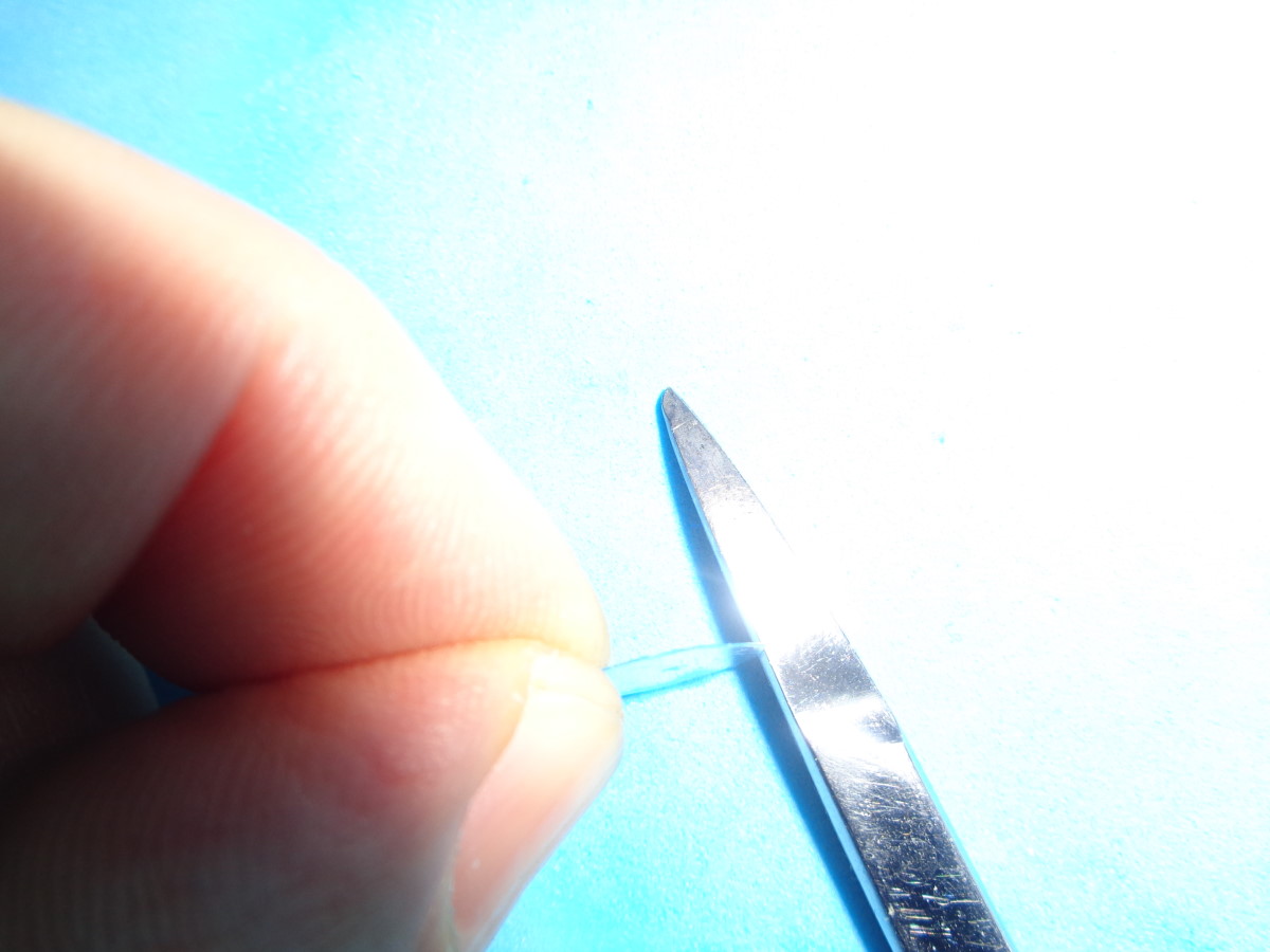

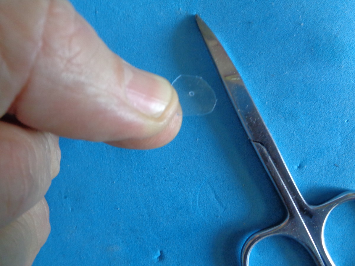

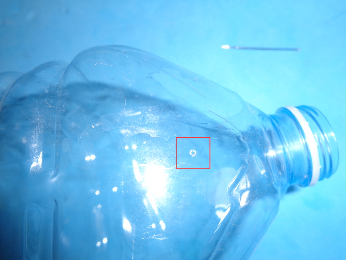

  4. Silver965
    Silver965 Well-Known Member
    721
    Torino

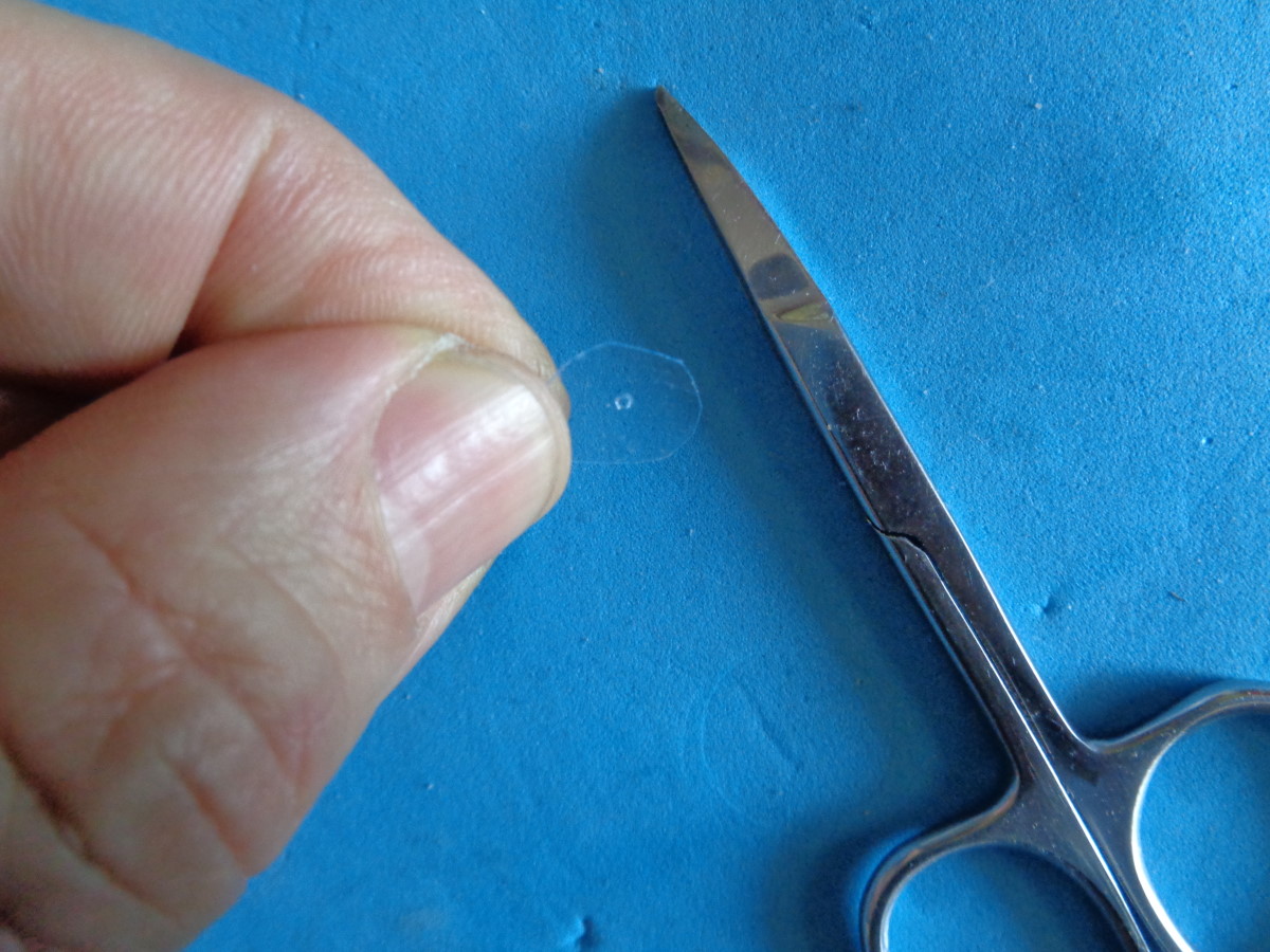

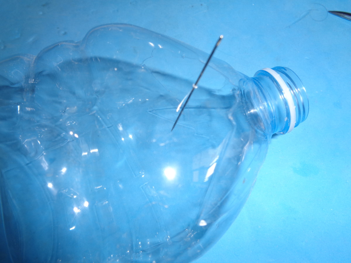

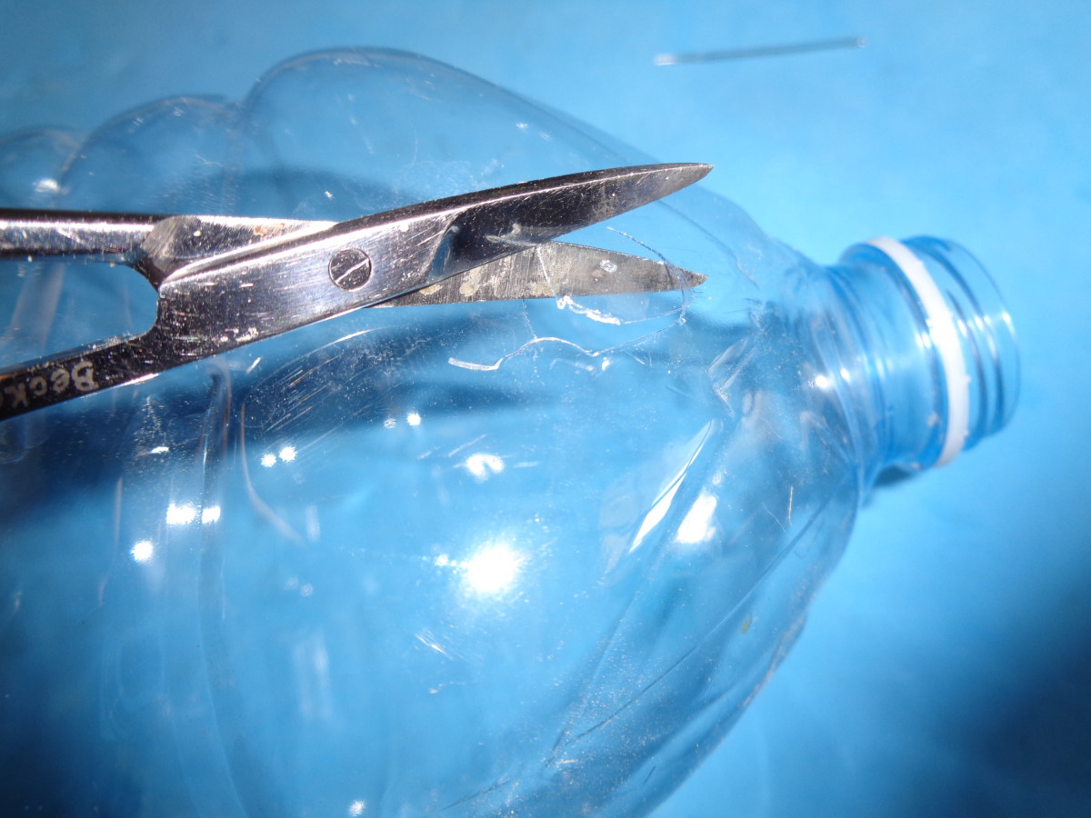

    Hi ... Sometimes I solved it like this ... With a needle punch a hole in a plastic bottle, enlarge the hole to your liking ... then cut out the piece of bottle bigger than you need. .. finally modify to your liking. .and mount it

  5. automatom
    automatom New Member
    25
    Ahh a plastic bottle! You’re a genius. I was thinking of ordering a sheet of plastic off ebay. I’ve got some leather hole punches and found two that will make pretty much the perfect inner and outer holes. Maybe I start selling these things on my ebay shop!

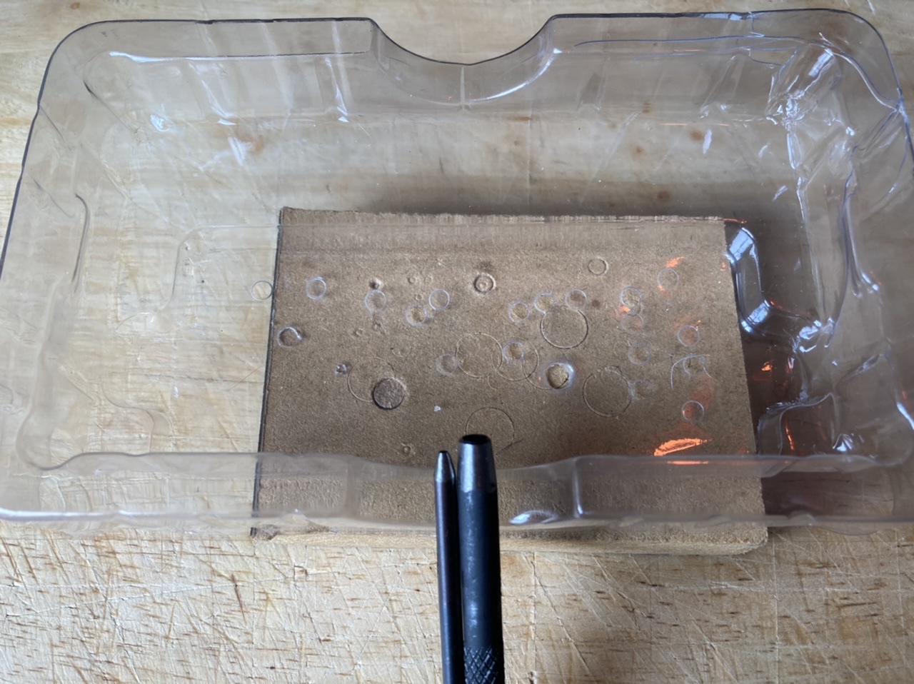

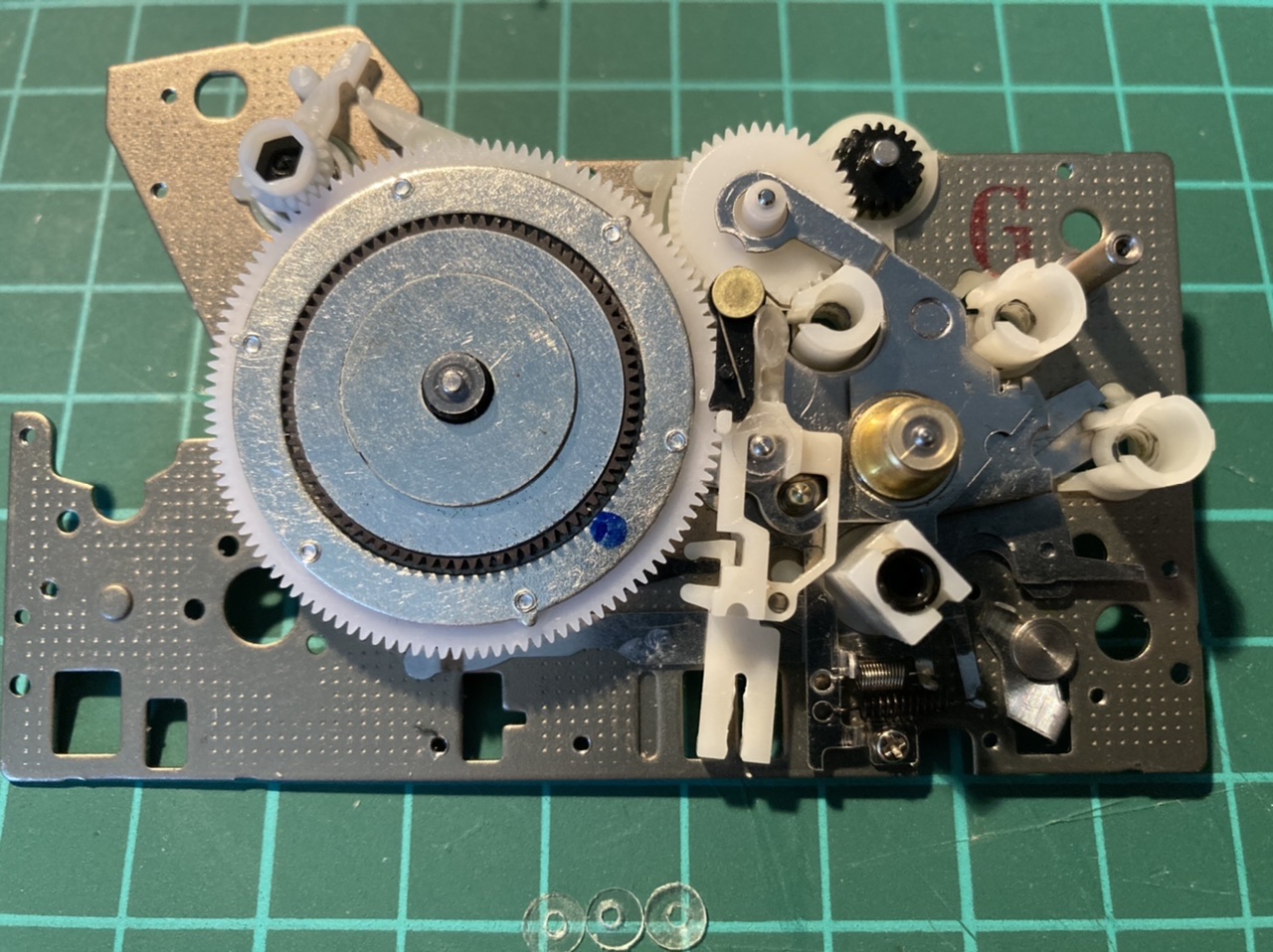

  11. automatom
    25
    Okay guys an update, I made some washer clips from an old plastic tray and, while a few were a bit wonky, I managed to make one seemingly perfect and it doesn’t pop off. I even tried applying some pressure with tweezers and it feels pretty sturdy? Gonna give it a go.. 64A11E78-081E-4517-88C7-99DA98E431AF.jpeg
    Boodokhan and Valentin like this.
  12. Valentin
    1,676
    Congratulations, @automatom ! It looks almost identical to the original ones. Now this is a good reference for people loosing these washers, which happens to everyone at some point in time.
    What method have you used for making the center hole ?
    automatom likes this.
  13. automatom
    25
    So this was what I used. It was a plastic tray I got a PS2 hard drive adaptor in!.. and some hole punches. The trick was not to hit the hammer too hard so it didn’t deform the plastic, had to get the perfect amount of pressure E794BBFD-F809-4B3D-9B06-DC8583107589.jpeg

  15. automatom
    25
    Sorry for the late reply. So the outer punch is 4mm and the inner is 1mm. I imagine 0.9mm would’ve made it a factory fit (and probably need an edge splitting with a knife) but this one seems to be holding firm so far. My soldering iron flaked out on me so I can’t solder the battery wires back on yet, but a new one should be arriving tomorrow. Looking forward to finally getting this thing back together and giving it a whirl!

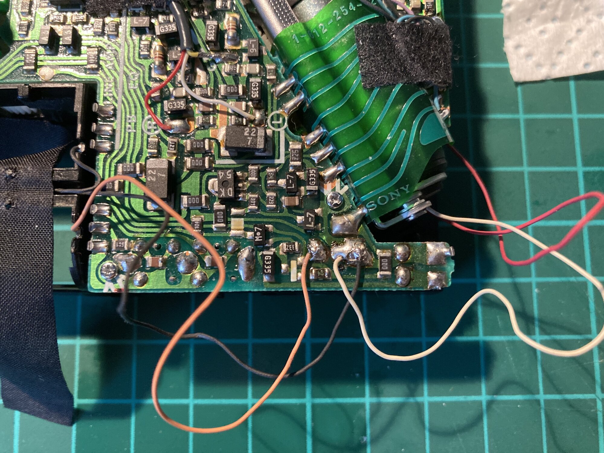

    Hey all, I’ve hit a bit of trouble putting this thing back together. That is, I couldn’t remember where the orange wire went! I tried to look at an old pic I took when I was taking it apart but it was too low quality to make out. So I’m wondering if I got the wiring right? I don’t want to put batteries in to test it until I do! Cheers 5FB4ABD8-C814-45FA-8583-25723AC717C2.jpeg
