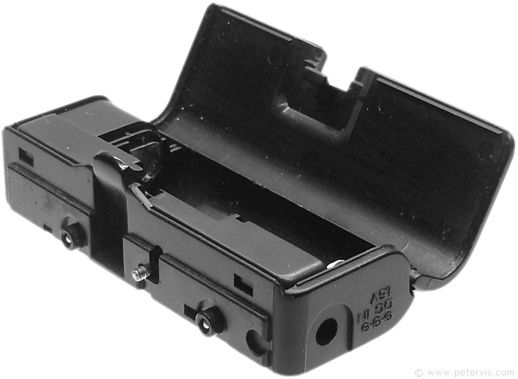

    Gentlemen/Ladies, can the Sony EBP-7 battery tray charge AA batteries or is it just a power supply for the Walkman.

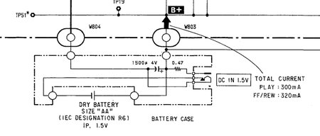

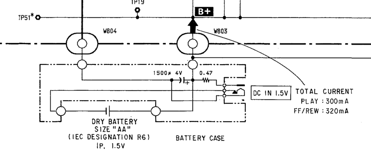

    All the sidecars I have seen have no charging circuit.
    Some don’t even have a power jack.
    Here is the EX808 one:

    Thanks for the schematic
