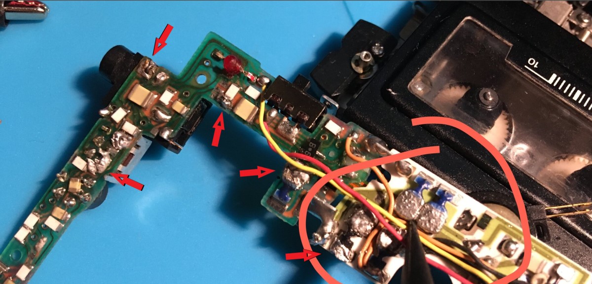

    Just an update about this case. Eventually I was able to make one fully working, out of 2. It still needs some details to be fixed, but it works very well and I'm so happy for it.

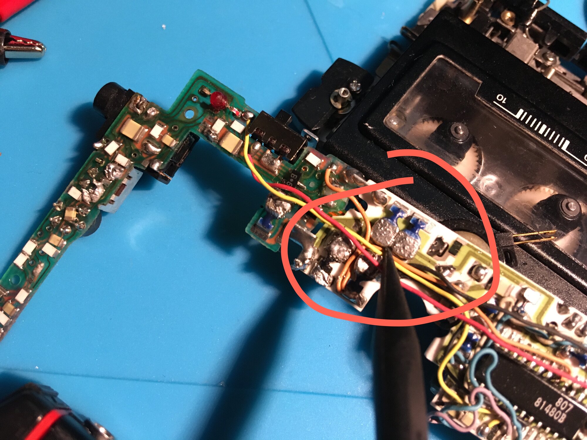

    Now, the second one is not in the same conditions of course, and it doesn't seem an easy fix. I found out that maybe there is a faulty component, thanks to the multimeter. I'm not so experienced but I'm comparing the circuit of this faulty one with the one fully working and one component doesn't make any ''Beep'' with multimeter, so I guess circuit is interrupted because of that. Anybody knows what kind of component is this one chrome and with blue feet? Is that a sort of capacitor?
    There are five in the upper side of the mother board and they are all connected each others except one. I tried to refresh the soldering but still no contact or signs of life. What kind of component it is? Basically there is no sound coming out from the recorder, at all. For the record, in the working one, all of the five components make their ''Beeps'' with the multimeter.

  7. Silver965
    Silver965 Well-Known Member
    721
    Torino
    Hello .. first of all congratulations for the work you do ..
    but in this case I would start to redo a couple of welds ... the point you indicate looks like two poorly made welds touching and the component is on the other side of the circuit ....
    If you look at the same circuit as the one that works I think that is not so like this
  8. macroPath
    macroPath Member
    32
    Slovakia
    Hi, thanks a lot!
    Yes I'm aware of the bad welds and were made by me very quickly actually, but this is after I found out the issue. I will make them better soon. Regarding the 2 components touching each others, I checked the working one and they are exactly in the same position and touching each others. So are they capacitors?
    Thanks
  9. Silver965
    721
    Torino
    Hi ... if they are capacitors ... I've never seen them like this ... if you touch the two pads with the test leads of the tester ... and they conduct cannot be capacitors
  10. macroPath
    macroPath Member
    32
    Slovakia
    Right, I see. In the working one they all conduct each others, but in the faulty one just one of those components is kind of isolated so I guess that's the issue.

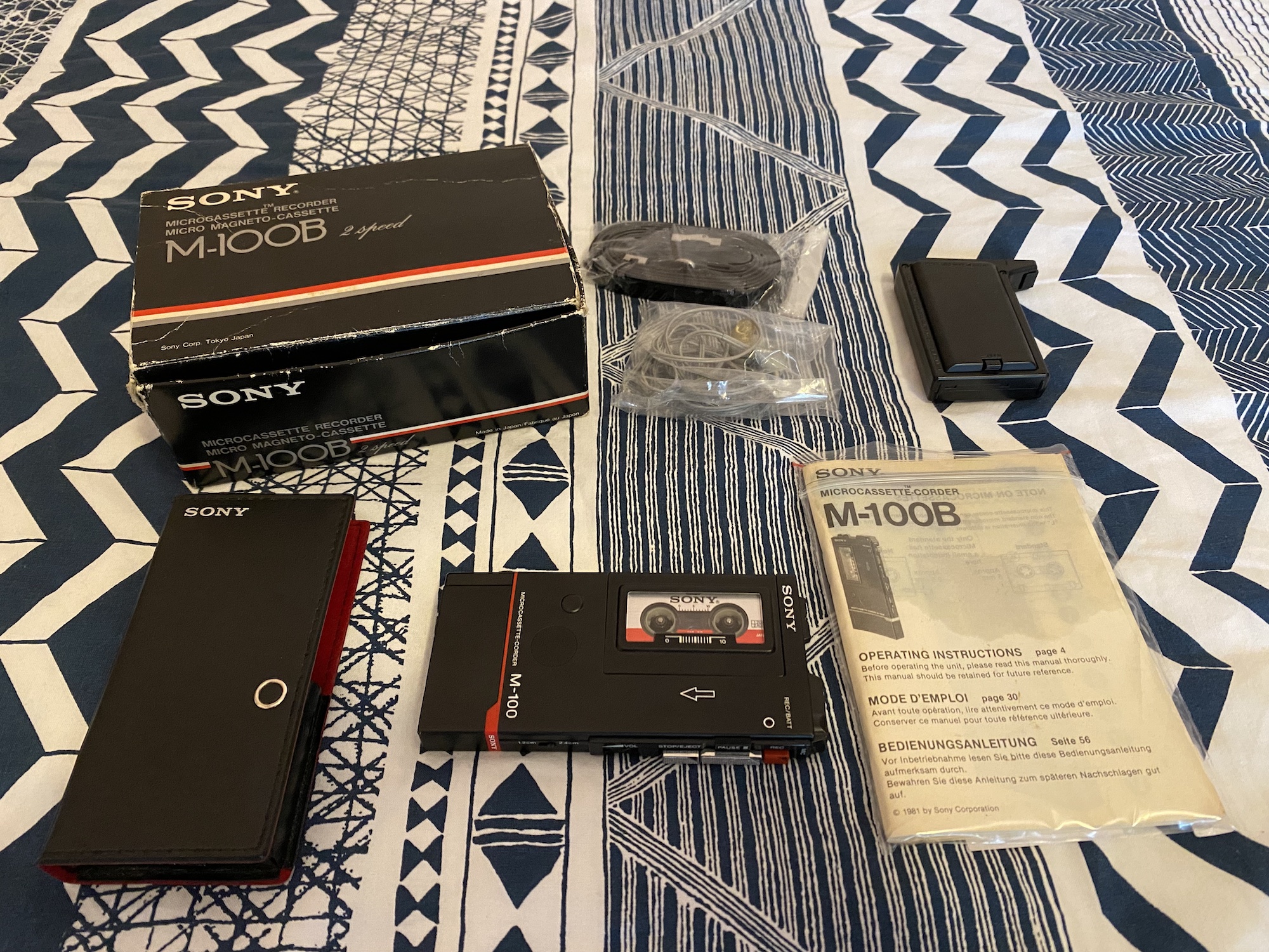

  19. enryfox
    enryfox Active Member
    288
    close to Milan (Italy)
    Here are some pictures of the unit ..
