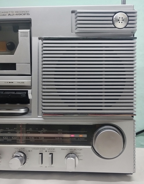

    Is this basically what a loudness button does on stereos (I remember it on an old car stereo and boomboxes) or is loudness a completely different thing?
    I did think loudness boosted low and high freq, maybe it was more a mid freq boost … I thought it made my old car deck sound better.

    But if it boosts low mid and high, isn’t that just a volume knob
  10. Radio Raheem
    1,961
    that is my response to mega bass question loudness can respond differently depending on what system you have and normally for low levels of listening normally it cancel's itself out at half volume on a good system, some loudness can boost bass and treble others just bass
