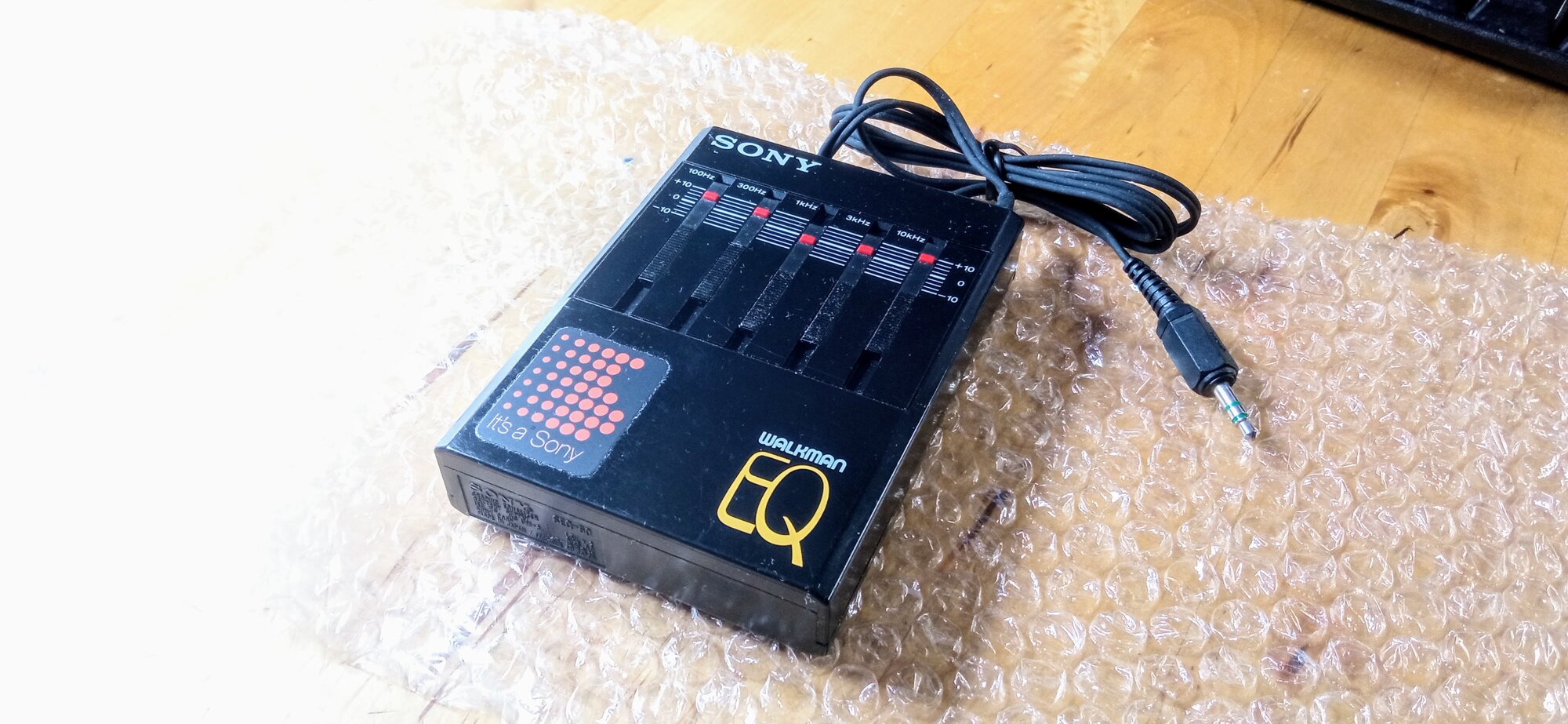

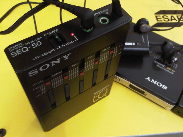

    Got a chance to bag a mint-condition SEQ-50 for a reasonable price. Always been curious/tempted to have one in the collection, especially as I love tweaking pb for different headphones.
    DBB is laudible on some Walkmans so I'd be interested in seeing if this will bring any sonic benefits.
    The only thing I'm concerned about is the lack of any gain compensation. I'm used to cutting or boosting gain depending on EQ settings so I would assume there will be some distortion if over-boosting certain frequencies. Or is compensation automatic/built-in with this device?
    Any owners of the SEQ-50 experience any distortion on playback?
    Anyone made any measurements?

    I have one of these. I found using it to be much the same as if the walkman you're connecting it to had a 5-band EQ - i.e. if you max the bass slider & push the volume, distortion will result, but only if you push it too far.
    As mentioned, the lowest slider is 100Hz so don't expect earth-shaking bass to be boosted with it. Also, it does introduce a very small amount of hiss when active. I did like the ability to bypass it, to compare your EQ setting with the original sound.

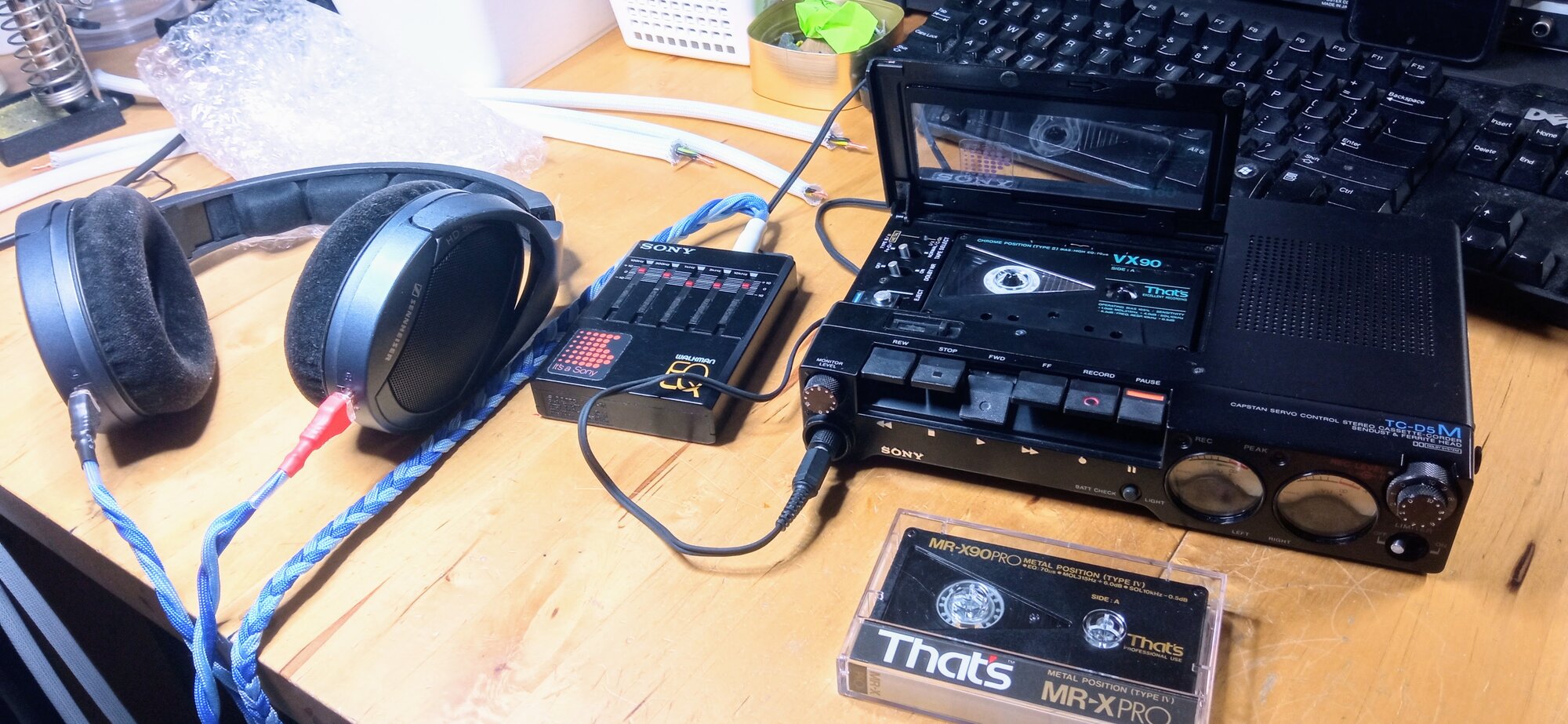

    Well, the search went on. Albeit a bit half-heartedly, until a couple of weeks ago and over 2 years after my search began when I spotted one on my weekly trawl using hi-fi shark.
    A '100% working, good condition' one advertised on ebay for €200. It's been a while since I've seen one on the radar for anything under that price point so I took the plunge and bought it.
    Couldn't be happier. It meets expectations and works great in combination with my various portable amps. Without an amp you're really at the mercy of whatever meagre device output you're using with the added caveat that the SEQ-50 does add a soupson of hiss as reliably reported by other owners.
    No problem for me however and when placed in the middle of the signal path between source and my Fiio Mont Blanc amp the hiss is actually diminished or hidden somewhat.
    Tried it out first on my TC-D5M and works great. Currently listening to some Ian Brown on my D3 and performs equally tiptop.
    I always wanted a bit of a bass boost using these portables aswell as a bit more control over the mid frequencies and the SEQ-50 really facilitates that admirably.

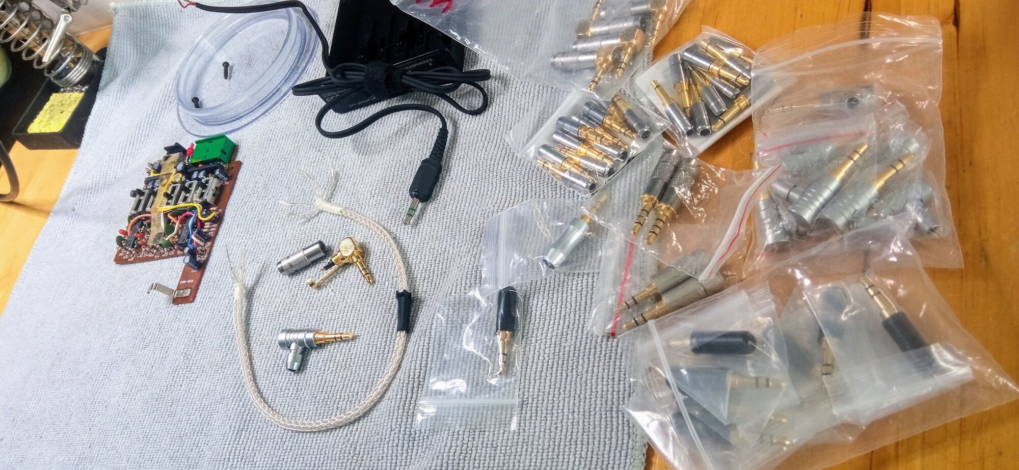

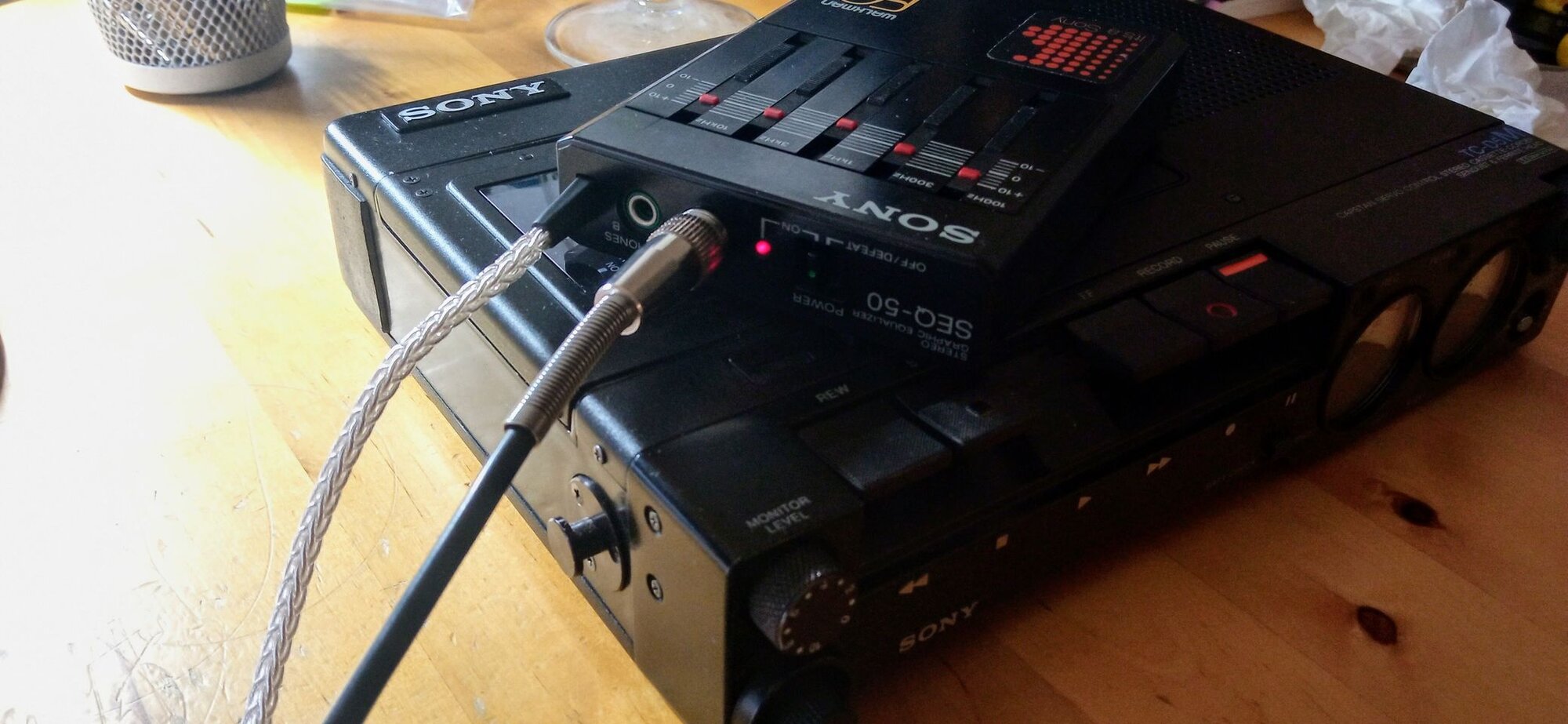

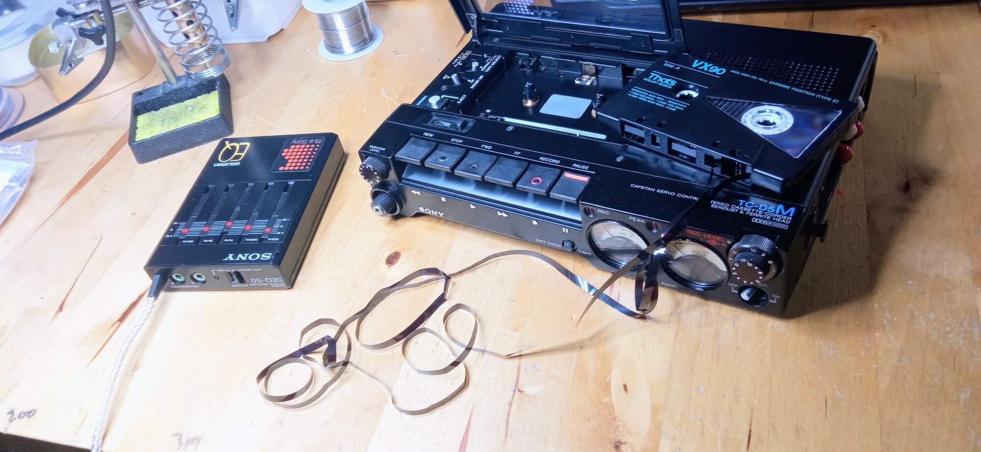

    I thought I'd get around to re-cabling the SEQ50 today.
    I've managed to find some reclaimed time via some small operational changes for my business. I'm now using printable shipping stickers which saves me a whole 4 hours a week based on current order levels and a new parcel pickup/dropoff station has opened right around the corner from me which also saves me a bunch time these days. Woo-wee!
    So I thought I'd use some of that saved time to do something nice for myself, lol.

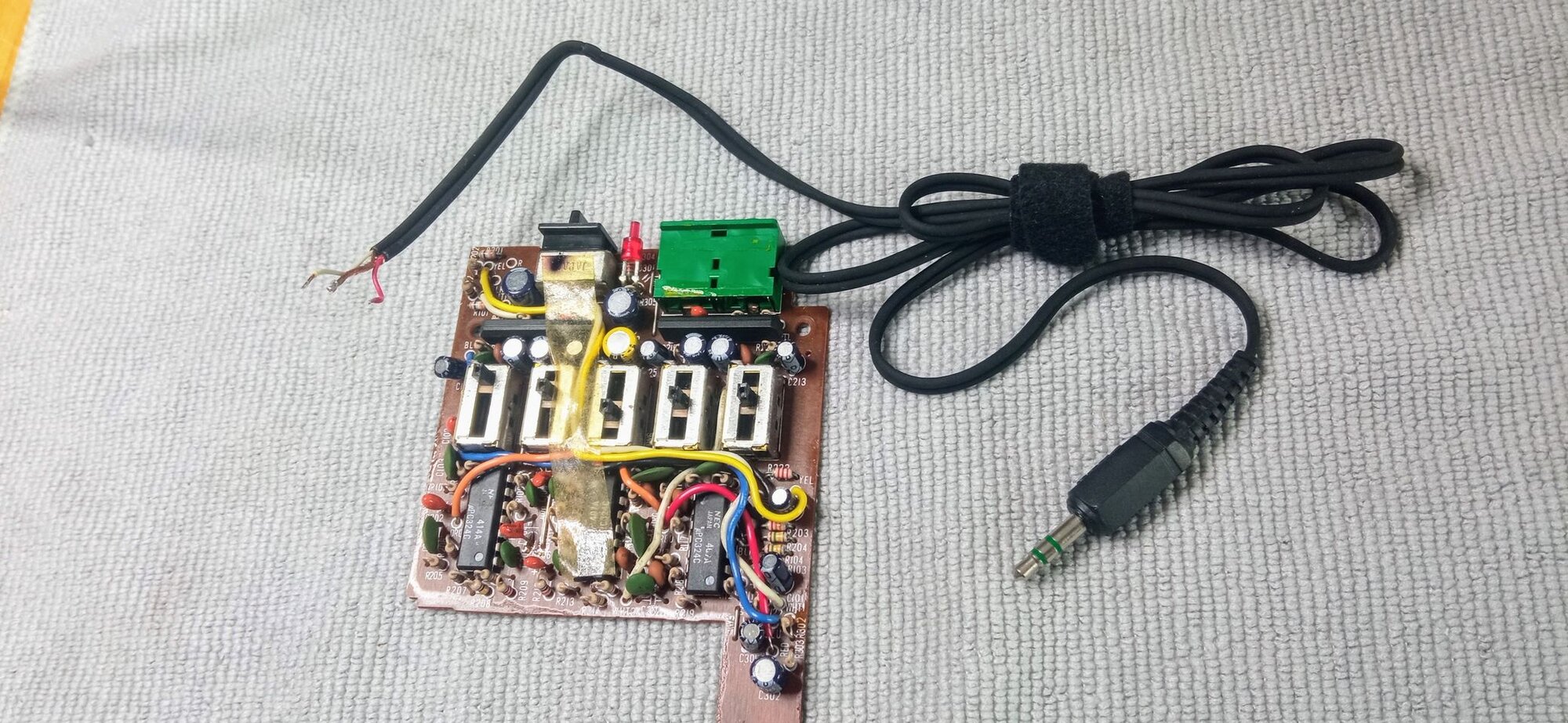

    The SEQ50 comes with a stupidly long and rather feeble-looking cable as standard and I wanted to replace it.
    I chose 8-core SPC as the capacitance value is ultra low for SPC which, contrary to what many people claim otherwise DOES actually make a difference within the signal path and the resultant sound signature.
    Anyway, let's get crackin' ....

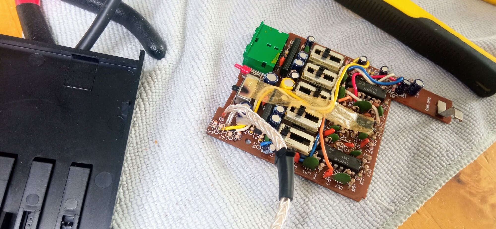

    Desolder the old sh!tty cable
    Choose a connector

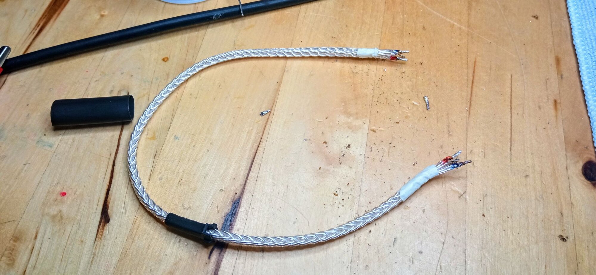

    Prep and tin up a length of 8-core SPC

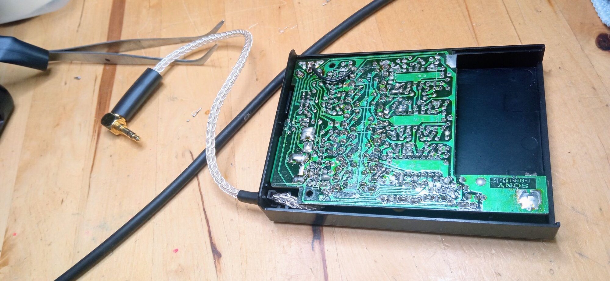

    Went with a nice strong angled-connector
    Terminate the other end to the board. 3 cores for each channel, 2 cores for the ground connection.

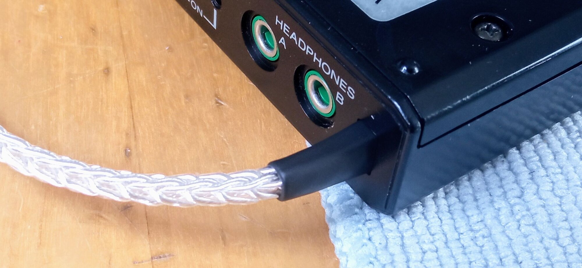

    It's a pretty tight fit for the cable to sit between the case and board but we're in, like Flynn :D IMG_20250408_172959_1.jpg

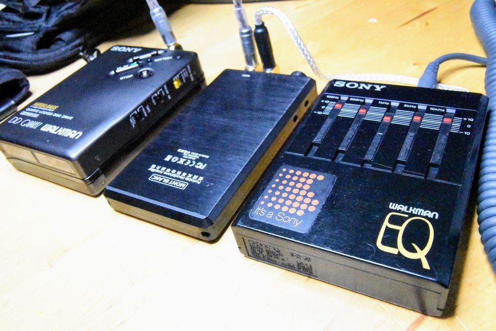

    Used the original cable-grommet and it's a nice snug fit
    Moment of truth; sounds tip-top! Seems to be a lot less hiss than before too. A definite upgrade!
    It wasn't all plain-sailing though - I managed to bollocks-up the LED as it doesn't light up anymore. Maybe I need to resolder the connections. I'll have a butcher's later...
    EDIT:
    A butcher's later and I have managed to fix the LED.
    (Butcher's hook = look, for those not au fait with the Cockney vernacular)
    While I had the case apart again I also placed a small amount of silicone grease on the plastic tracks of the EQ band sliders as I thought they could be a bit smoother. Well worth it as the're now as smooth as budderrr :D
    EDIT EDIT:

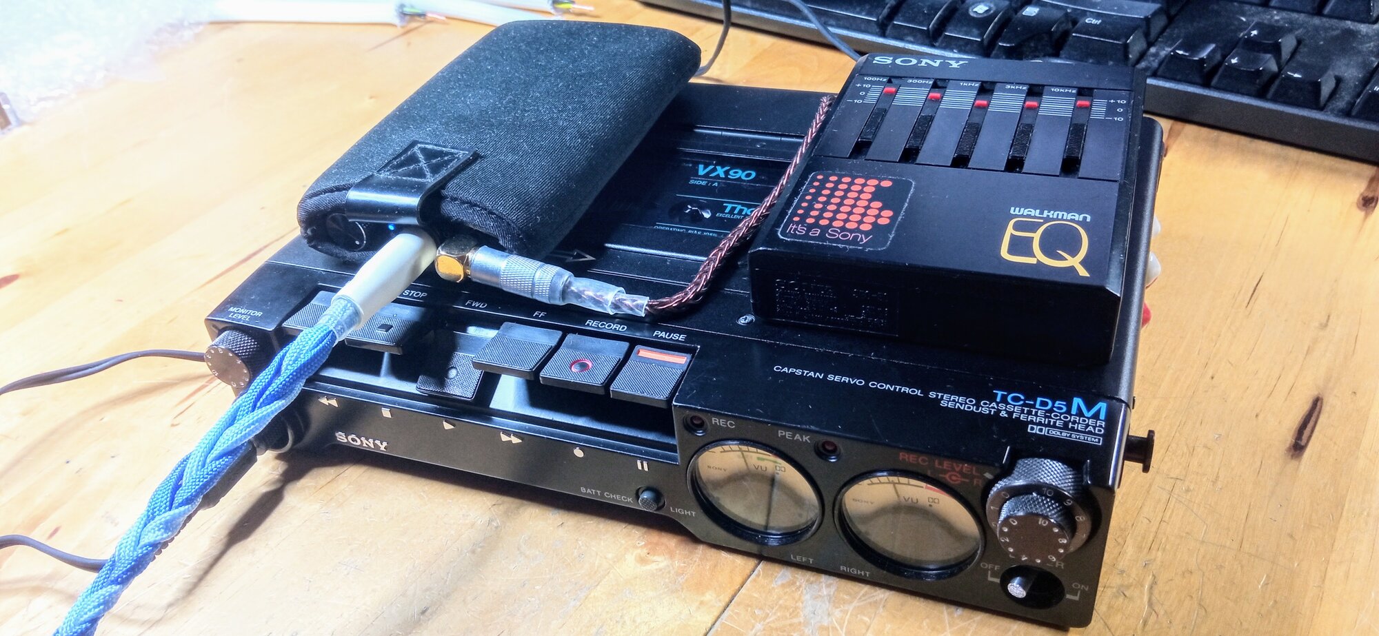

    Well, I think this is my D5M's way of letting me know that it objects in the strongest possible terms to being EQ'd. Harumph!
    :D
    Hyperscope, Mister X and isolator42 like this.
  15. Chris_D
    Chris_D Active Member
    150
    Netherlands

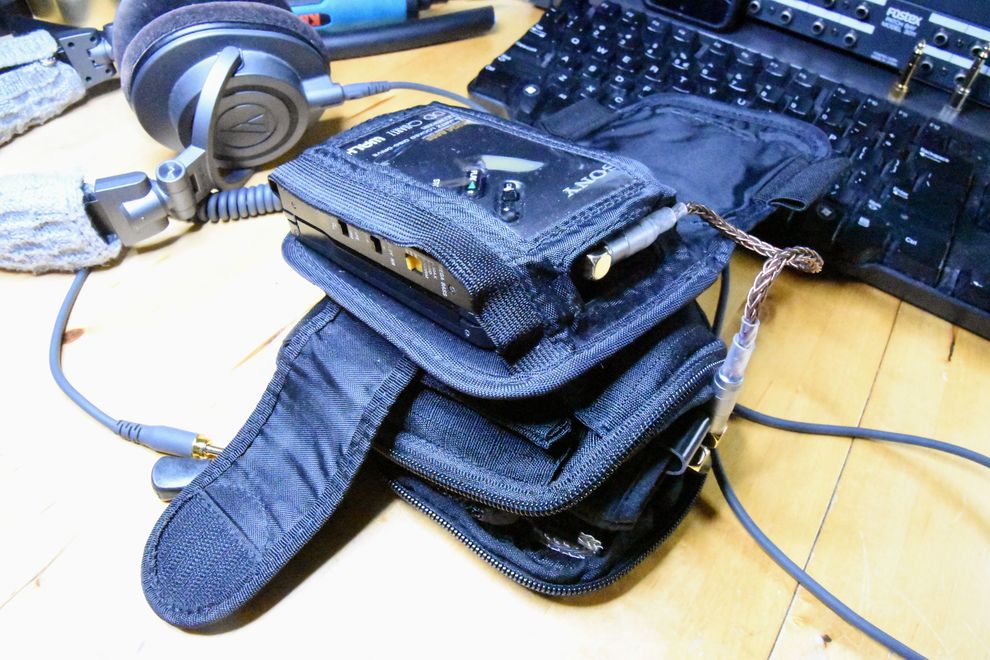

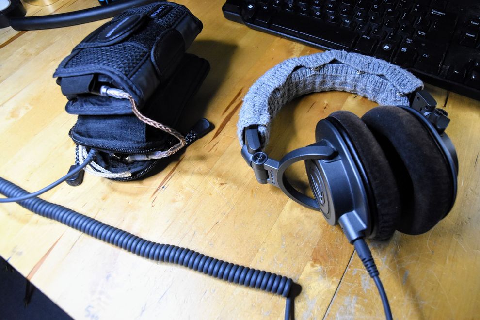

    It turned into one of those over-complicated Walkman/EQ/amp combo's.
    It does sound pretty epic though. Wonder if it will all fit in my pocket. I suspect not :D
