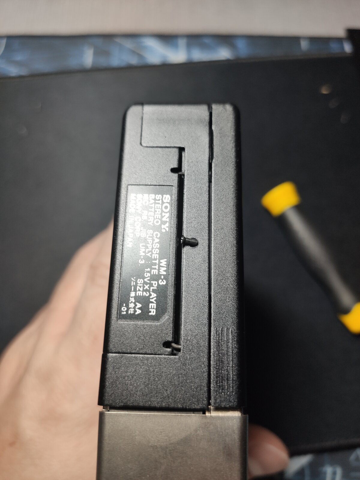

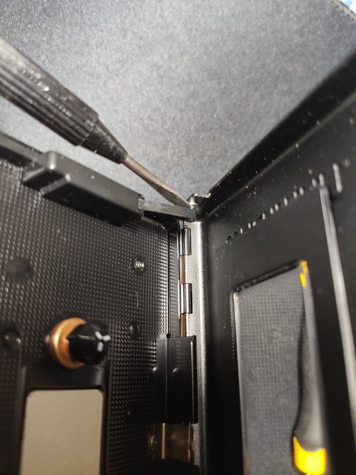

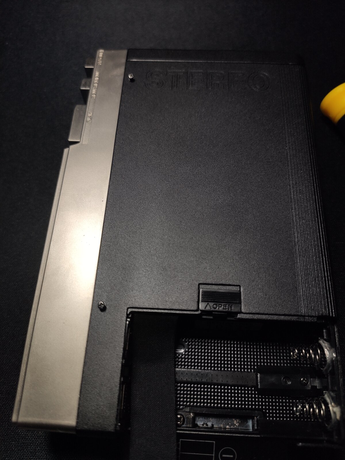

    DISASSEMBLY:

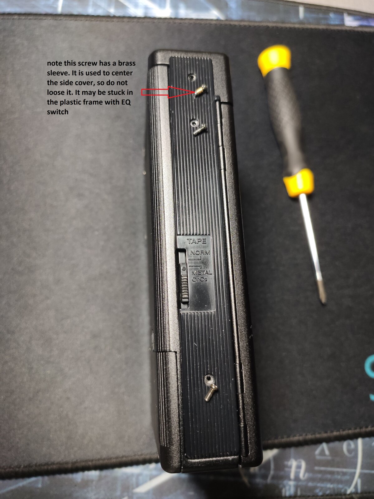

    1. The plastic back plate needs to come off first. Note that there is a brass sleeve on the screw near the side cover. That is used to align the side to the rest of the case, so do not loose it.
    2. Next, the 3 other screws holding the back cover can come out.

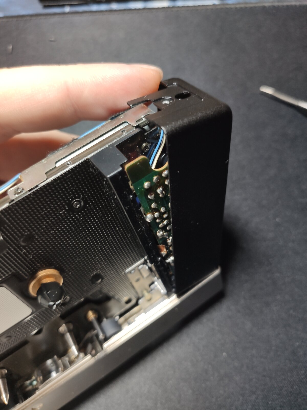

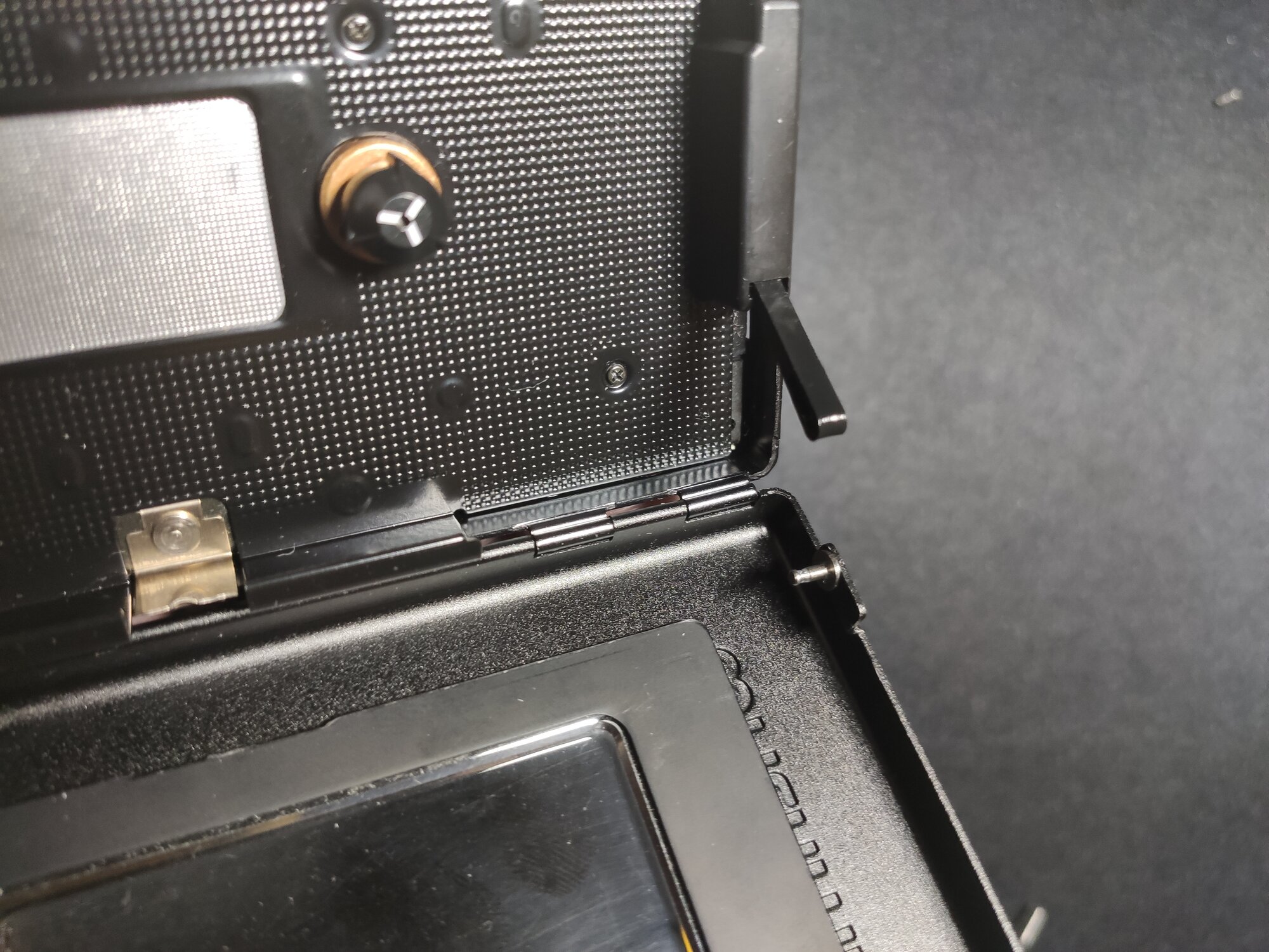

    3. The cassette door lever needs to come out.
    4. Carefully take the back cover off; the battery door will also come off at this point.

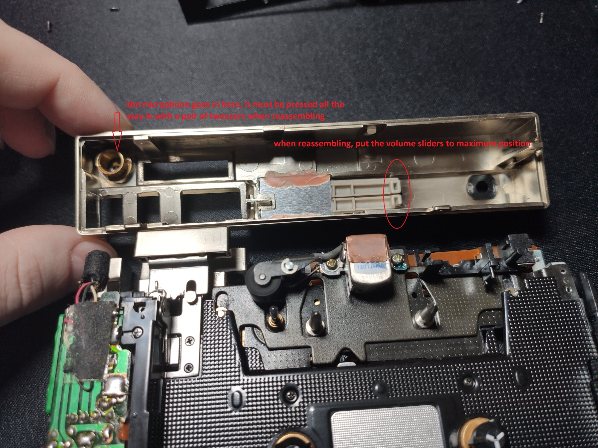

    5. Take off the side cover (the one with hotline switch), by rotating it.

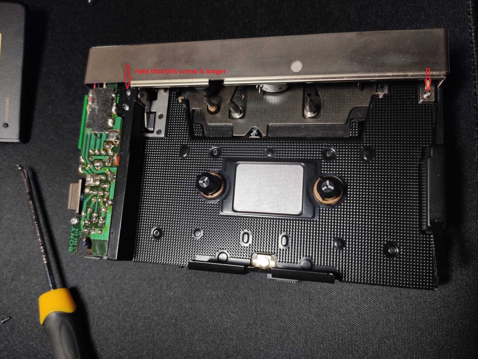

    6. Take off the front panel (note one of the screws is longer).
    The volume buttons will come out and the microphone might be stuck to the case. Do not force the front panel out, take it out 1cm or so and pry the microphone with a pair of tweezers.

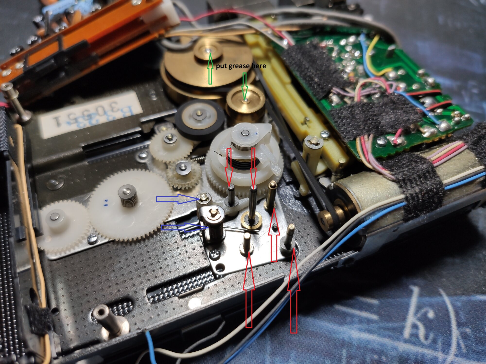

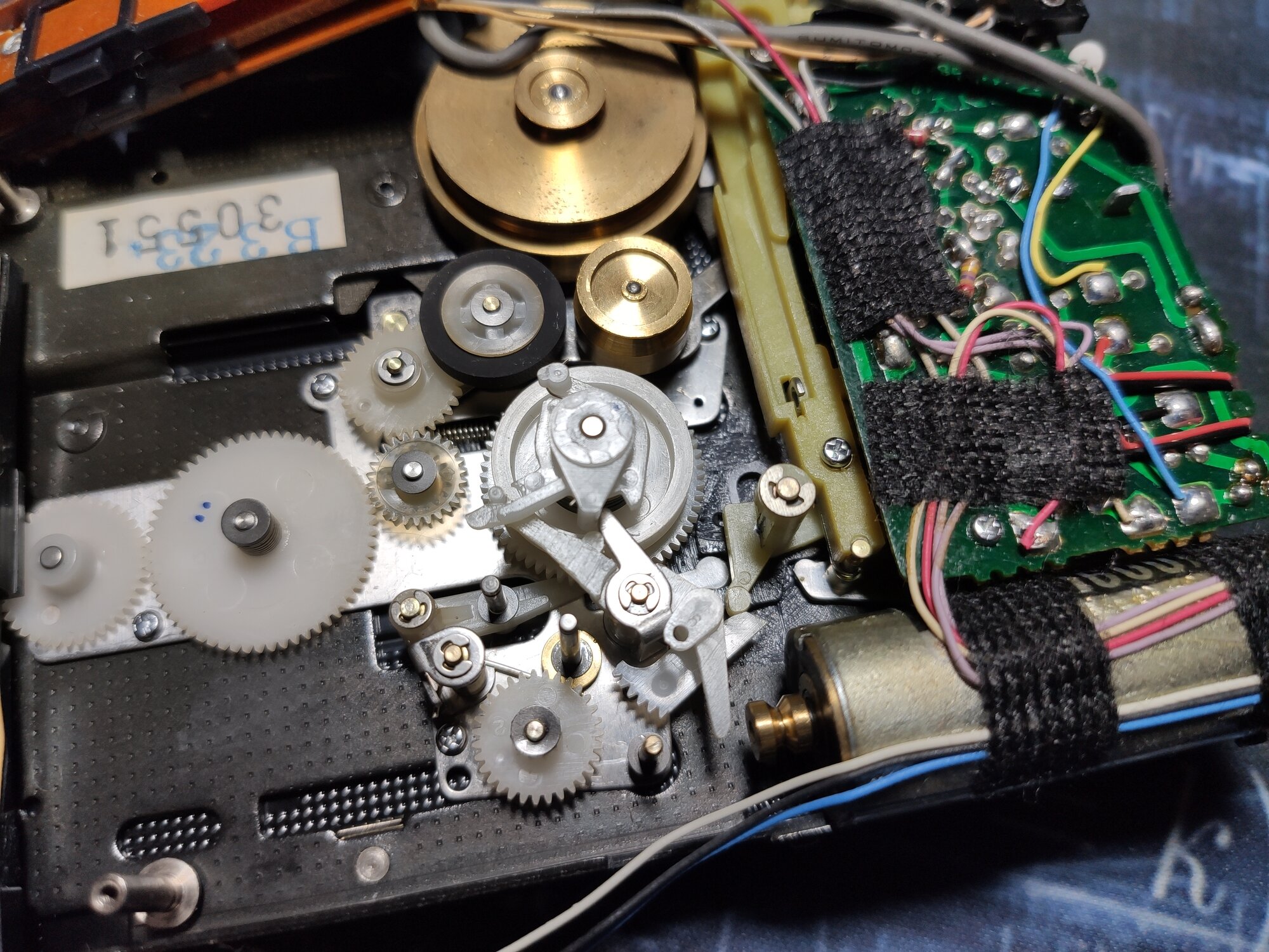

    MECHANICAL REPAIR:

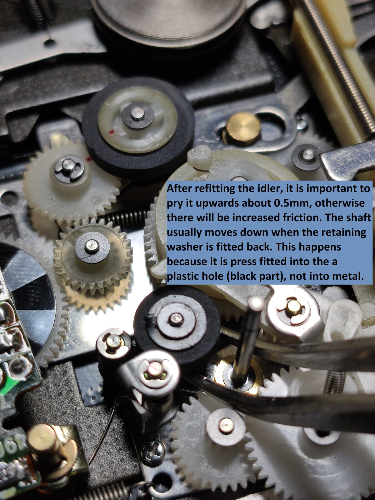

    NOTE: most pulleys and gears that need to be taken out have black washers. You need to pay attention as they are very important in reduction friction and hence wow&flutter.
    Most points indicated here must be lubricated with oil. Avoid using grease in general, because most greases tend to harden over time, especially when the unit is not used for a very long time. I recommend using watch oil, but other general purpose mechanism oils also work.
    1. At this point, you can replace the pinch roller.

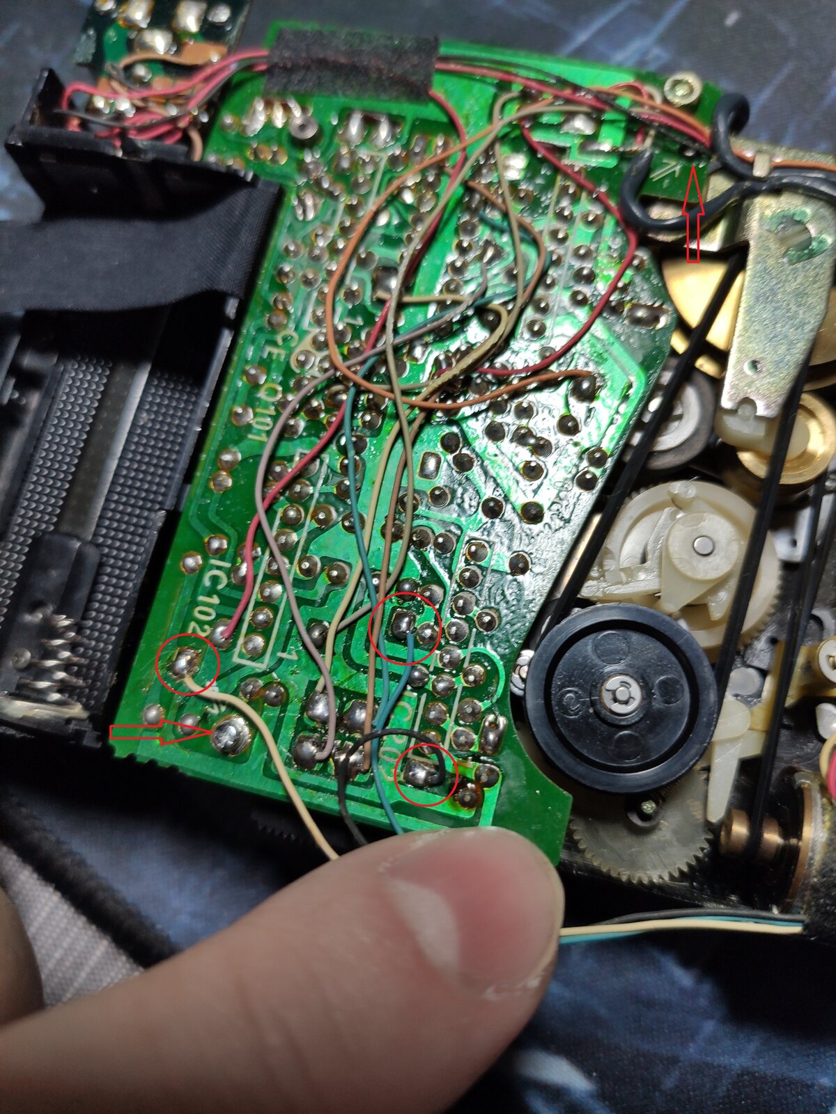

    2. The main PCB needs to be folded over; in order to do that, desolder the 3 marked wires and remove the 2 screws.
    3. Now you can remove the flywheel bracket in order to remove the belts: you need to remove 2 screws. Note that the one near the play button is longer.
    4. Take out both flywheels. Note that the big one has 2 washers on the shaft. They're very important for wow&flutter, so do not loose them.
    5. Take out the black plastic pulley. There is a small white gear below it: remove it.

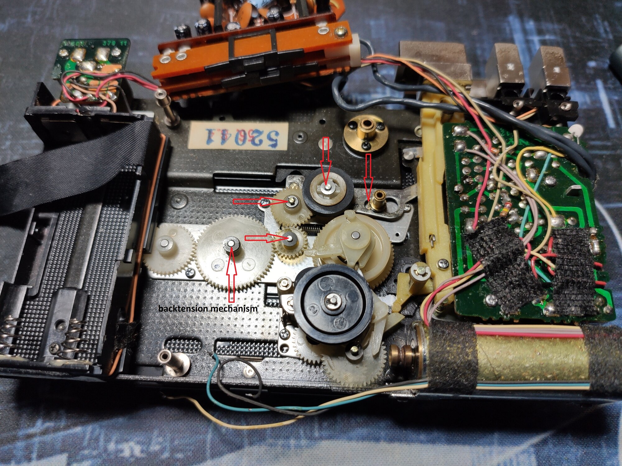

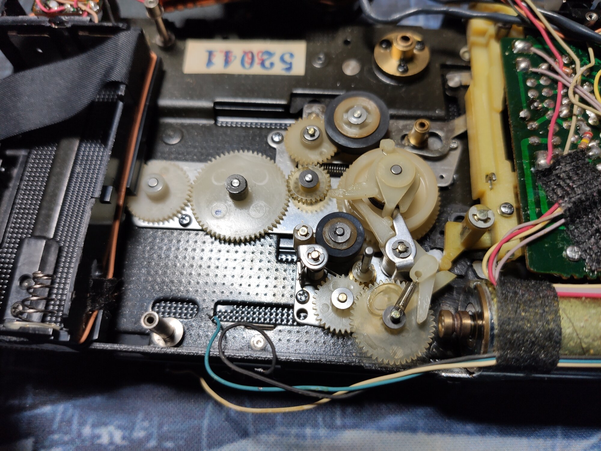

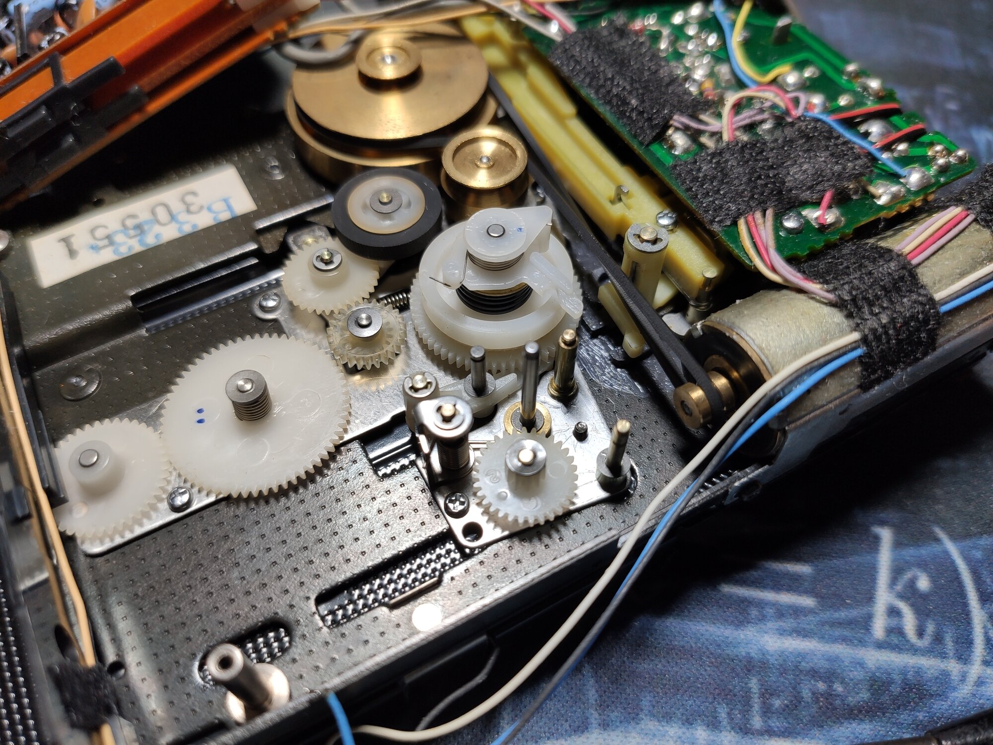

    AUTO-STOP MECHANISM
    The auto-stop mechanism is the main source of wow&flutter in this type of mechanism. The cam gear creates an uneven load; because the unit is belt driven, the servo cannot fully compensate for this and the drop in speed is trasmitted to the flywheel and capstan, creating a rhytmic wow once every couple of seconds (when the cam engages). The phenomenon can be attenuated considerably if all the moving parts are lubricated correctly and move freely.
    FF/REW MECHANISM
    Depending on how the unit was stored and how much it got used over the years, the FF/REW can get completely stuck by old grease. That is why I recommend cleaning all the shafts from old grease and relubricate them with oil. This is not related to the wow&flutter, but it can decrease the winding torque.
    BACKTENSION MECHANISM
    High backtension is another source of wow&flutter. It is better to be on the low side than too high. Too much backtension will also wear the head more.
    The supply reel should have just a little bit of resistance, you should be able to rotate it with a single finger without applying force.
    A torque meter is not necessary, as you are not adjusting anything, just making things rotate more freely. Just "adjusting" the backtension can lower the wow&flutter by as much as 0.05% WRMS.

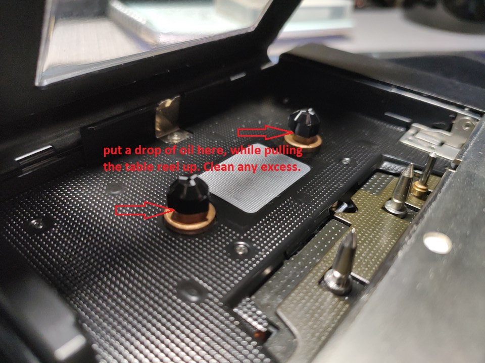

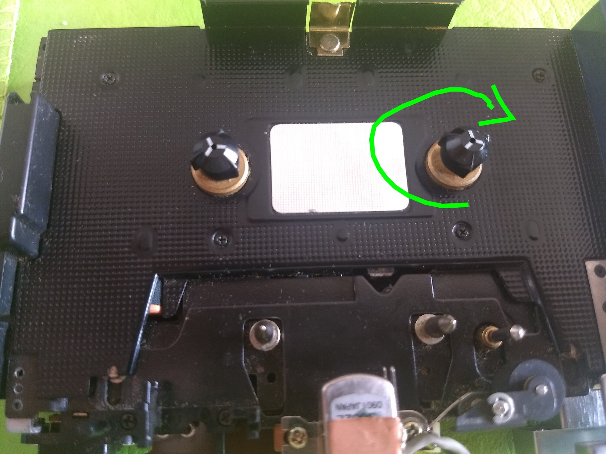

    TABLE REELS LUBRICATION
    On all SONY cassette machines (including DAT), the table reels tend to turn hard because of old and incorrect grease used. Note that the grease needs to be replaced with oil.
    I do not recommend disassembing the table reels, as they can be lubricated without even disassembling the unit.

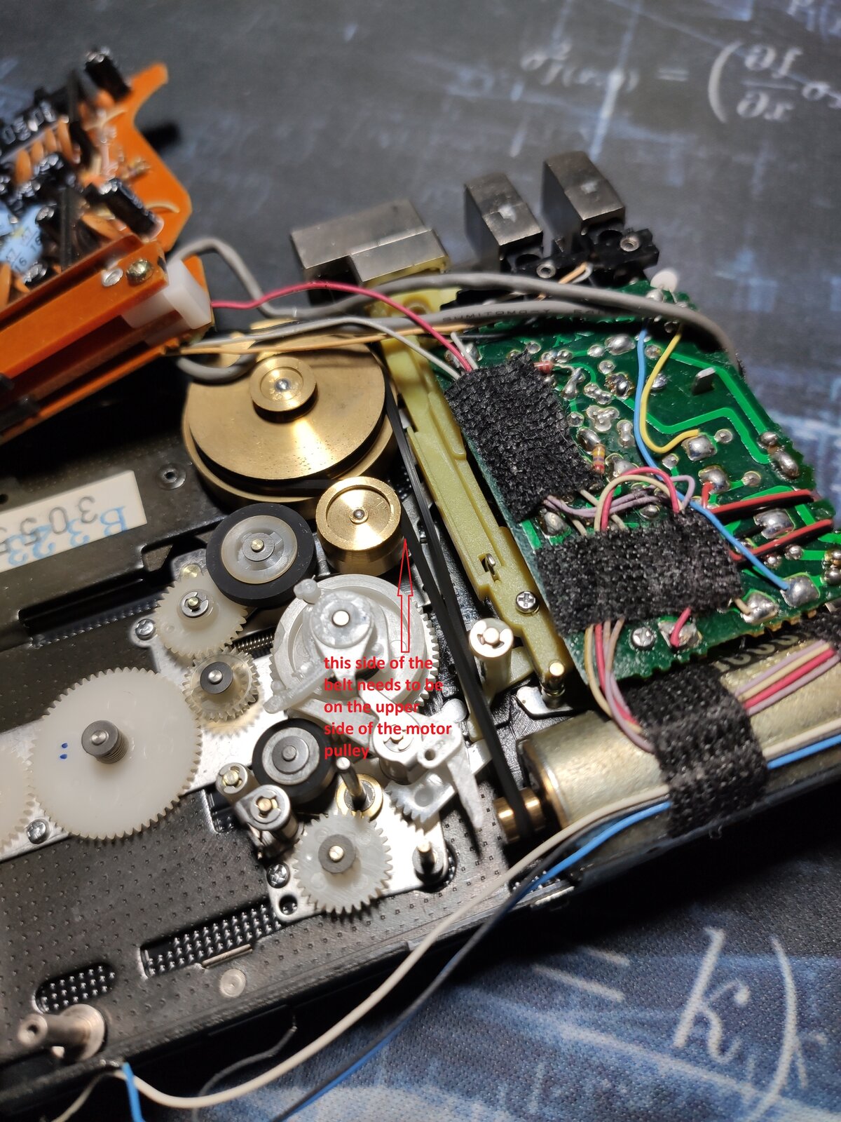

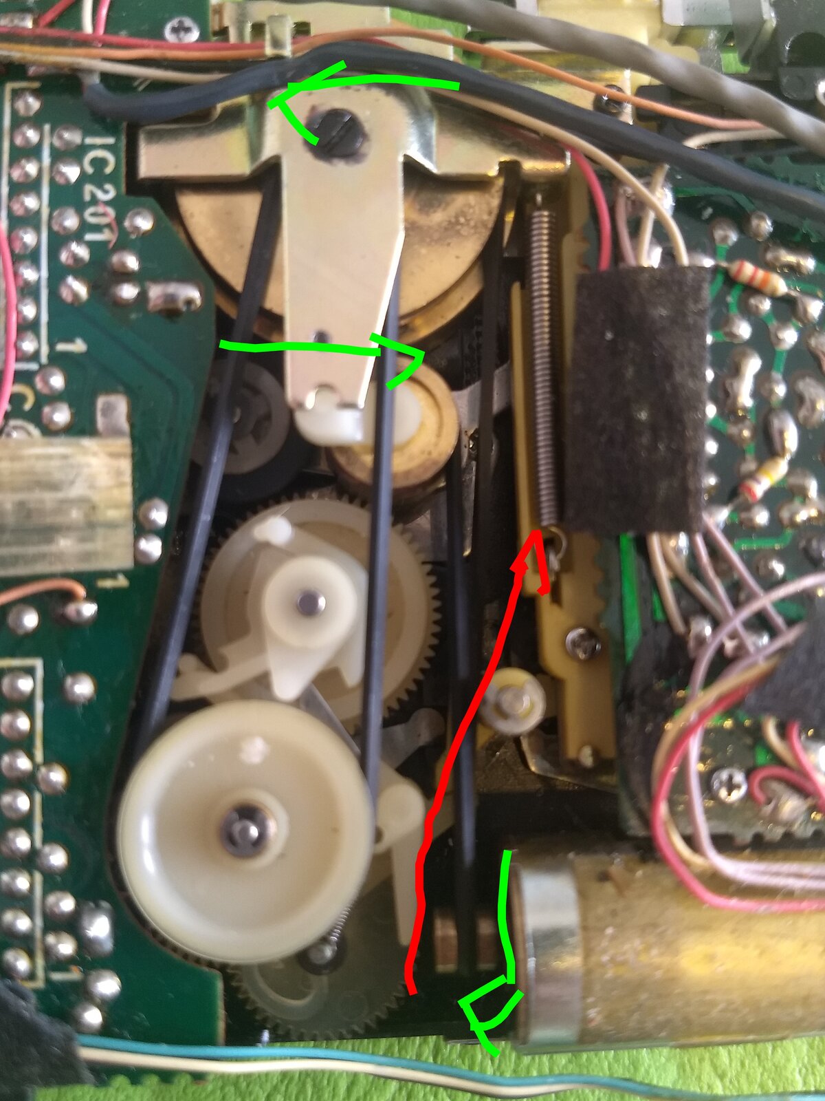

    I bought new belts and for some reason if I install the longer belt as showned in the pictures of thia guide, on the upper side of the motor pulley, the walkman eats all the tape.
    In every youtube videos the belt is installed as showned in this pictures.
    so the question is what could be the problem?

    Are you sure your motor wires are soldered correctly ? Maybe your motor is turning backwards. When belt is installed backwards, the takeup reel will turn in reverse, so it will be very obvious you did something wrong.

    The motor turns clockwise. The walkman was never opened before. At least as I can tell, no signs at all.
    Is it possible that the engine had switched polarity as times goes by?
    When I opened the case for the first time the motor was not even turning on, so I cleaned it with IPA and keep turning by hand until suddenly started to roll again.
    Edit:also, the color wires on the board matches the color in the pictures, red on left, white on right.

    Just cheked the WM-3 in my collection: the belt routing is correct as its shown in pictures, however my motor turns counterclockwise.
    So the solution is to solder those white and red wires backwards. And to answer your first question, it's not possible that the motor changes direction of rotation in time.
    It's either that the motor was replaced at some point and wires were not soldered correctly, or the 2 wire colors are inverted: an error at the factory when assemblying the motor.
    At the end of the day it doesn't matter which one it is, the idea is motor should turn counterclockwise.

    @Valentin You mentioned up above to use oil instead of grease. BUT in the image below you wrote 'put grease here'. What 'here' means, on the shafts of those brass parts (green arrows) or all the shafts you indicated with arrows?
    Also you specifically said to use oil on every shaft.. So, I'm a bit confused - which one is it?

  15. Valentin
    1,676
    To be clear, by "shaft" I'm reffering to the part of the shaft that rotates inside a bushing. What is marked with red arrows are shafts.
    What's marked with green is just a small contact point between the flywheel/capstan assy and the thrust play adjustment screw.
    Hence this small contact point is not contained (not inside a bushing) oil will not stay there. It's why grease must be used where green arrows point at.
    That's why I specifically marked the green arrows with "Put grease here" and made them a different color to point out there is a difference between that point and what is marked with red arrows.
    Looking at the video, that's bad. Speed is low and W&F is all over the place, sign that there's a lot of drag somewhere in the mechanism.
    You stated in the beginning motor was seized. Have you lubricated the top bushing of the motor ? If not, start with that.
    Also try to rotate the mechanism by hand and identify if there's something which is very hard to turn.

    Understood. Yeah, the motor was seized and I did lubricate the top bushing with a sewing machine oil (low viscosity). I'll do all the rest tomorrow and let you know what the result is.
    What kind of grease do you recommend for the application?
    Thanks
    Cassette2go likes this.
  17. Valentin
    1,676
    White lithium grease, although type of grease used on these points isn't critical.
