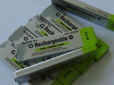

    My Sony WM-EX7 is a beauty of a player, but I have not used it for several years until now. Seems that the two original GumStick NiCad batteries will not hold a charge, so I'm seeking a source for newbie or new-old-stock NiCad Batteries.
    Does anyone at the forum have experience and/or best sources for Sony NC-6WM rechargeable NiCads?
    Merci

    Hi there. I have one of these batteries that came with the Sony ex-615 walkman. Never used it. Tried to charge it and now i get 4 hours play. What i'm saying is- try charging it up in an external charger. It may only charge for 10 minutes. Take battery out of charger and try it in the wm. If no go charge again and keep trying several times as long as the battery is not swollen. I also did this on some Sony 14 rechargeable batteries that had never been used for many years and now i get nearly 6 hours of playback from them. Dont give up after the 1st charge but do keep an eye on the battery. Use a charger with light indicator- good luck.

    I purchased a HQRP NiCad battery via eBay.Com. Cleaned up the walkman player battery contacts, poped in a C-60 cassette, all is good now.
    I'll tinker with and recharge the orig Sony gumsticks too, always good to have backups !
