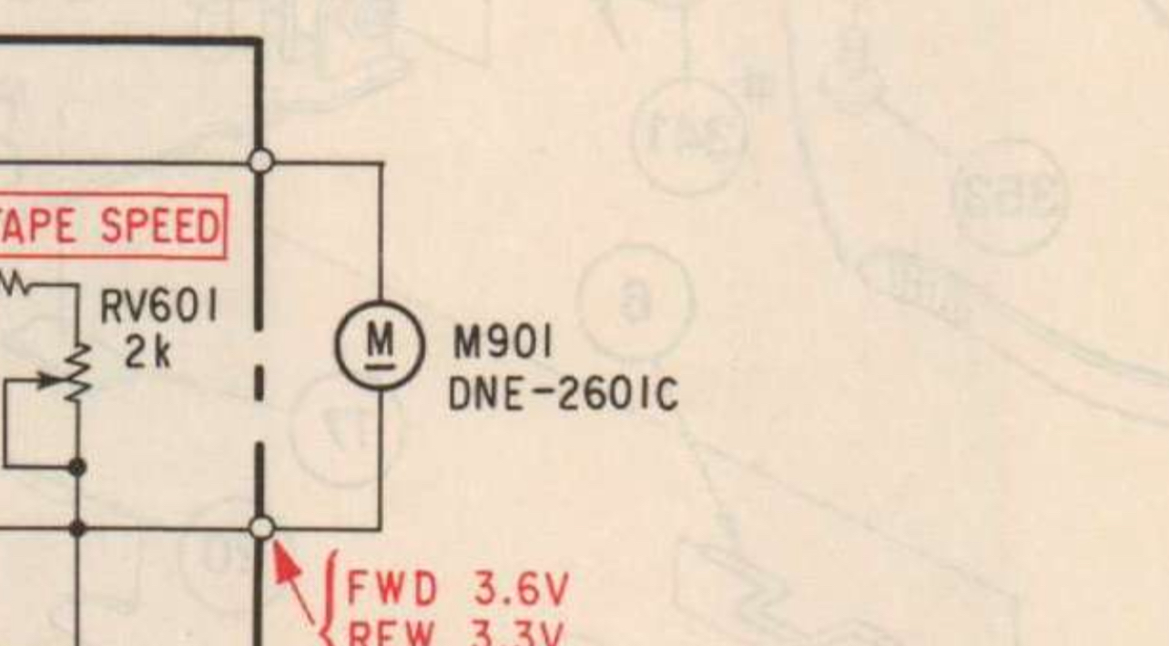

  2. Emiel
    1,061
    Hi Ant,
    I noticed we did not cover it yet on WML.
    Here is the service manual: https://elektrotanya.com/sony_wm-1_wm1_sm.pdf/download.html#dl

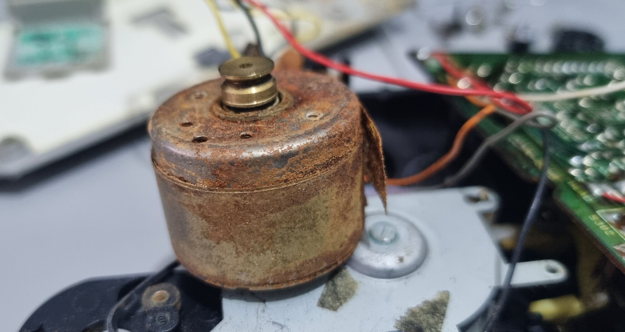

  5. Ant Cross
    Ant Cross New Member
    24
    UK-Liverpool
    Don't know what has happened to it but its very corroded and completely seized up!
  6. Valentin
    1,676
    That motor looks bad, I would simply replace it with another one.
    While it might be repairable with a lot of work and patience, I don't think it's worth spending the time on this one.
    Would be useful to get a manufacturer part number for the motor, as I'm pretty sure the motor isn't actually manufactured by SONY but by a 3rd party.
    With that code, it will be easy to search for a new replacement in the same form factor and similar characteristics.

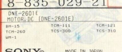

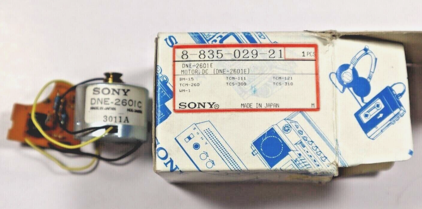

  8. Emiel
    1,061
    Valentin likes this.
  9. Ant Cross
    24
    UK-Liverpool
    Yeah I saw that - no shipping to the UK though, and even if there was $30 + shipping to UK, prob not worth it for my not so perfect WM-1
