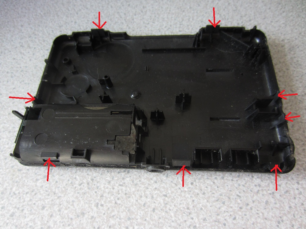

    Once I had worked out how to unclip the back (there are no screws at all just clips in the positions shown)

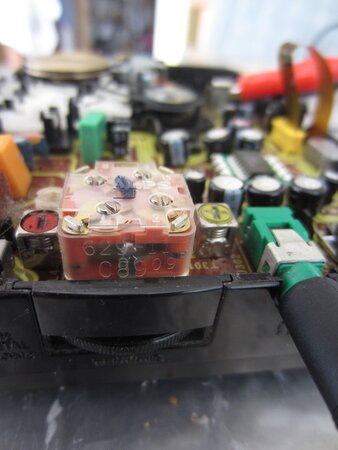

    When the back is off make sure you don't loose the tuning knob cover which just slides into slots.
    If you remove that, and disconnect the tone control flexi cable by lifting up the clip on the yellow connector the the board / mechanism can be lifted straight out of the case.

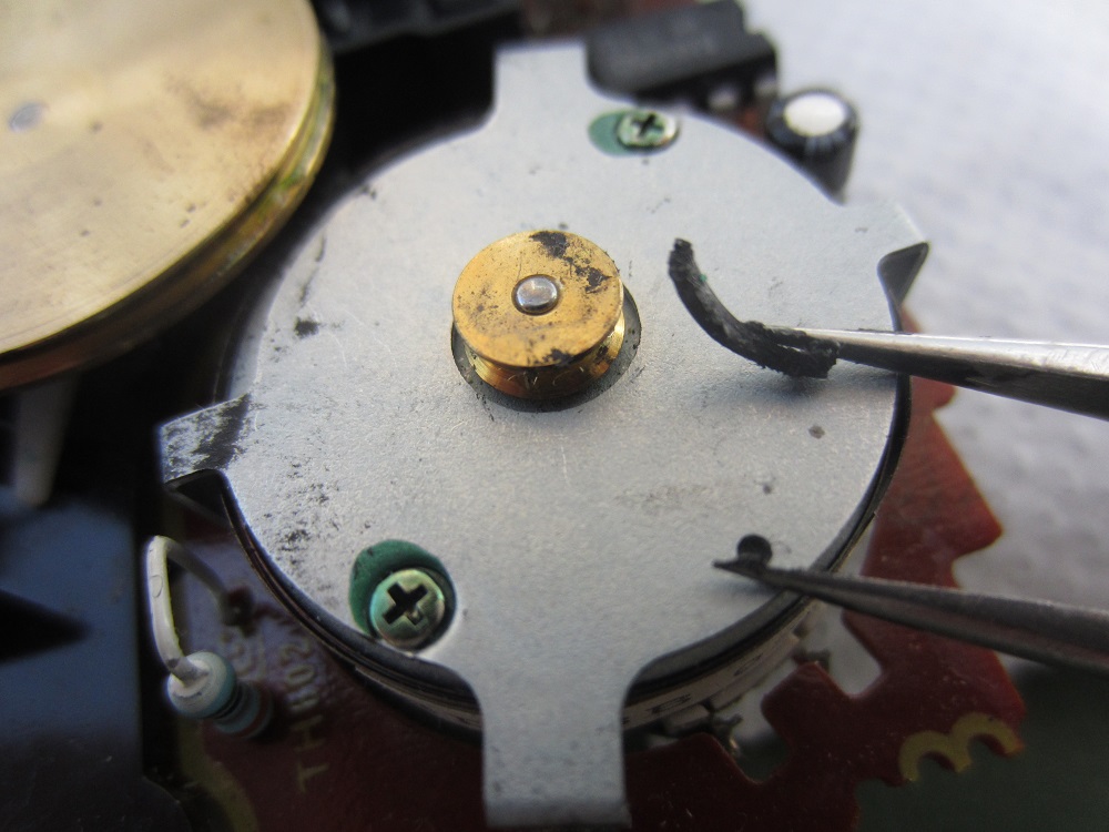

    After ordering a new set of belts (for more than I paid for the Walkman) and some IPA to clean of the goo,
    I spent along time cleaning off the goo then fitted the new belts. Disappointingly I found it was running very slow and the balance was off.
    Having bought the new belts I did a few searches on eBay and found another WM-BF49 "Buy it now" for less than £10 inclusive so bought that. Opening it up I found that like the first the belts were sticky goo. This time I bought a set of tweezers to help remove the remains but it still took about 30 minutes.
