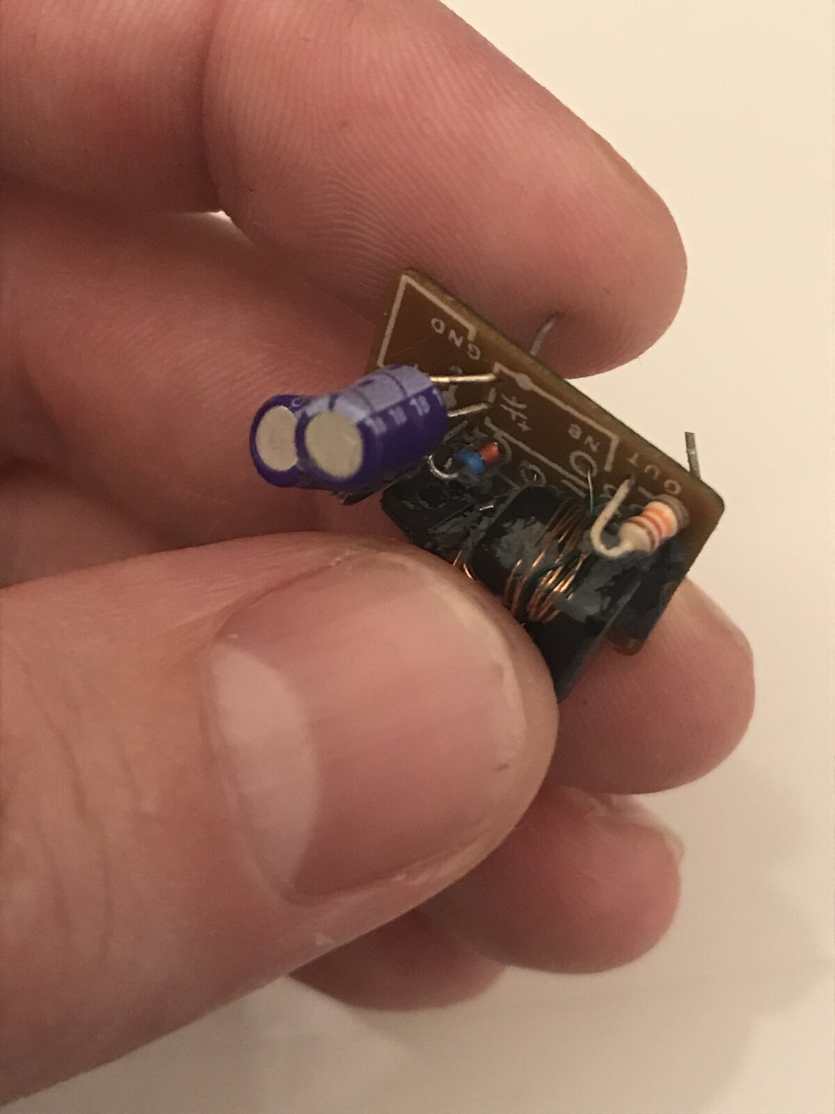

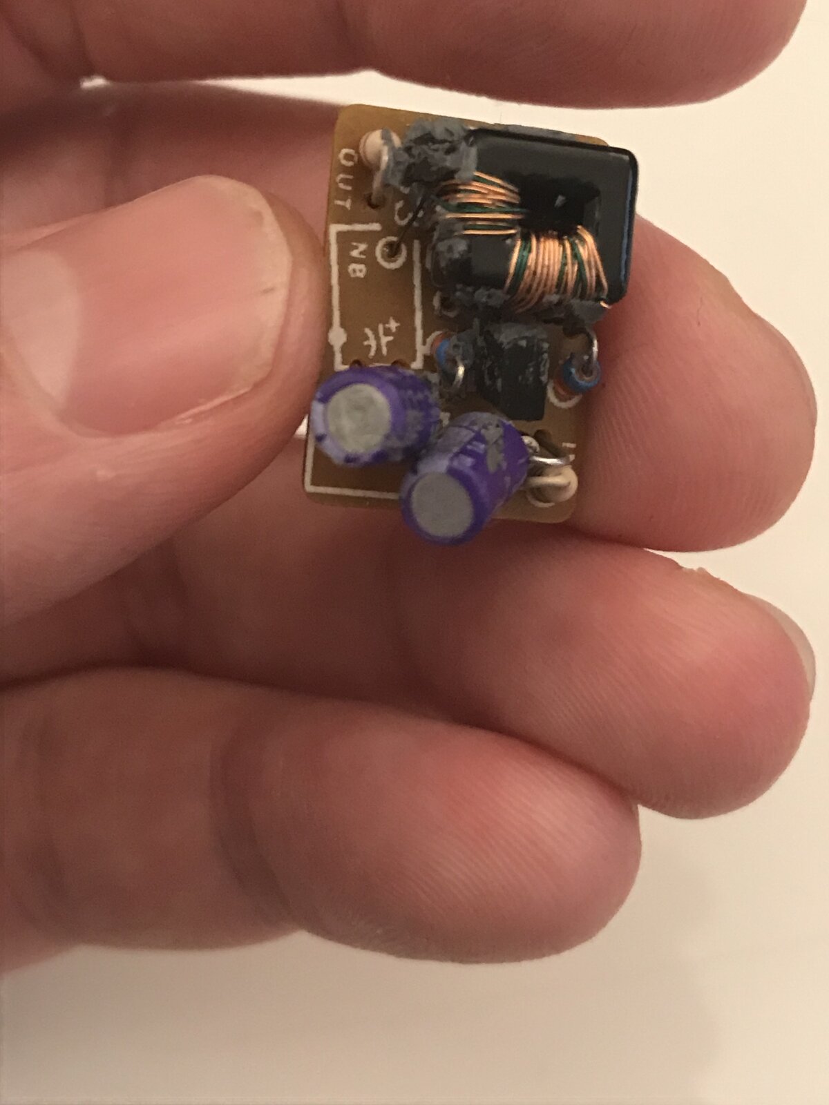

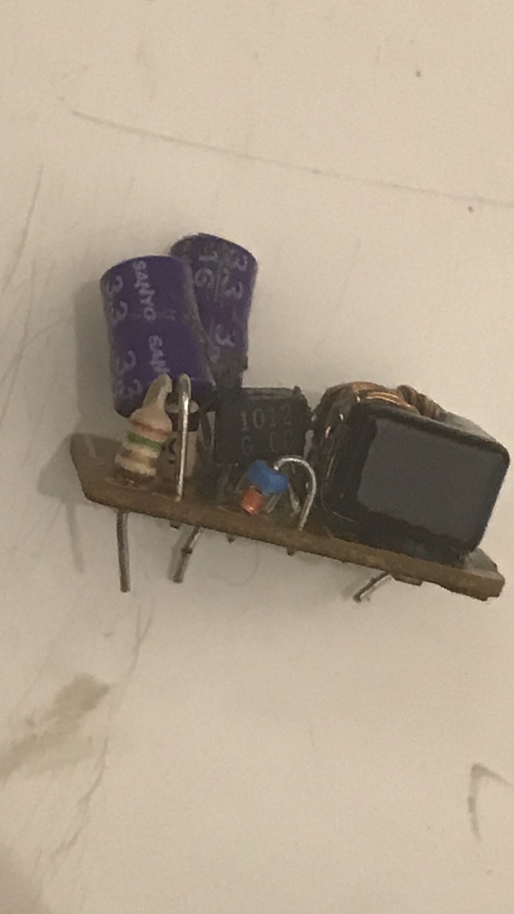

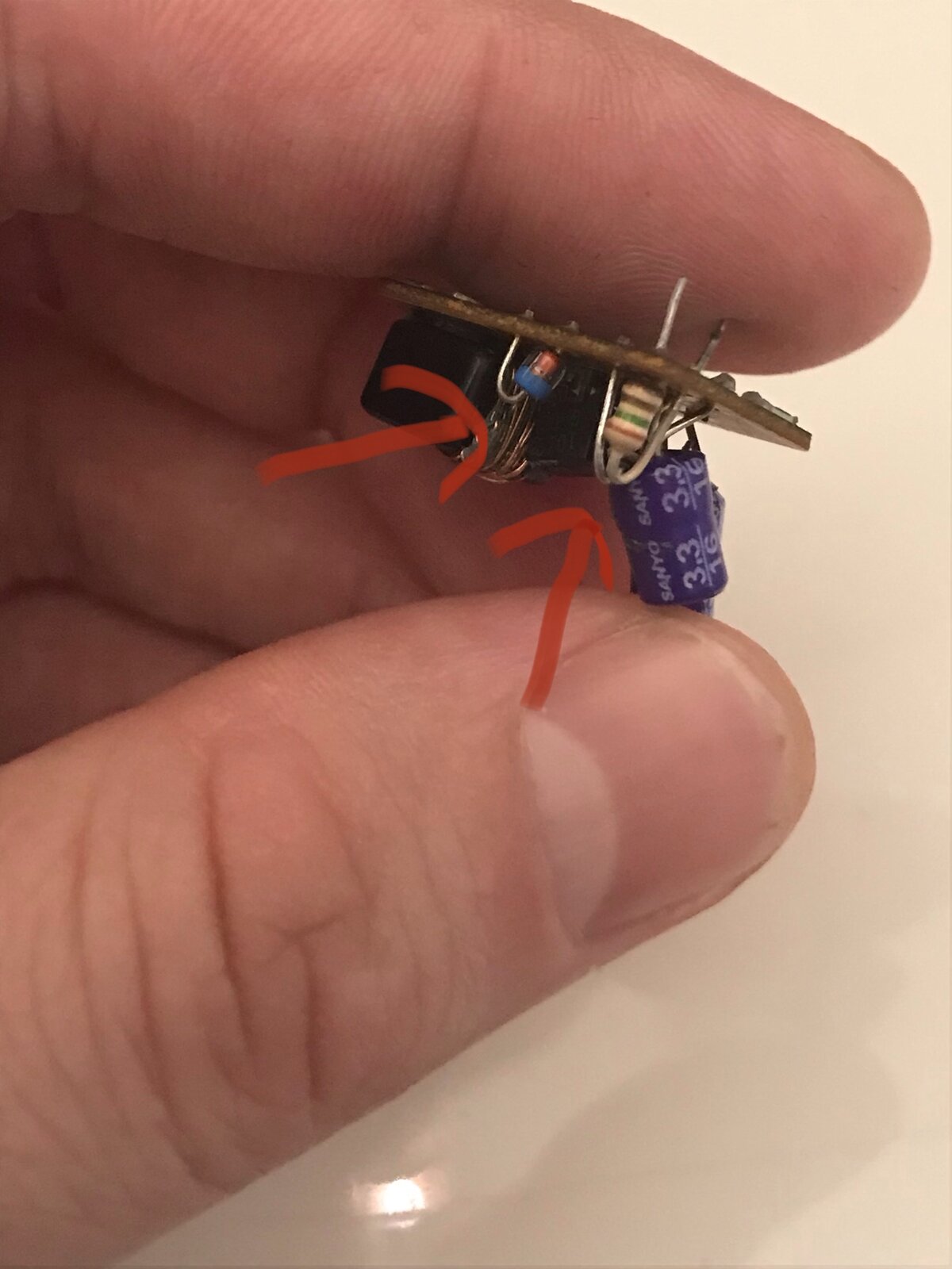

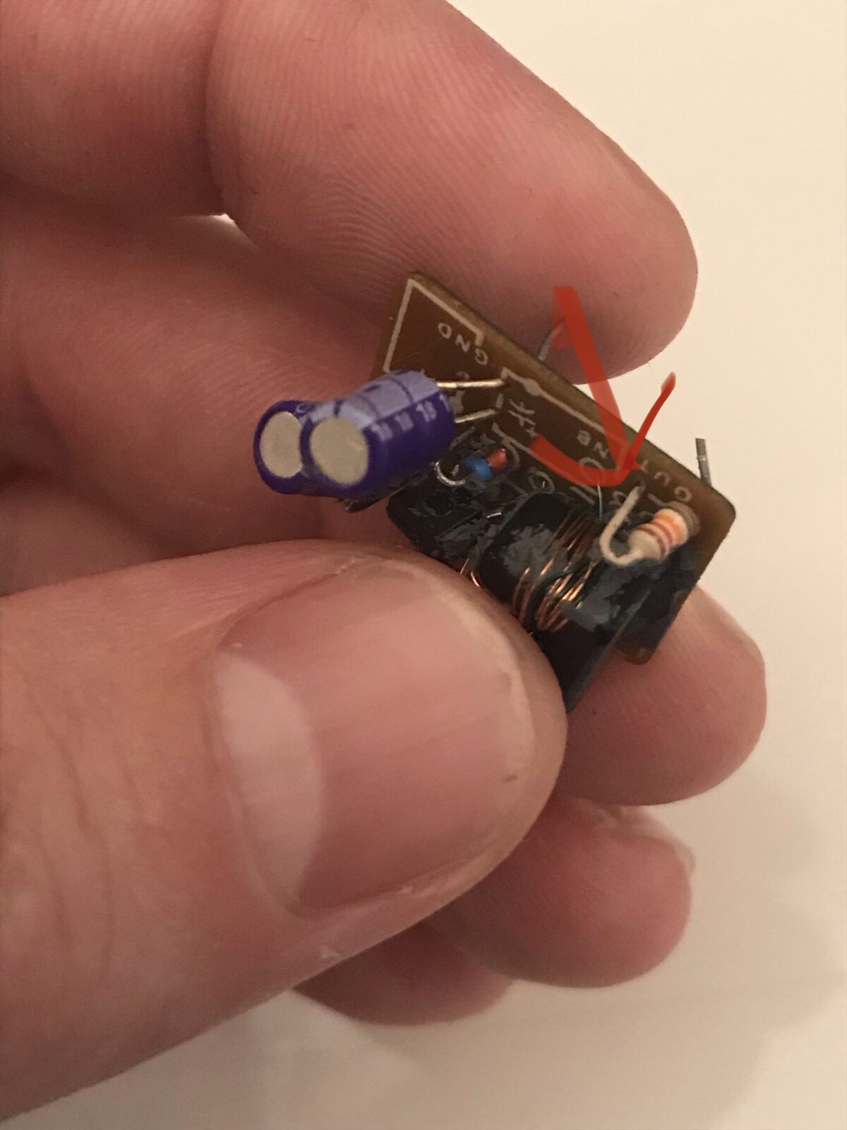

    Hi there,

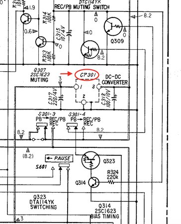

    I'm currently in the process of repairing a WM-D3 w/ no sound at either Line or Headphone amps, and have removed and opened the DC-DC converter hoping to replace components inside.

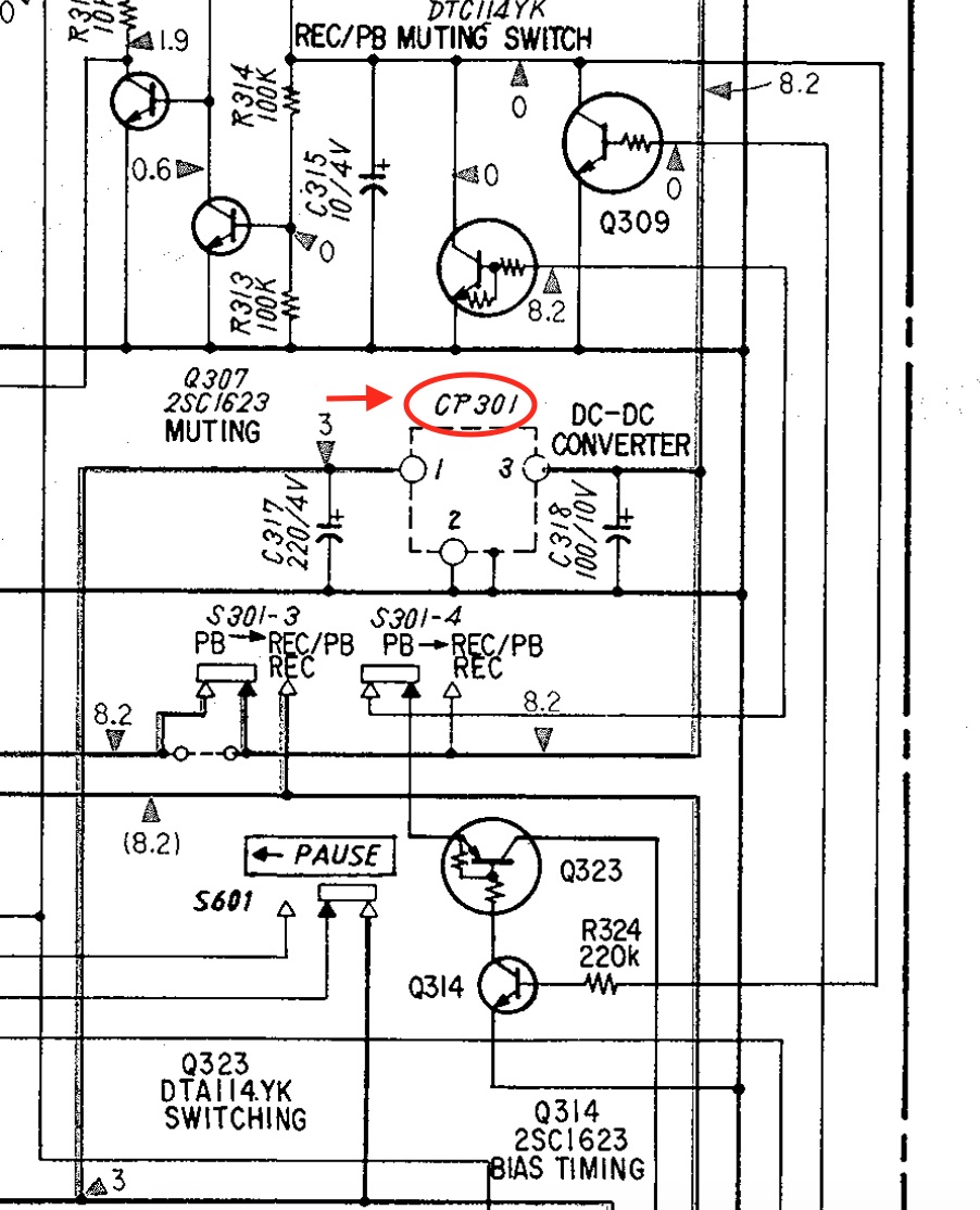

    My understanding is that this converter functions to take 3V and boost it up to ~8.2V (according to the Service Manual schematic), enabling the audio amps to function properly. Unfortunately the schematic in the manual simply shows the DC converter as a single component, CP301, without detailing what's inside.
    I've been able to find information about the DC-DC Boost converter used in the WM-D6C - which I think has also been labeled by Sony as CP301 - but nothing about the converter in my WM-D3.

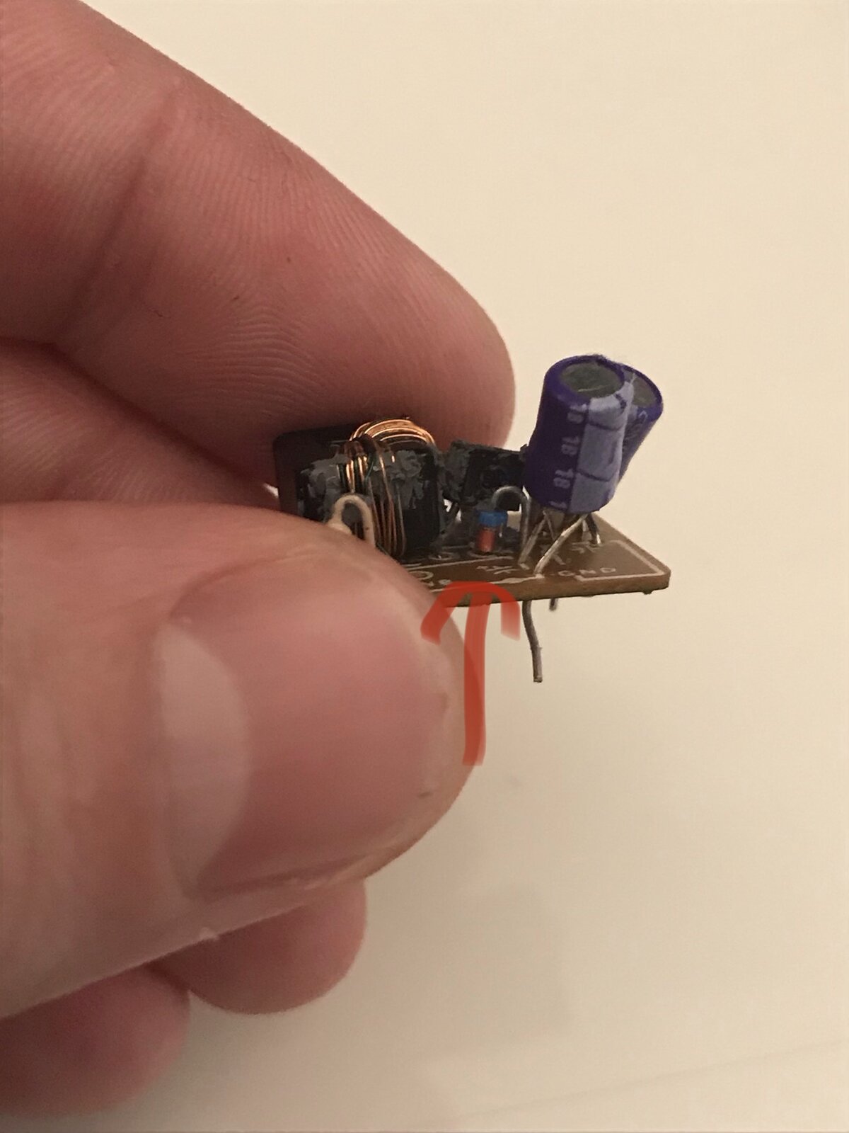

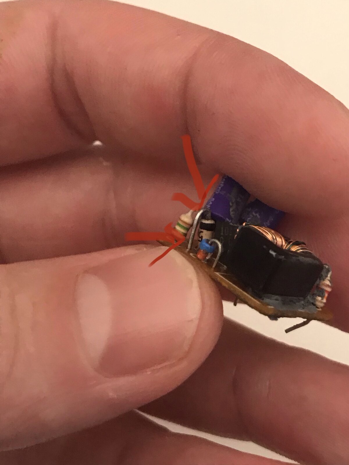

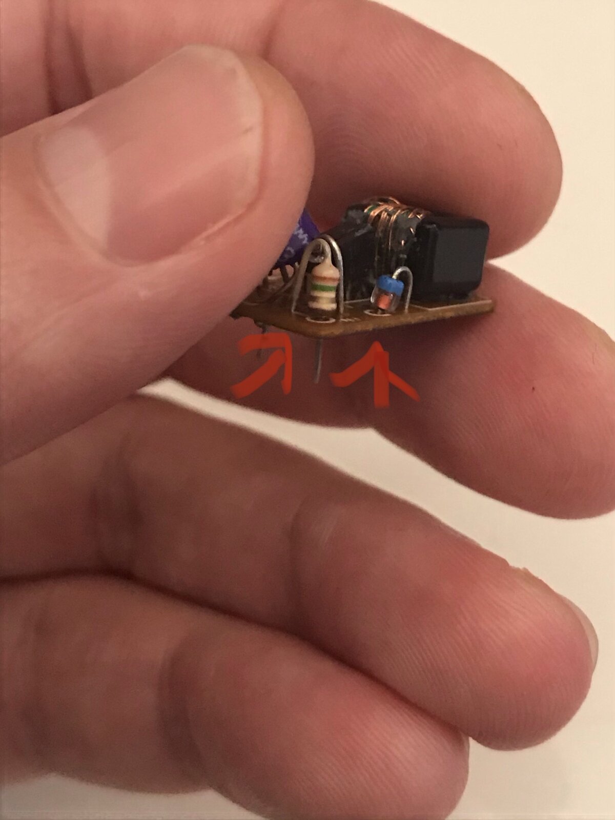

    So, I'm having a tough time identifying the following components, and was wondering if you would know acceptable replacements for each -
    Zener diodes (2x)
    Schottky diode (1x)
    Transistor
    Inductor
    Resistor (2x)
    The electrolytic capacitors I can figure out, but if anyone has a list of parts based on having worked on these in the past, or an understanding of the values needed in each component for the converter to function - the more information the better!
    Included some pictures - while there are arrows in only some of the images, I'm interested in confirming all of the components.
    Thanks again!
    John

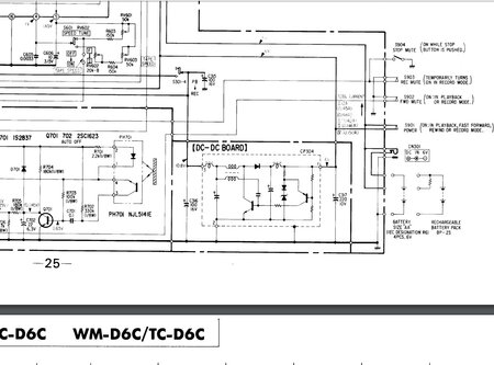

    I reckon you should check the schematic in the WM-DC2 service manual. Reason being the converter in the D6C is 6V to 11V and what you need is more likely 3V to 6V, like the DC2. The converter in the DC2 boosts the voltage to supply the line out amplifier.
    JoFugd likes this.

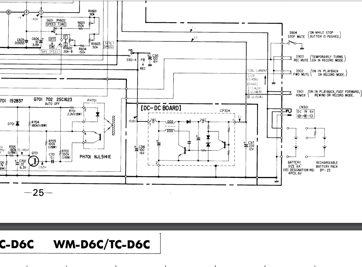

    I assume that this schematic, while shown here for the WM-D6C (6V to 11V), would be the same for the WM-D3 (3V to 8.2V) albeit using components w/ different characteristics from those in WM-D6C converter? i.e. a zener diode with a different backwards voltage, perhaps a different value inductor, Schottky diode, etc. etc.

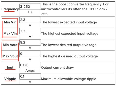

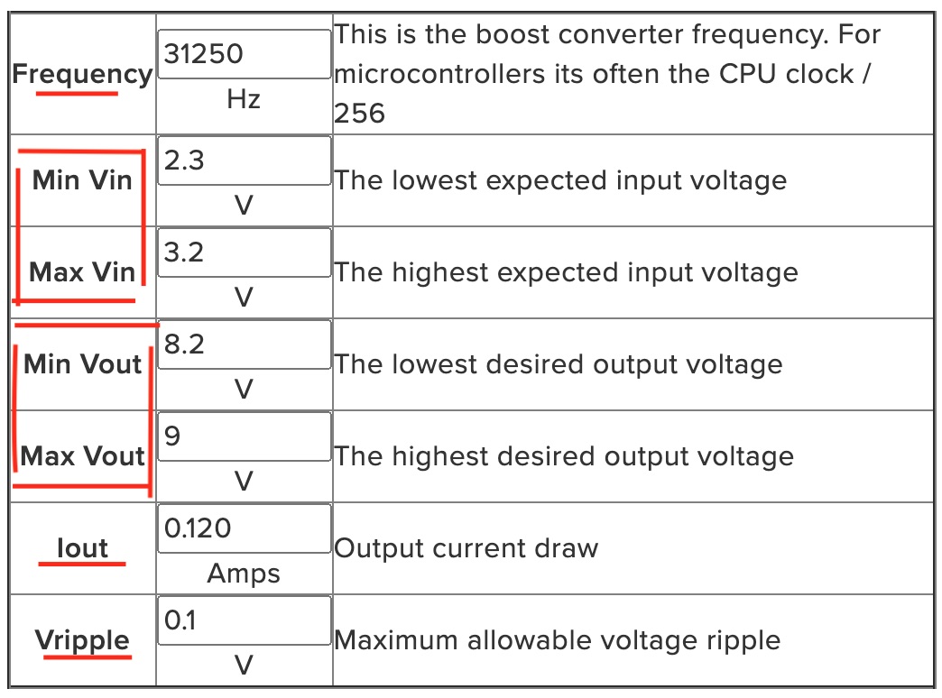

    When designing these DC-DC boost converters, is it the case that the backwards voltage of the Schottky diode should match the target output of the converter? So in the case of a 3V - 8.2V converter, the backwards voltage of the Schottky should be 8V? 8.2V? 9V?
    I'm trying to work with an online calculator used for designing DC DC Boost converters, which has the following fields to populate -
    I estimated what I thought the Min + Max input and output voltages should be based on my earlier voltage tests of the WM-D3 board.
    Frequency I'm not sure about - and not sure how I'd go about finding out - so left as 31250Hz (default)......this may be completely off-base
    Output current draw I used the Playback current draw specified in the service manual
    Max allowable voltage ripple again I'm not sure about, so left as 0.1 (default)
    Any help in understanding how I go about finding these values to populate the calculator would really be appreciated! I'm sure that I'm greatly oversimplifying my questions, and if there's any additional information that would be needed I'm more than happy to try and provide. For now, I've included an image from the schematic showing the location of CP301 DC-DC Converter.
    Ultimately I'd like to be able to put together a list of compatible replacement components to be used in the DC-DC Converter for the WM-D3, in order to hopefully help out others also interested / in need of this info down the road.

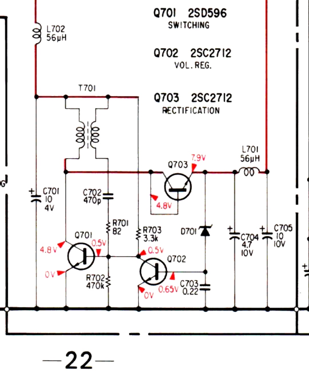

    The DC2 outputs 7.9V so it's very similar to the D3. The diode will be rectifying the stepped-up AC voltage, it's not working as a regulator. Remove it from the board and check if on diode check it only conducts in one direction. The capacitors are polarised so if the DC supply has been reversed at some point they may have failed.
    JoFugd likes this.
  6. mattb1970
    mattb1970 Member
    97
    Here is the schematic for the DC-DC converter in the WM-DC2.
    JoFugd likes this.

    I was about to say I get lost with transistor circuits like that, although looking at the voltages it is fairly obvious there should be 7.25V across the zener diode which I would guess is a 7.2V device.
    My first comment was going to be that if you get really stuck there are now dozens of small switch mode ICs from the likes of TI to do the same job. Those USB recharge your phone packs that you get in Poundland contain a switching IC to boost the 3.6V lithium cell up to 5V.

    the scheme published by mattb and with three transistors and a single diode ... but in john's photos I see only 2 transistors and 3 diodes ... it is true that the d6c scheme is for different voltages but they are 2 transistors and 3 diodes .. it could be more like .... afterwards you can take anything to be successful

    The thru-hole transistor is a 2SA1013 PNP. All the transistors in the DC2 DC-DC converter are NPN so that design is different.
    The D6C DC-DC converter has both an NPN and PNP transistor so it's possible this design is closer to that of the D3.
    The thru-hole components that look like resistors, next to the IN and OUT labels are most likely inductors.
    Check for continuity across their pins to determine if they are faulty.

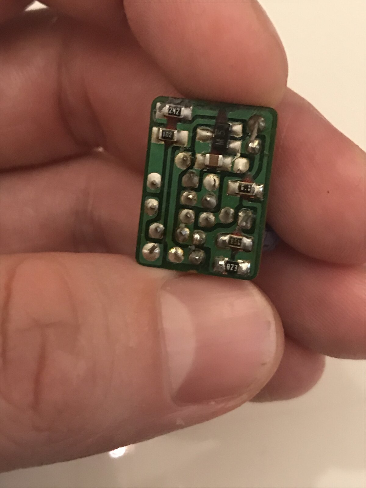

    There is a 2nd surface mounted transistor on the solder pad side, unfortunately I cannot identify it.
    There are also 5 surface mounted resistors and a capacitor on the solder pad side.
    In case you haven't already seen it, this excellent post gives some very useful info about the D6C DC-DC converter design;
    http://stereo2go.com/forums/threads/wm-d6c-dc-dc-converter-fixed.421/
    JoFugd and Silver965 like this.

    in fact it seemed strange to me to mount 2 old 1/4 watt resistors ... Brown green ... gold? and the other Brown red and I don't understand if it's yellow or orange .. I'm rusting too :hmmm
    JoFugd likes this.

    Looking back at the circuit design calculator, I'm wondering if you might know how I can approach the following as they relate to the D3 DC converter:
    How to know required input and output wattage?
    How to know required input and output current?
    What will be the "switching frequency"? - started reading up on this yesterday, but still not clear on how to identify that frequency here
    Ultimately I'm hoping to be able to reverse engineer the converter so that I understand not just the types of components, but the values of components used as well.
    Once again, a HUGE thank you to all!
    John
