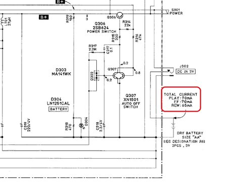

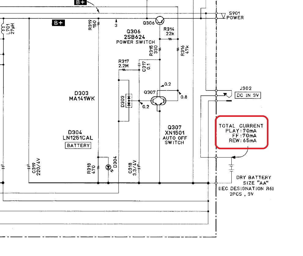

  8. Valentin
    1,668
    You can find the current draw for specific models in their respective service manuals, it's written on the schematic near the DC in jack symbol.
    The specification is without a cassette inserted or headphones inserted. I attach a screenshot of the DD30 manual section with current draw.
    The DD repair guide is giving a general guideline, not precise values.
