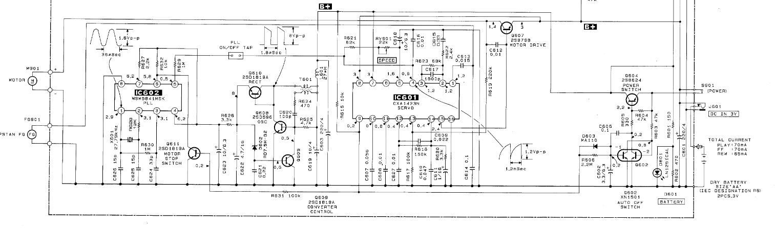

  3. Valentin
    1,676
    Some of the values are indeed off. But the fact PLL is disconnected and battery voltage is not 3V will influence this circuit.
    I suggest changing the strategy because we're really not interested in all the voltages but rather if some key areas of the circuit are working:
    1. The voltage reference. This is present at 1.52V and it's close enough to the specified 1.6V to believe it's fine.
    2. The sawtooth waveform at pin 4. You should have this waveform there even with the PLL disconnected.
    When these ICs don't work (usually due to walkman being powered with reversed polarity), the reference voltage is not present.
    However, before suspecting anything electronic I would want to make sure there's no mechanical problem. Would check the following:
    1. Is the motor rotating freely ? Remove the motor and rotate by hand in both directions.
    2. What current does the motor draw with no load ? Power the motor with a bench power supply or battery (1.5V) and measure the current consumption. Should be 10-20mA.
    3. Is everything clean mechanically ? Clean the rubber ring with IPA, motor spindle, capstan and pinch roller just to be sure.

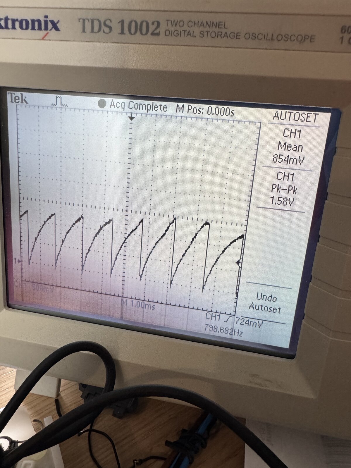

  4. Jose Ventura
    Jose Ventura New Member
    22
    Porto

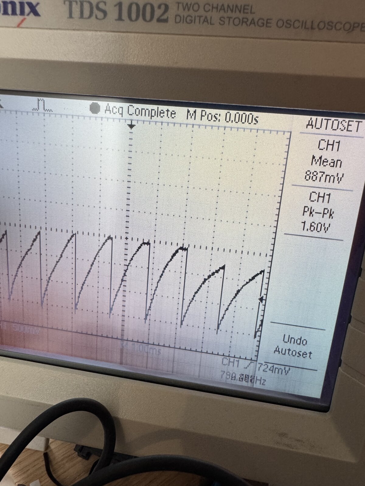

    Hi everyone,
    Sorry for being away for such a long time, but unfortunately I had to deal with some prolonged health issues. The good news is that I am ok now, so I can return to my hobbies :delighted:
    I have done a couple of things:
    • changed the capacitors to new ones;
    • looked for broken traces on the PCB, but could not find any;
    • check with the oscilloscope the wave forms on pin 1 of IC602 and on pin 4 of IC601 - When it is locked correctly the waveforms are very good. When it is locked at a lower speed I can see the waveform on pin 4 IC601 a little bit erratic and with the top tip cropped.
    • cleaned everything, specially the rubber ring;
    • I can turn the motor by hand but it seems the shaft is bent? Is this even possible?
    • Also, could a faulty capstan FG cause this?
    I will now remove the motor and check the current load when spinning with a stable 1.5V power supply.

  12. Valentin
    1,676
    W&F of 0.2% is ok given there's no servo control. How much does the speed vary in this setup ?
    Roughening the capstan is something would recommend doing as there's no downside in doing it. Seen a couple of situations where a polished capstan had the symptoms of low speed and high W&F.
    As far as mechanical problem goes, a 400Hz drop in tape speed would mean a lot of resistance which you would be able to feel by hand and would also create some audible noise.
    Before drawing the conclusion, measure the voltage at the motor when speed drops. If the voltage drops also, it's obvious problem is in the servo.

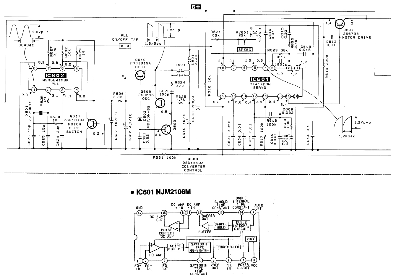

  14. Valentin
    1,676
    Would be interesting to test it with alkalines to see if there really is a difference. Although you would need thorough testing to be sure this is not a glitch.
    The 90mV difference you measured explains the difference in tape speed, so this confirms it to be a servo problem.
    In regard to the +/-1V, you probably meant +/-10mV (0.01V) instead.
    When the servo feedback loop is stable, the third decimal should vary quite a bit, while first 2 should be stable.
    Given you say the sawtooth waveform gets chopped off at the top when servo becomes unstable, I would check/replace C616.
    It's possible this capacitor is starting to fail after a certain voltage, which would explain the behavior.
    It would also be interesting to see what happens with reference voltage (pin 5) when servo becomes unstable.

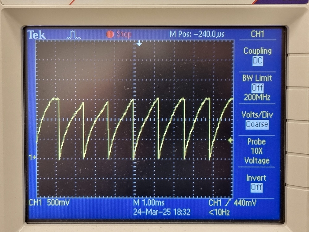

  15. Jose Ventura
    22
    Porto
    Yes, I meant 0.01V (10mV) - edited and fixed on my previous post.
    I have just replaced C616 with another 10nF 100V capacitor and it remains the same.
    when it is not synced, pin 5 does not display any waveform, just a constant value of 1.5V. On pin 4 the wave form seems to be constantly rising until it starts to be cut off and resets itself. It does seem to be some capacitance issue but the caps are brand new and I can seem to find any broken trace (yet).
    this last values and waveforms were taken with an external power supply set to 3.0V

    Hi.
    I have DD33 with exactly the same behavior. But it got worse over time.
    It started exactly as you described. Sometimes locks on lower frequency (and I see erratic behaviour on pin 4 of servo IC), but it could work normally sometimes. After some time, it got even worse - depending in the moon cycle, it would not start at all. But giving a spin to the capstan allowed it to start at 3000/2600 speed with 50/50 chance.
    Now when pll jumper is disconnected, I see no waveform on pin 4, and speed of the capstan is maybe 10rpm. Speed can be adjusted from standstill to 10 rpm. But according to the manual, it should be adjusted normally, but without quartz lock, wow/flutter should be higher. In my case there is almost no movement of the motor in that state.
    What I've tried: Replacing all electrolytic caps: No improvement. Checked the replaced caps with esr meter and capacitance meter - they are good.
    Checked timing capacitor (C616): It is good.
    Checked all other signals: they are logical: 20mv p-p on pin 1 during normal rotation, vref is 1.54v, motor drive amplifier behavior is stable.
    Checked speed potentiometer and R621 - they are within specs.
    Then I started experimenting. Accidentally I discovered, that with PLL jumper connected, motor can be started not only by rotating it, but by touching one of the C616 pins (the one which goes to servo IC CHA1423N).
    I dug deeper, and discovered that during touching the pins (I've set my scope to single waveform) and during touching the capacitor, voltage on pin 4 was increased by 0.08V, and this started waveform generation.
    I've added pull-up resistor from pin 4 to pin 7 of servo IC (I think it was 2.2MOhm), and after that had stable start.
    Disconnecting the PLL jumper, I've discovered, that now speed can be adjusted, but it is till lower than 3000Hz on any position of the potentiometer. The saw waveform period on pin 4 was 1.6mSec, but according to dd33 schematics it should be 1.2mSec, and also voltage was 1.5V p-p, but according to schematics it should be 1.2V p-p.
    To increase speed, I reduced value of R621 from 62kOhm to 33kOhm, and now I've had a possibility to set speed to 3090 as per datasheet. Then I've connected PLL jumper, and had locked it to 3000Hz 100% of the time. But only on 3V power supply. Reducing voltage to 2.6V brings back the erratic behavior.
    Also, with disconnected PLL jumper I see almost 6.5V peak signal on IC602 (quartz lock chip) pin 5, which is connected through 1MOhm resistor to pin 4 of servo IC601.
    What concerns me:
    6.5V feedig to the IC601 could have damaged internal logic of the chip. As per service manual, inside the IC601, after sawtooth generator, the signal goes directly into the comparator, which I think compares it to Vref minus one diode voltage drop (which at 1uA current should give us roughly 1.2V).
    Sawtooth waveform peak voltage is 1.5V in my case, but 1.2V in datasheet.
    I've ordered another dead walkman for way too much money to try to repair mine. Hope servo IC is good in it, or at least I can take some measurements from it. Only the latest DD walkmans use the same servo IC, DD33, DD22 and FX100, which is sad.
    I'll give an update when I'll have more information.
    Valentin and Hyperscope like this.

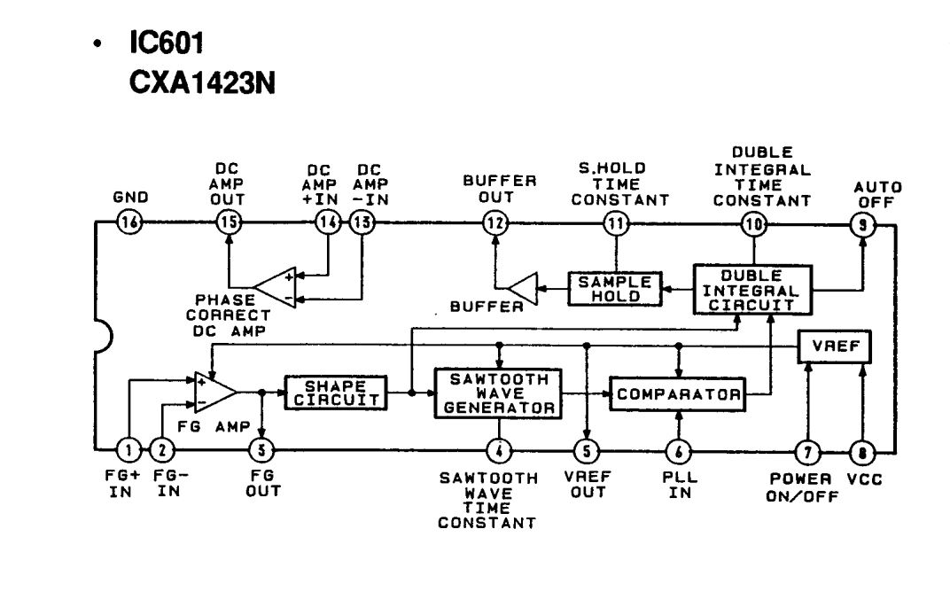

  19. Jose Ventura
    22
    Porto
    Before doing more tests with different resistor values on the pull-up, I started checking the signals on all the pins and comparing them when it is locked vs non-locked.
    When it is locked, pins: 15, 14, 13, 12, 11, 9 all are stables and constant.
    When they are not locked, the value fluctuates and have some positive and negative spikes.
    It is very weird...
    The symptom I have right now is when I play start it is not locked. If I press the capstan wheel to slow a little bit and let go, it syncs.
  20. Jose Ventura
    22
    Porto
    So, I have double checked the waveforms and on Pin9, I found it odd that I was seeing impulses even when in sync. When not locked, those impulses turned almost like a square waveform.
    This is connected to the auto off, so I removed resistor R616 and now it always locks in sync. Also, waveform on Pin4 is smooth and stable, so I think there is something wrong with the auto off mechanism that is triggering the symptoms and perhaps IC601 is not faulty at all.
