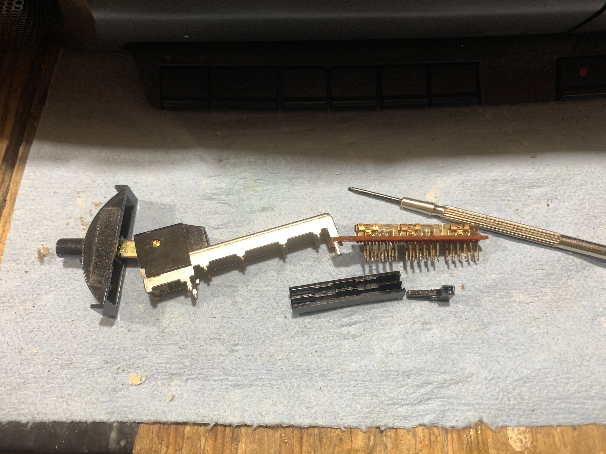

    I picked up a Sony CFD-222 dual cassette/CD player from the Thrift the other day. Battery compartment loaded with battery crumbs. Small spring missing from deck 1 mechanism. No light from the power LED, except when cassette deck is active. Got it all apart, fixed the wonky deck. Cleaned up the mechanisms. Discovered the 4-way selector switch on top is broken. The contact slider inside was stuck all the way down with its connector arm broken off. Pretty flimsy looking. Got it desoldered and apart. Pretty sure glue won’t do the trick so I’m looking for a switch that’ll work. No luck with the OEM part number (1-762-865-11). Does anyone know of a replacement or permanent fix?
    Thanks in advance!
    CW

    Good luck in finding another.
    Since it is an internal part could you reinforce it ? A colleague fixed a plastic part in his car indicator switch by drilling into both parts with a fine drill then snapping it off. I have reinforced plastic repairs with small pieces of Piano wire. Obviously you still need glue, and I have read good things recently about Loctite Plastics Glue https://www.amazon.co.uk/Loctite-Al...ocphy=1006943&hvtargid=pla-700412402623&psc=1 but reinforcement should make it stronger.

    Thanks! I've decided to give that route a try. I've got the pieces glued back together now. I'm going to reassemble them so far as to see what I've got for clearances in the housing to see what kind of room I've got for reinforcements. A horse shoe piece made to go over the broken area and tie it into the main slider might work if there's room.
    The tab that sticks off the slider is so tiny - I can't imagine this is the first one of these that has broken. Granted, it's a 23-year old boom box, so support from Sony isn't expected, but I've been able to find parts for most of my older equipment, or adequate fixes when parts aren't available. I just find it hard to believe that this switch, with what I feel is a weak design, hasn't been made available as a replacement on what was not an inexpensive item when new. Oh well. I'm not ready to give up on it just yet...
