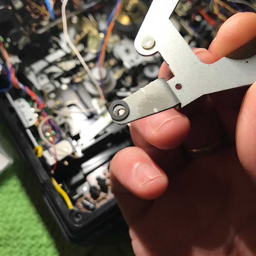

    Something I see come up constantly is the use of those tiny plastic washers - either the split green ones or the closed black 'oil washers' (?).
    There's another kind of tiny washer in these TC-D5's, labeled as a 'felt washer' in the manual, though in reality they appear to be small black nylon washers, a bit thicker than what I've seen with the other two types.

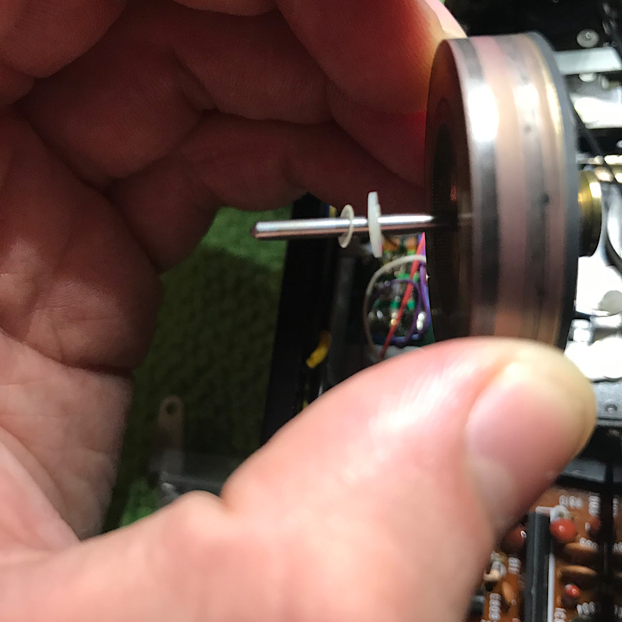

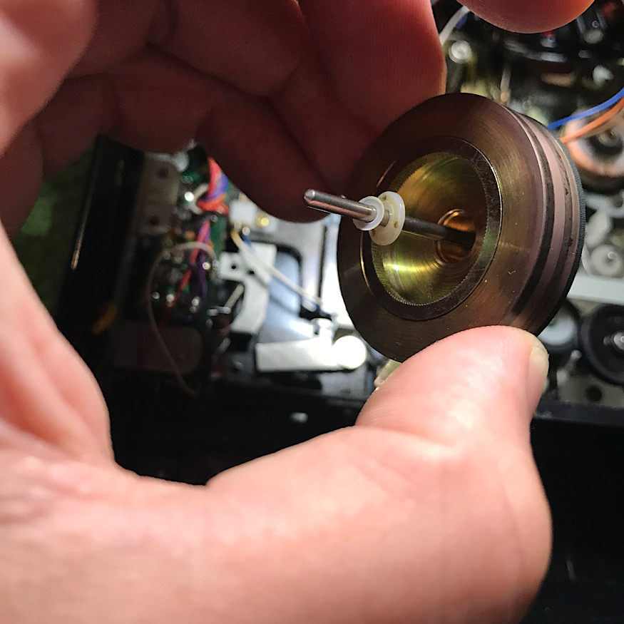

    After removing the flywheel carefully, I found that there were two distinct types of washer on the underside of the flywheel, along the capstan, behind the capstan bearing.

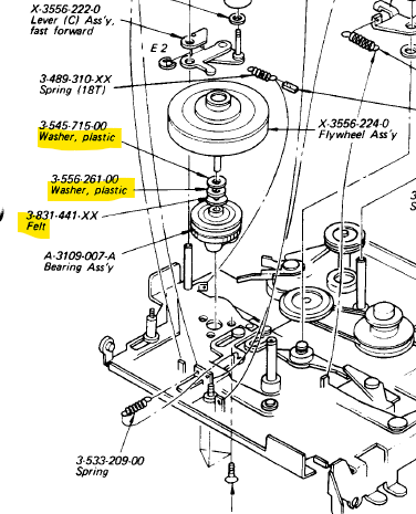

    Now, looking at the manual, it indicates a third washer at that same spot, that I'm sure was not present in my deck. The unit itself had clearly never been opened up, at least as far as I could tell, not least of which because all factory-applied loctite was still in place across many of the main PCB and chassis scres (not just over the adjustment screw points).
    I did double check the area, including the top of the FG coil piece, and did not see a third washer stuck anywhere there. Picture for proof :)
    From what I could tell based on the manual, something like this is what they refer to as the 'felt' washer -

    1 - If any experience with the D5 Pro ii, does the set of 2 washers on my capstan look correct, or am I somehow missing the third washer?
    2 - More generally, can anyone speak to the mechanics involved with these washers, specifically in this area of the D5? Why the need for 2 (or 3)? Assuming 1 is for reducing friction, perhaps another to block oil migration, but a third? For height maybe?
    Ultimately I'm looking to get this unit closed back up and on to testing, but first wanted to make sure that I'm not leaving out a washer that may or may not have been included in the first place. If it's needed, I think I have some spares that could work.

    In my opinion the 2 plastic washers are to set the height and the nylon one is for friction reduction. If a washer would be used to reduce oil migration, that would be on the top of the mech, so it does not contaminate the pinch roller.
    On the bottom I don't see a purpose for that, quite the opposite, the capstan bushing and the nylon washer need to be oiled. From what I remember, I only saw 2 washers (one plastic and one nylon) in the TC-D5/D5M/D5Pro I have opened.
    What I think as a theory is maybe SONY replaced the 2 plastic washers with just one that was thicker. That could explain why there are only 2 instead of 3. And there's also that flywheel thust play adjustment screw that can compensate for the height anyway.
    There is one way to know for sure if there were 3 washers or only 2 (of course, that's assuming the thrust play adjustment has not been tampered with): if the thrust play is correct with the current setup, then it means that's how it's supposed to be.
    If one washer is missing, that will increase the play considerably and you can feel it by hand.
    It's ikely that SONY changed the design of this mech over the years (as well as the PCB) and what is shown in the service manual may be a very early version which got ditched over time.

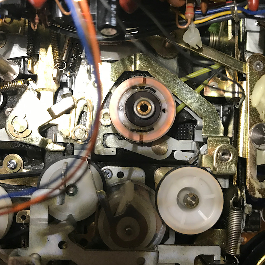

    Given you already started this thread, I take the opportunity to ask another question: in what condition is the capstan ring of the TC-D5Pro you're refurbishing ? I wanted for a long time to ask for a crowd funding in order to support Marian Mihokm to produce such rings.

    In response to the capstan ring, from what I can tell it’s in ‘OK’ shape, but I’d imagine it’s begun to lose some of its properties and that it will continue to do so. I would absolutely purchase a replacement, and more than likely a few as, should a replacement become available, id likely start working on these more than just the one example I have currently.
    For the rest of the rubber, after changing the belts I attempted to ‘recondition’ the idlers with sandpaper, denatured alcohol and Plasticlene. This seemed to work OK for some of them, but I’m having take up reel problems (started acting up after taking apart the machine) so not sure yet if this is due to old idler rubber or some other issue. Will need to inspect further.

    The units I have seen all had the rubber with cracks on the surface and getting hard. The unit I have in my personal collection (a TC-D5M) has been resotred, as much as it could have been done: the idlers were sanded and cleaned with acetone then alcohol.
    The idlers are usually in restorable form, as the cracks are usually just on the surface and after sanding, the rubber becomes good again (this will depend a lot on how the unit is stored, as rubber will be degraded a lot by heat and UV light).
    However, the capstan ring in my unit certainly is in need of replacement: it has deeper cracks that do not go away entirely after sanding and the rubber has become hard. This causes the motor to be noisier than it should and could shorthen its life.
