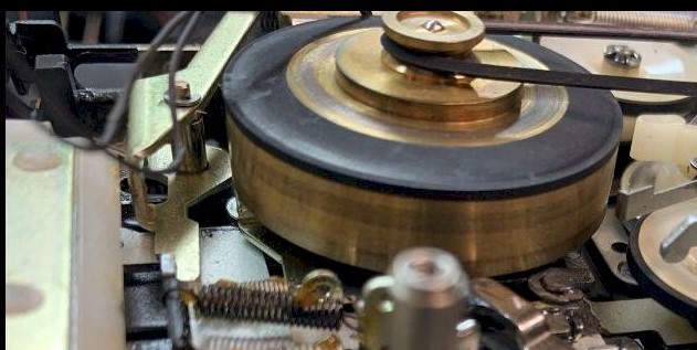

    The Flywheel on my TC-D5 has gone hard and the motor roller is starting to slip on the rubber.
    I'm wondering the best way to deal with this. Can I just remove it and glue on a rubber gasket of the correct size in it's place?
    I noticed that the rubber surface appears tapered. Is that the rubber ring that's tapered, or is it the brass surface of the flywheel?
    I contacted Terry, who does the rubber wheel restoration, but he's unsure if he can do it, especially if I can't tell him what size it should be.
    Thanks

    There are mainly 2 solutions to your problem:
    1. Clean your original rubber very good with IPA or acetone. To me it doesn't look that bad and I think the glaze is mostly on the surface.
    2. Replace the rubber with another one (this being the only one available): Idler Tire Capstan Rubber Ring Gummi für SONY TC-D5M TC-D5 PROII CASSETTE-CORDER | eBay
    Marian doesn't have it and won't produce it because on some units the ring is glued very strong to the brass flywheel and will require a lathe to remove it.
    Hence why it's not really a DIY job and Marian cannot sell these rings even if we would manufacture them as most people won't be able to replace them.
    The 4 idler tires will also need restoration: sanding and cleaning with IPA. In some units these tires will need to be replaced as they're too far gone.
    Unfortunately the T-shaped ones are not available at this point in time.
    For reference, the belts are available from DeckTech (ebay) and these will also need to be replaced.
    By the way, also check the motor pressure is high enough as that can also cause slipping. I have seen units where the motor spring wasn't fitted correctly.

    First of all, that's not my flywheel, it's a random picture I found and photoshopped. My flywheel doesn't have any kind of glazed look to it at all, and it's perfectly clean. It's just become hard over time and the motor slips on it.

  8. Valentin
    1,669
    IPA can be used safely on rubber parts, I have been using it for many many years without any issues whatsoever.
    Acetone is a more aggresive solution, but depending on how bad of a condition the ring is in, it can clean the surface better than IPA.
    To be even more clear, it's something I have used myself on this rubber ring, otherwise I would not make such suggestions.
    This particular capstan ring isn't be affected by acetone, although in general, I do NOT recommend acetone for rubber parts.
    Sandpaper does work well on the idler tires as you can rotate them on the paper. On this ring, it's harder to maintain uniform pressure.
    But even the idlers will require a final clean with IPA after sanding.
    In regard to pinch rollers, those are readily available so I don't bother to restore them as in most cases it doesn't produce good results anyway.
    Sanded idlers do work in the long run, so if rubber isn't too far gone (large cracks, very hard rubber) they will last.
    The part is only available on ebay.de, doesn't show on ebay.com. But you can buy it from .de website if seller ships to US.
    Marian has already tried many solvents and none are working. If you find the solvent that works please let us know.
    Flywheel retainer has to be removed anyway for replacing the main belt, so if someone gets to that point, the only extra step is to remove the motor.

    Ok. I think I will try sanding it down first. I can put some tight heatshrink tubing (without shrinking it) around the capstan post and put it in a drill press and then sand it down with fine wet sandpaper. That should get it really smooth.

    I am on the same page with you, think restoring the original one is the best option and should be tried first.
    This is a good idea ! Please share the result and eventually take a picture, I'm curious to see how it looks in the end.
    Pinch rollers are barrel shaped, that's why sanding them doesn't work. Sanding will make the surface flat instead of curved, see attached picture.

    Ok. I got impatient and I did it tonight. I removed the flywheel, covered the capstan in 1/16" heat shrink tubing. I had to hunt around in the box for a tight fit because they always vary a little bit.
    Then I put it in the drill press and got some wet sandpaper and took off a bit of material. I can just barely still see the ghost of the worn area on the inside now.
    Anyway, I put it back together and put some test tapes in. Set the azimuth, and pulled up the record level. Seems pretty steady and in phase. I'm playing some stuff on it and sounds good. I'm still not 100% sure about the take-up reel though, it seems like it doesn't handle enough pressure to be honest. I can hold it with my finger and it triggers the auto-stop quite easily. I'm afraid there might be something else worn or slipping in there. It's not the main drive belt.
    In any case, the flywheel rubber seems okay, at least for now.

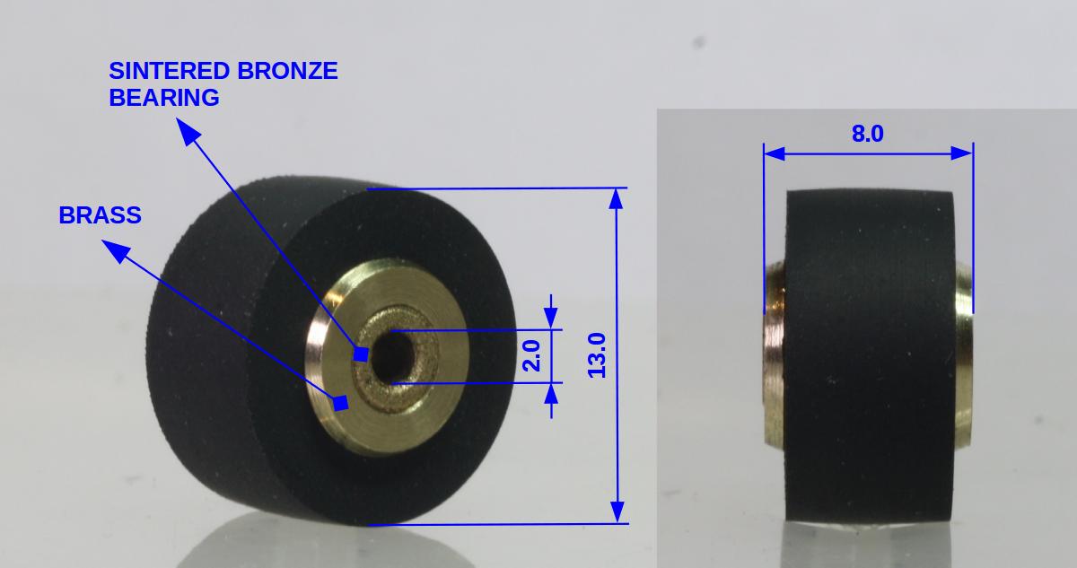

    I do have some measurements, but take into accounts they're approximate:
    PLAY idlers (2 pcs needed): 13.5 x 8.5 x 2.5mm (outer diameter x inner diameter x thickness)
    FF/REW idlers (2 pcs needed): 17.5 x 15 x 1.5mm (outer diameter x inner diameter x thickness)
    The PLAY idlers are T-shaped, but regular ones will likely work if the inner diameter is a bit smaller, like 8mm instead of 8.5mm.
    In practice they can be replaced with O-rings that fit on the plastic pulleys as a last resort, I have done that succesfully on a recoder that needed a very larger idler on the takeup reel.
    If you find some replacements that are close or the same, please post here.

    I don't understand exactly how the "T" works, so this confused me a little bit. Making the ID smaller makes the tire bigger. If the tire is "T" shaped, doesn't that mean the there is a narrower portion on the inside diameter of the tire that fits into a recess on the outside diameter of the pulley? Are you sure you meant that and not making the ID larger? So, for example, if the narrow portion of the "T" is 0.5mm, then the ID of the idler tire should then be 9.5mm instead of 8.5mm. Like this:
  17. Valentin
    1,669
    Ok, so let me clarify:
    My measurements do not take into account the narrower portion that gets into the recess, hence why there are only 3 dimensions and not 4.
    Given there is less surface area for the inner part to grip onto the plastic pulley if that lip is missing, having the inner diameter smaller will give a tighter fit.
    On your drawing:
    - What is marked 9.5mm is in reality 8.5mm.
    - What is market 2mm is in reality 2.5mm.
    I ignored that part when I measured the tire since I could not find any T-shaped tires that are anywhere near these dimensions.
