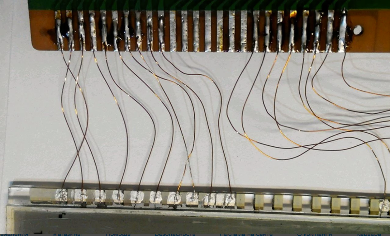

  13. Mystic Traveller
    1,833
    It's a very common weak point of all 55/550 LCD flat cables, Jorge mate.
    My JDM Victor PC-55 one was also affected.
    Segments dying then getting back to life and again dying.
    Ageing, aging and ageing one more time.. :(
    I've seen only one case yet when it was fixed but AFAIK it was very
    meticulous and time consuming work - one guy in St. Petersburg -
    he coudn't fix the problematic flat cable itself but decided to
    bypass it with wires - a hell of job.
    I was impressed and decided to save one pic of his result - maybe it may
    help someone else wishing to take on this chance. :) Here it is.
    Otherwise, it's a beautiful machine - I love it. :)
    I've sold mine but thinking about getting another one sometime.
