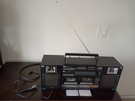

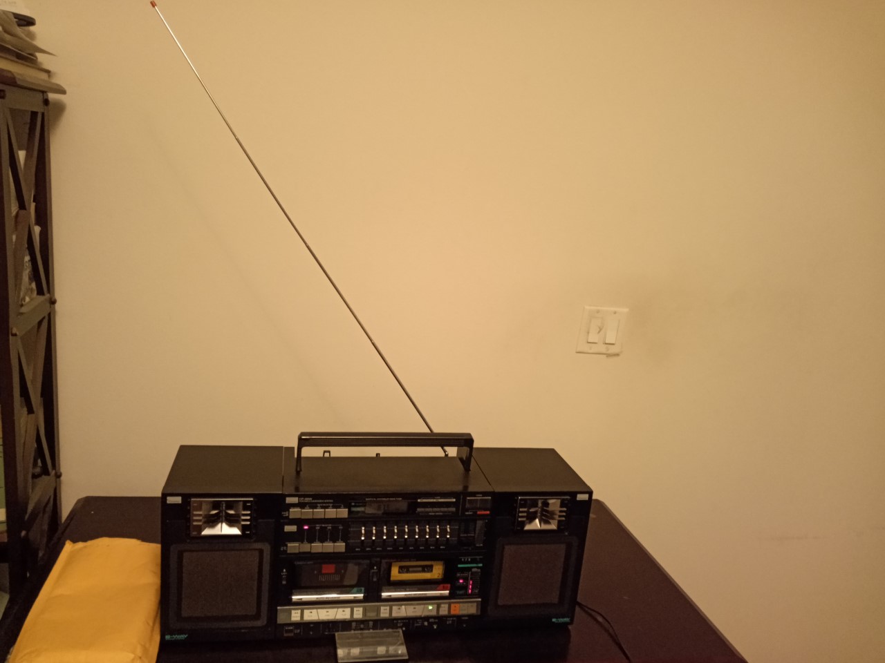

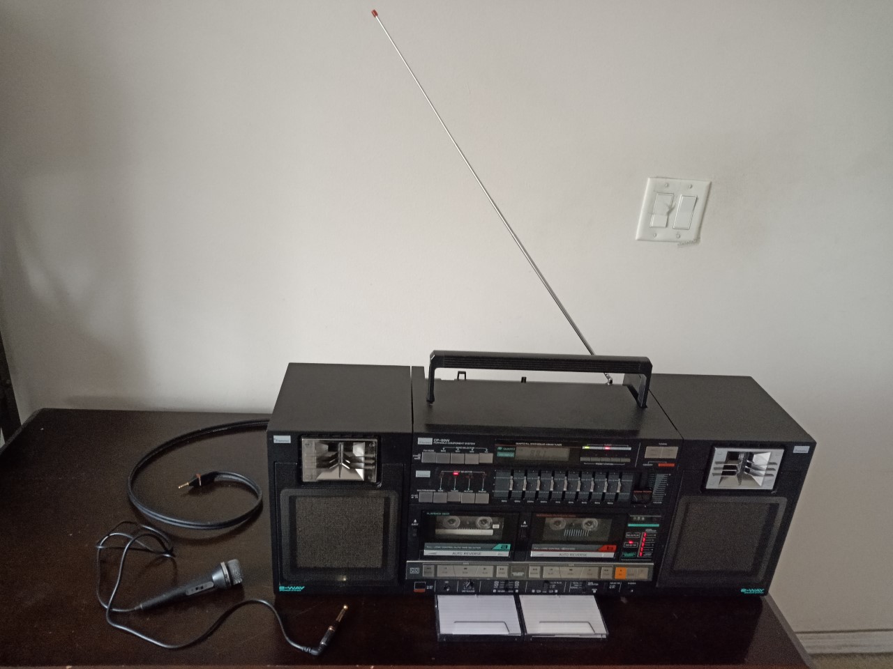

    Hello, people. In July 2020, I bought a SANSUI CP-99W from a military vet in Dallas, Texas. With 93 watts consumption in AC (plug-in) mode, that good-looking, twin-cassette-deck, shortwave (SW)-tuning, digital-tuner boombox is easily the most powerful machine in my very small collection of boomboxes and mini-boomboxes. (I actually have only one mini-boombox, the SANYO M-1770K, unless you count the EMERSON PD-5098, that no-cassette CD player mono’ with a stub of an analog tuner as a mini-boombox.)
    Sorry that I still haven’t figured out how to film and upload videos, but here are a few images of the Sansui in action:
    (In this September 6, 2020 smartphone photo’, it’s about to be tested after being disinfected, days after its return from an out-of-state electronics repairer.)
    (In the next photo', also taken September 6, 2020, the Sansui is playing a 1970s Deutsche Grammaphon/Polydor International GmbH symphonic-music cassette from West Germany.)

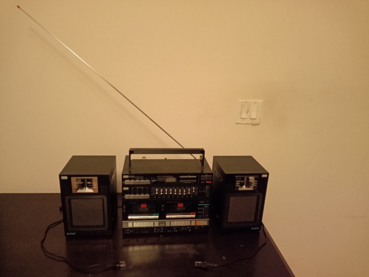

    MY SEPTEMBER 6, 2020 SMARTPHONE PHOTO' OF THE SANSUI CP-99W (AFTER CLEANING).jpg MY SEPTEMBER 6, 2020 SMARTPHONE PHOTO' OF THE SANSUI CP-99W (PLAYING A SYMPHONIC CASSETTE).jpg MY SEPTEMBER 8, 2020 SMARTPHONE PHOTO' OF THE SANSUI CP-99W (TUNING WCRJ-FM, 88.1 MHz).jpg
    (And in the third photo', taken September 8, 2020, with accessories like a RadioShack microphone and a MONSTER Y-cable nearby, the Sansui CP-99W is on FM radio duty, tuned, I think, to 88.1 MHz, which is WCRJ-FM, “The Joy FM.” That was before I played some music home-dubbed to FUJI DR-II cassettes.)

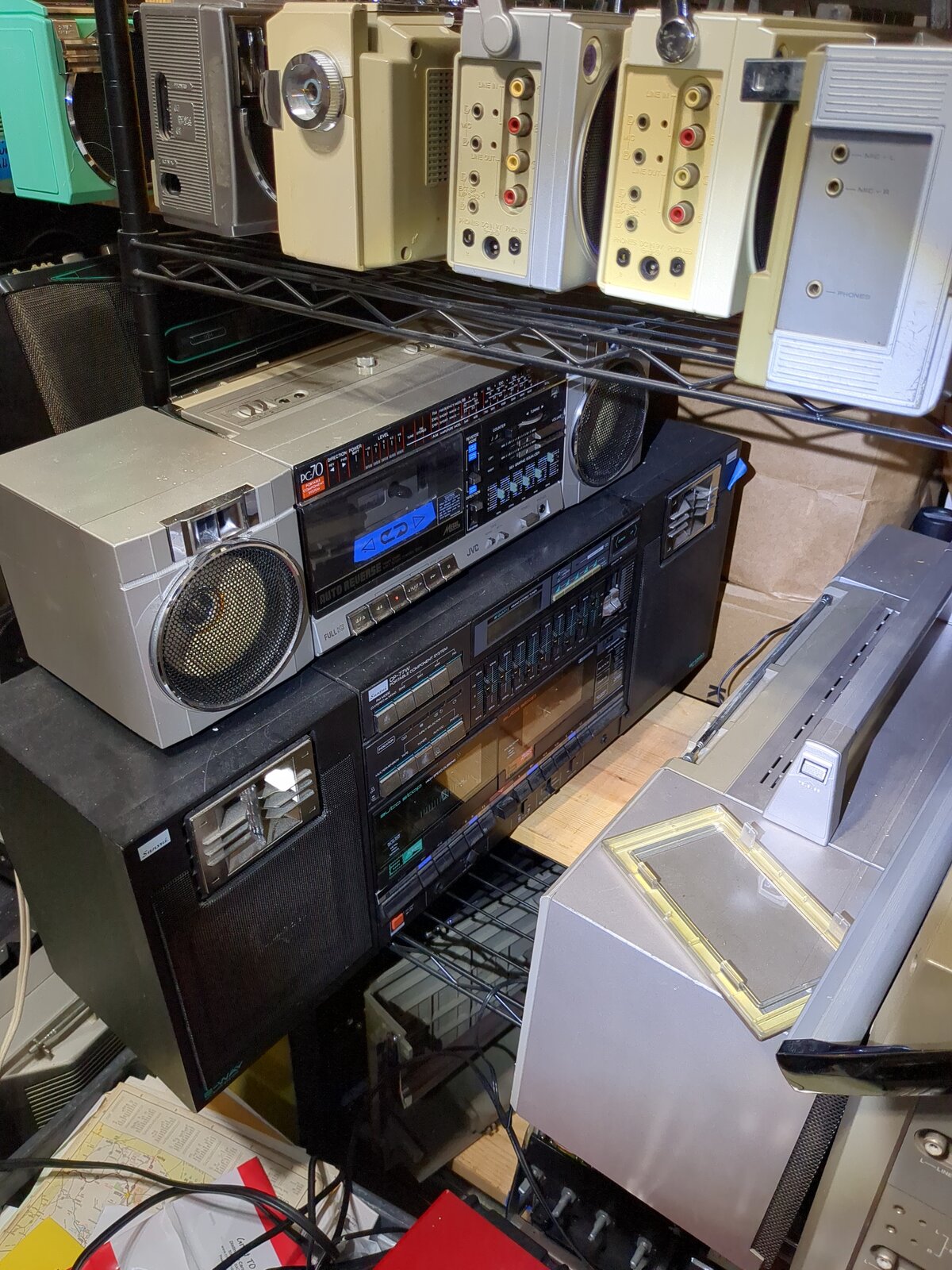

    I just had to see inside this before I sold it.
    Sansui CP-99W Component Stereo Inside Pictures No Sound still & 4 Sale JVC PC-550C
    ... from - Easthelp Active Member.
    Guess who? Me.
    This is why I was asking if he ever got it restored and or see if he would respond to his own thread.

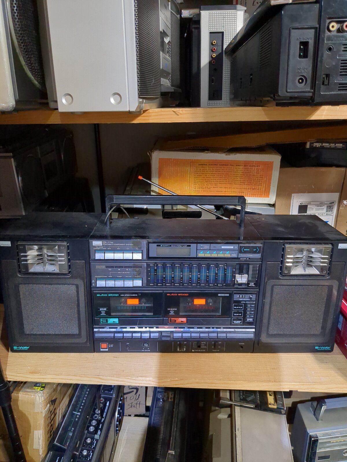

    Well here is a sansui CP55w just needing belts the last time I checked.
    And then here is one of the two sansui. CP 77w s. That I have
    And then over here is the other one.
    They're not missing anything. They just need to be belts replaced and serviced on the inside. I just haven't had time. I'll sell any of the three for $100 plus shipping to wherever you live. I'm in Dallas, Texas, USA. decentman4you2007@gmail.com
    Send me an email. I'll answer any questions. I have PayPal but I'll accept other verified forms of payment.
