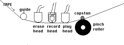

    I don't know what the 'Idler tire' does or where it is located, or if it has anything to do with my problem:)
    Same for the 'Pinch Roller'.

    Hello Noertoft, here's some information to get you started, this page does a nice job of explaining everthing.
    https://www.cse.iitk.ac.in/users/amit/courses/371/adarsh/contents.html
