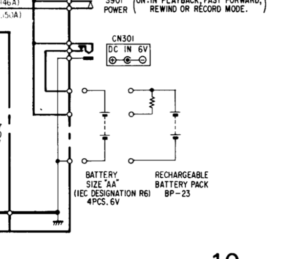

    Hello everyone!! Just had a quick question here, so the rechargeable battery pack that was an optional accessory for the Walkman D6 and possibly the D6C what is the method of charging?
    Does the Walkman allow charging internally? Example if I had the BP-23 installed could you plug in the AC adapter and have it charge the batteries internally without having to remove them?
    Then is there any difference between using the BP-23 VS just installing some rechargeable batteries into the stock battery pack as is?
    Also is there any difference between the D6 & D6C and how they charge or the path of current? (Can one charge and the other not?)

    The walkman can charge the BP-23 internally, the middle pin in the battery "receptacle" is the charging pin, it is connected directly the positive of the barrel plug when the plug is connected. Inside the BP-23 there is a resistor to limit the charge current, the rest is just 4 NiCd cells in series.
    The regular battery carrier only has two pins so it doesn't try to recharge whatever battery you put inside, rechargeable or not.
