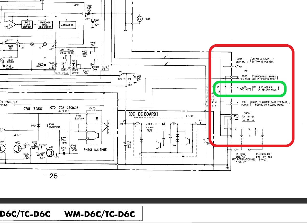

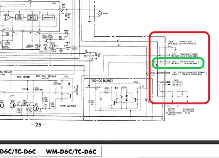

  7. Silver965
    Silver965 Well-Known Member
    721
    Torino
    I think this is normal .... the mechanism is not fully in position and does not unplug the mute switch ....... so you will hear the tape playing at high speed
  8. Kiwinut
    Kiwinut Member
    84
    New Zealand
    Mmmm just tried mine(both) and just F/F or R/W cue with no sound?
    Cheers Kiwinut
