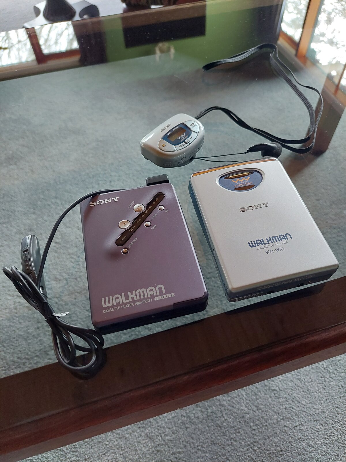

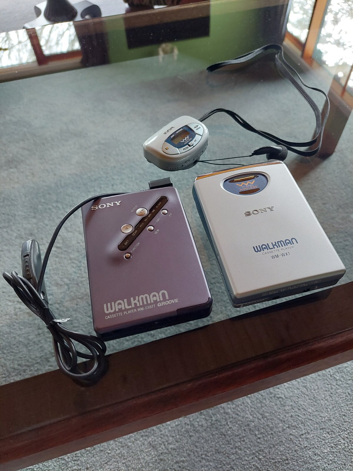

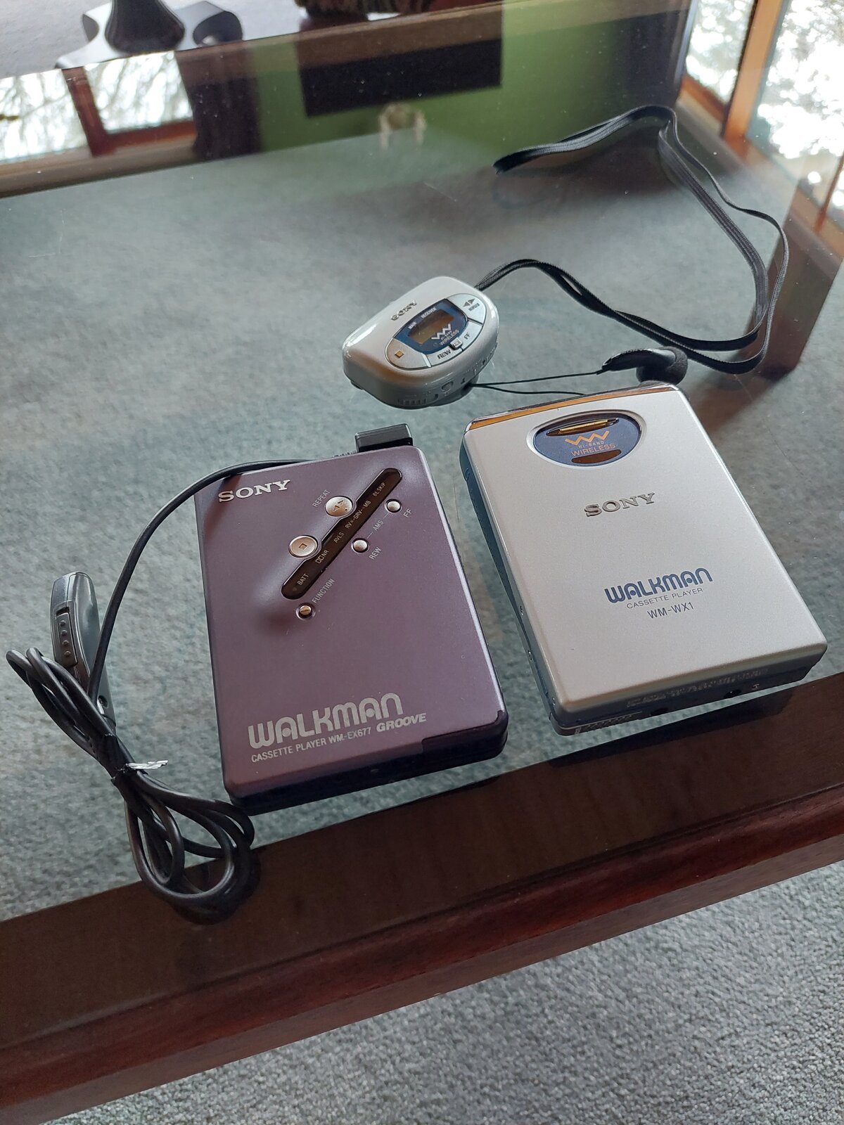

  17. Emiel
    1,060
    I did not see these side by side before: the WX1 looks so clean, really nice!
    I have yet to put my rebelted WM-EX618 to the endurance test with the supposedly 1450mAh gumsticks, hope it can get to 10-12 hours using a type I or II.
