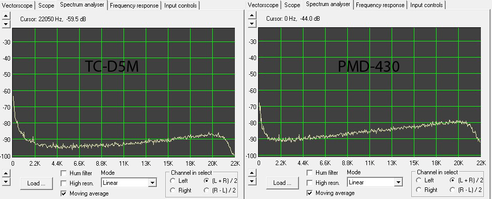

    I have done some measurements for reference, as I am sure some people will want to see this. Both measurements were done on the LINE OUT to exclude any influence of the headphone amplifier.
    The units were set with DOLBY OFF, the equalizer on 120us (TYPE I) and no tape.
    Some will be tempted to say that the higher noise on the PMD-430 is because it has higher bandwidth: while that is true (however the bandwidth differences between the 2 are not that high),
    lower noise in the TC-D5M can be seen in the entire spectrum, not just in the higher end.
