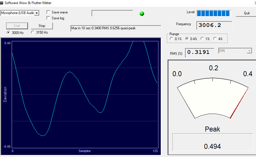

    As for the figure itself, don't expect miracles in regard to this WM-5. 0.2% WRMS or a little bit less is as best as you will ever get. As for testing, you really need to measure the value with WFGUI, otherwise it's hard to tell what is too high.

    In the uploaded screenshots you can see the W&F level I'm currently getting.

    Have to say the starting figure is not actually that bad. It most likely can be improved, but you will need to do all the things I mentioned, maybe even eliminate the eccentricity of the center gear to reduce this figure significantly.

    Given the waveform shown in WFGUI (looks like a slow almost sinusoidal variation), I'm inclined to believe it's the center gear eccentricity that causes this increased wow&flutter.
