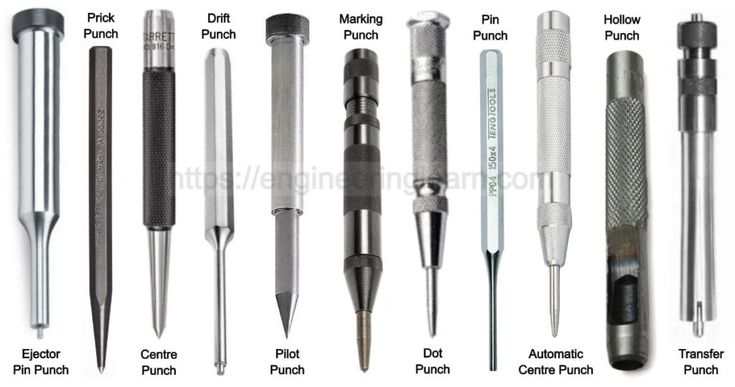

    For removing the pin itself, the ideal tool for this is an ejector punch of the same diameter as the pin.
    However it can be done with the tip of a small screwdriver also, as you already mentioned have done in the past.
    It's also important the opposite side of the bracket sits on a flat surface that has a hole where the pin can go in.
    A pair of pliers can be used for this (see second picture), but there are many other ways to do it.
