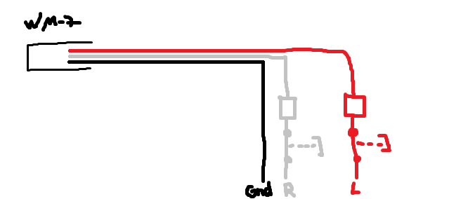

    Thanks, you're saying i should try something like this ? With a resistor in series on each channel and a momentary switch that opens the circuit ? I hope you will be able to understand this attached quick schematic .
  6. autoreverser
    1,849
    yep, something like this - just can' tell you und the value (...what a great rime :thumbsup:), i must dig in my boxes to find an original set and will measure - in the meantime just try, i think with a 100 ohms or something like that it should work - i would try the resistor in the ground- link, not hot channel...

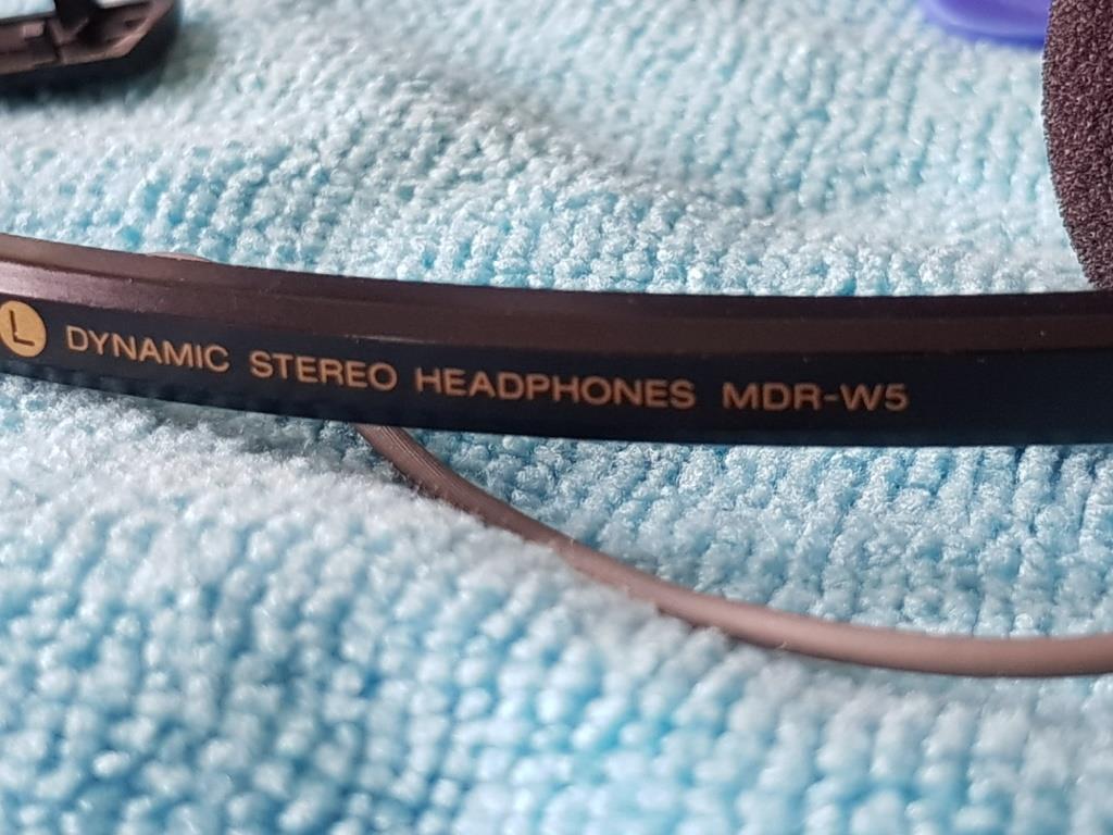

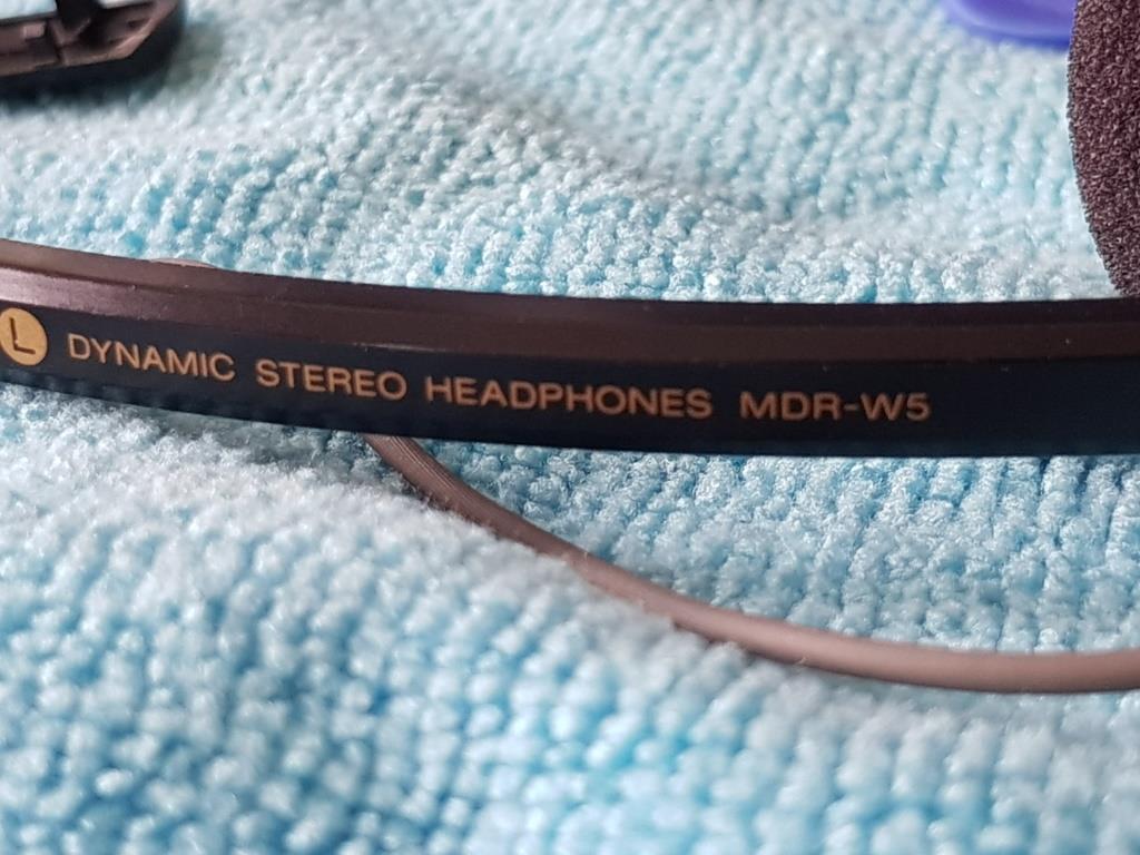

    Do you know by any chance the model number of the remote/headset in question ? I'd like to gather information online but i can't seem to find any information.

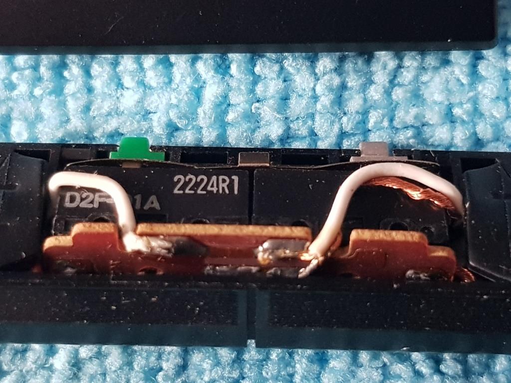

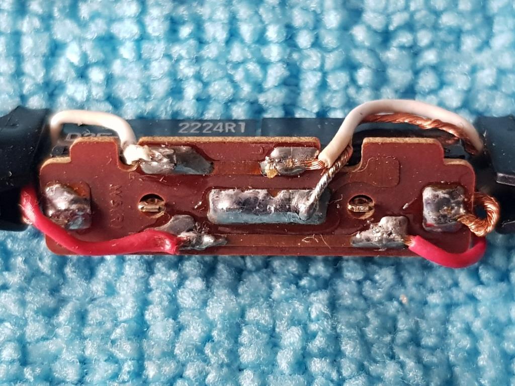

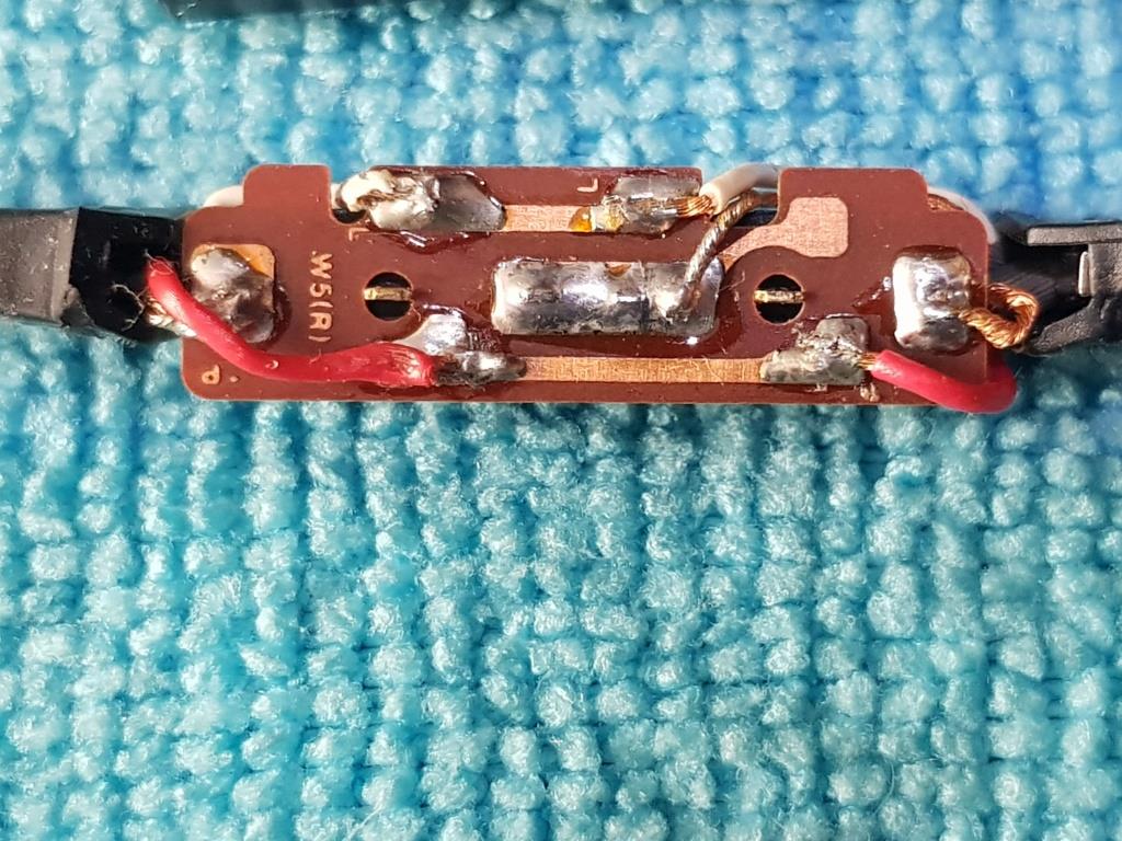

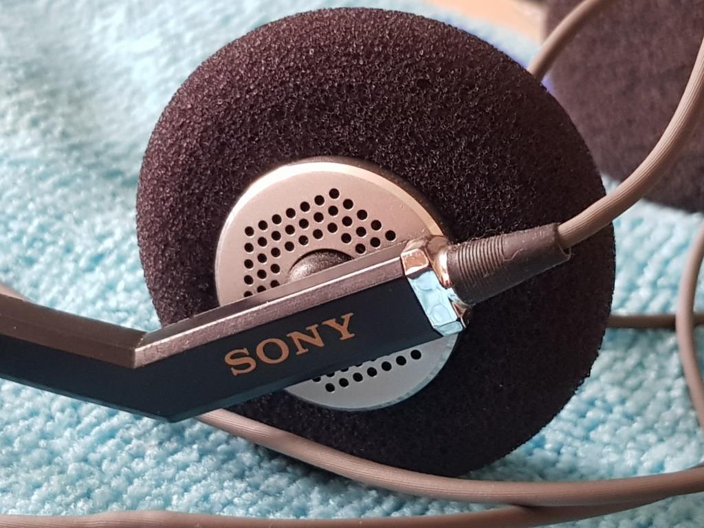

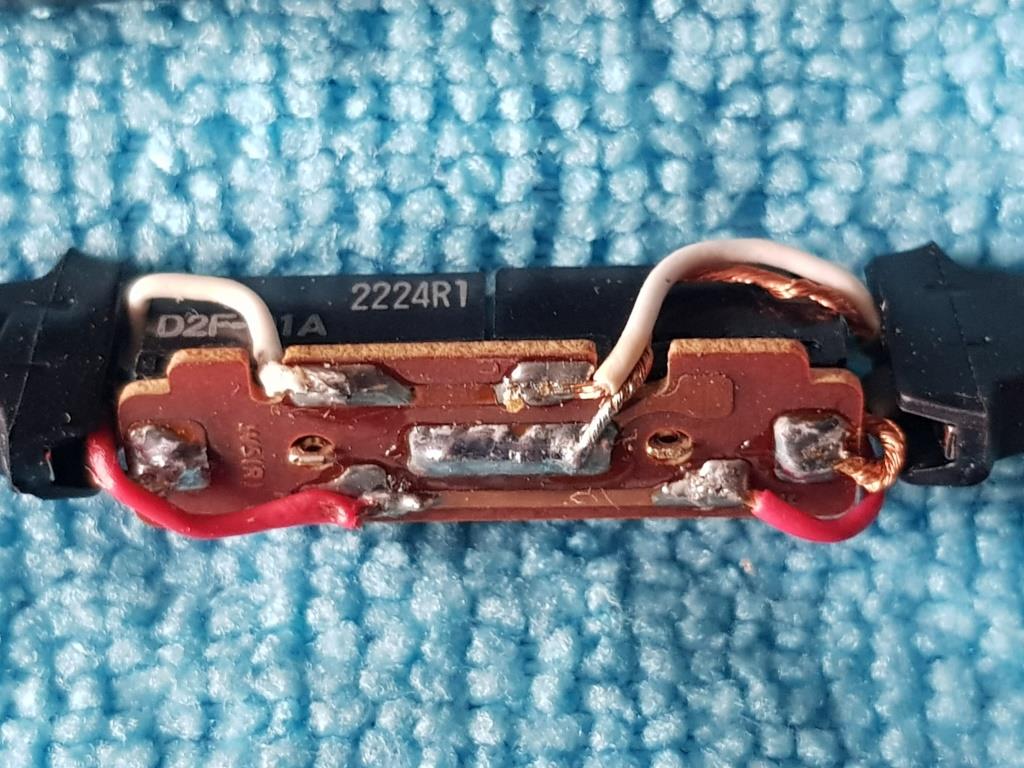

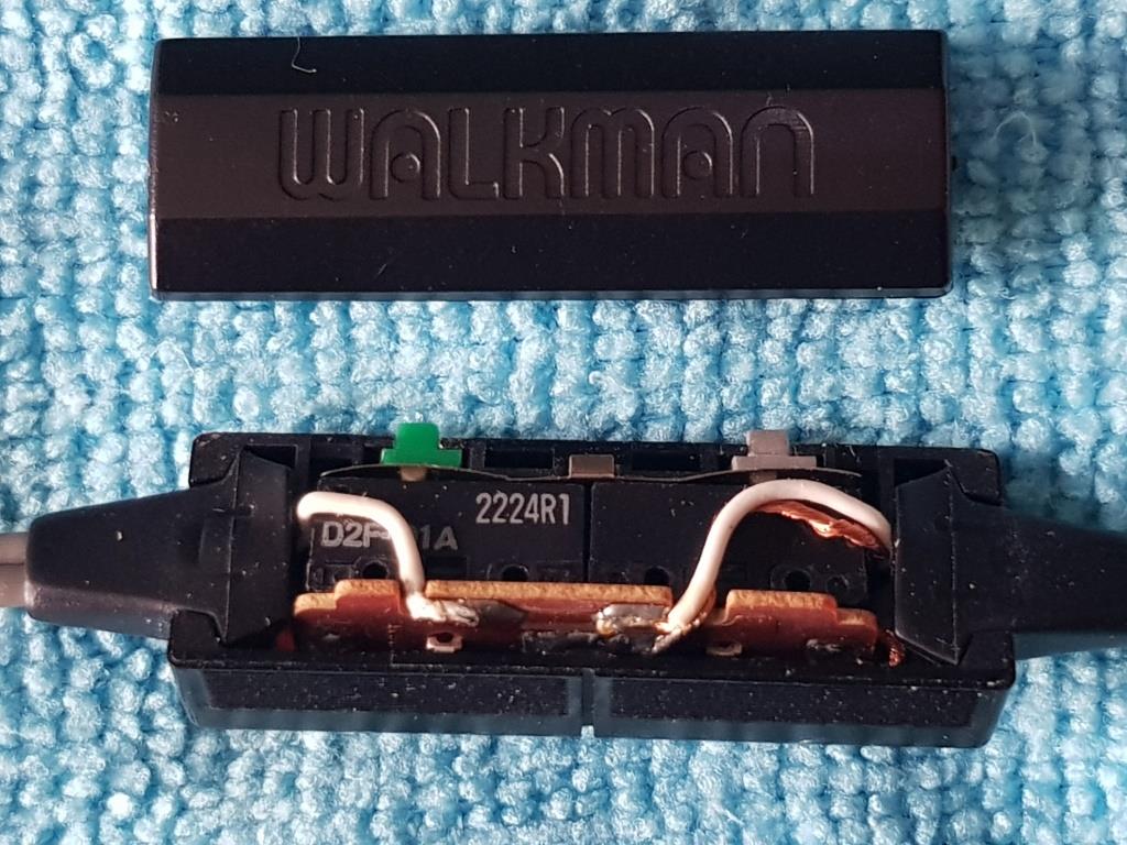

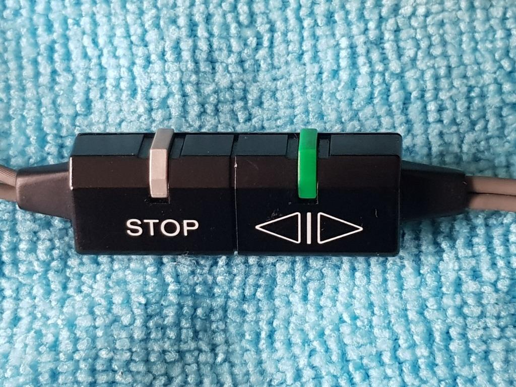

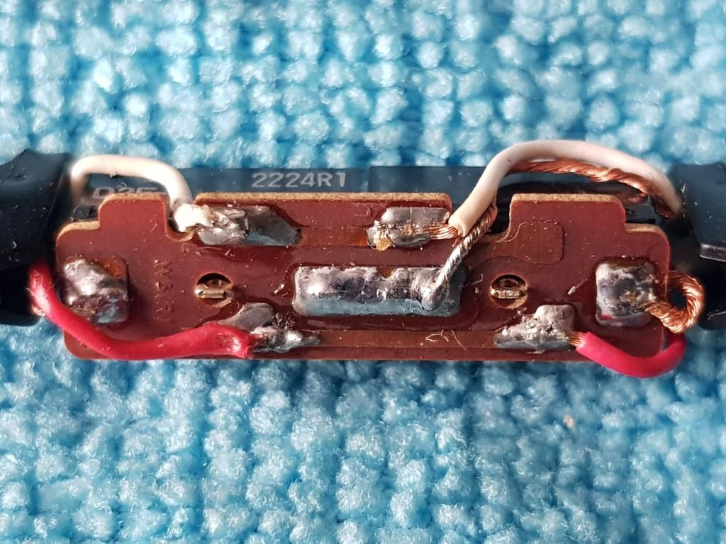

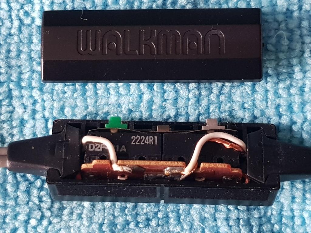

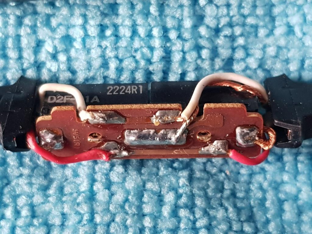

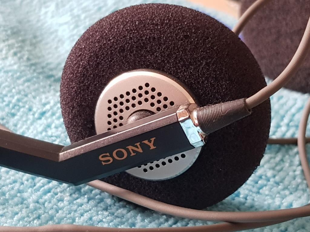

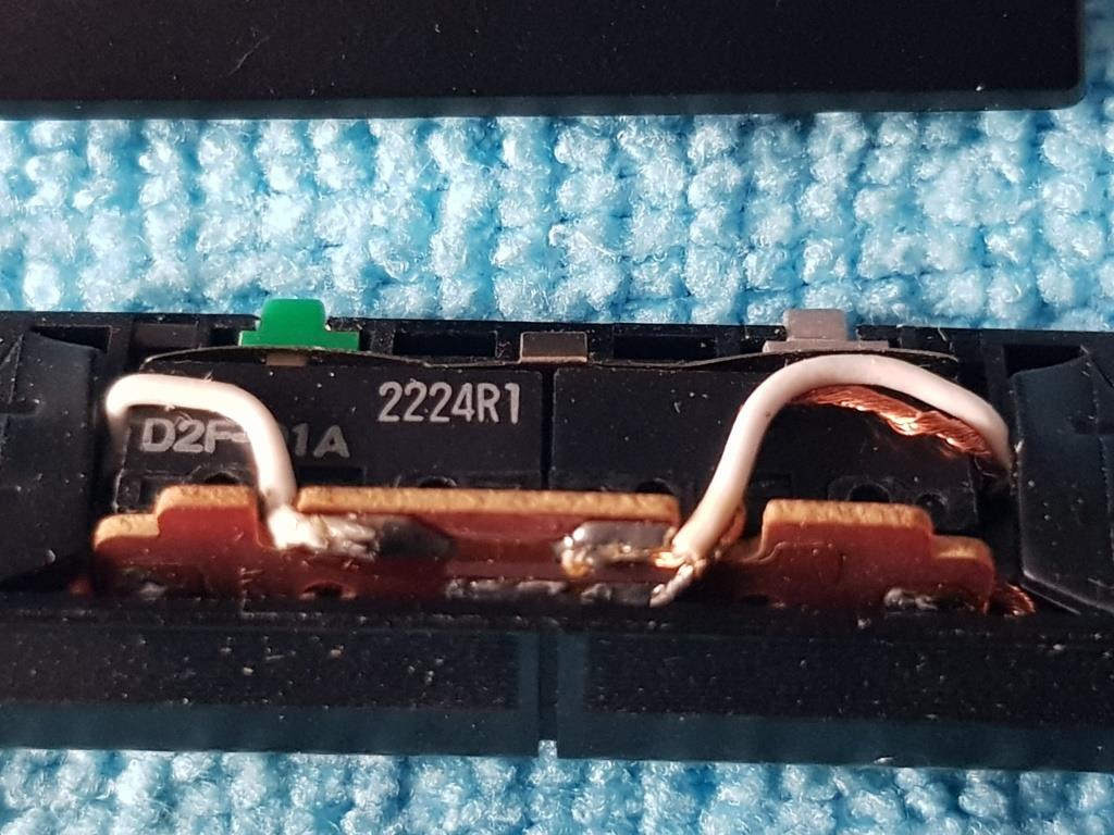

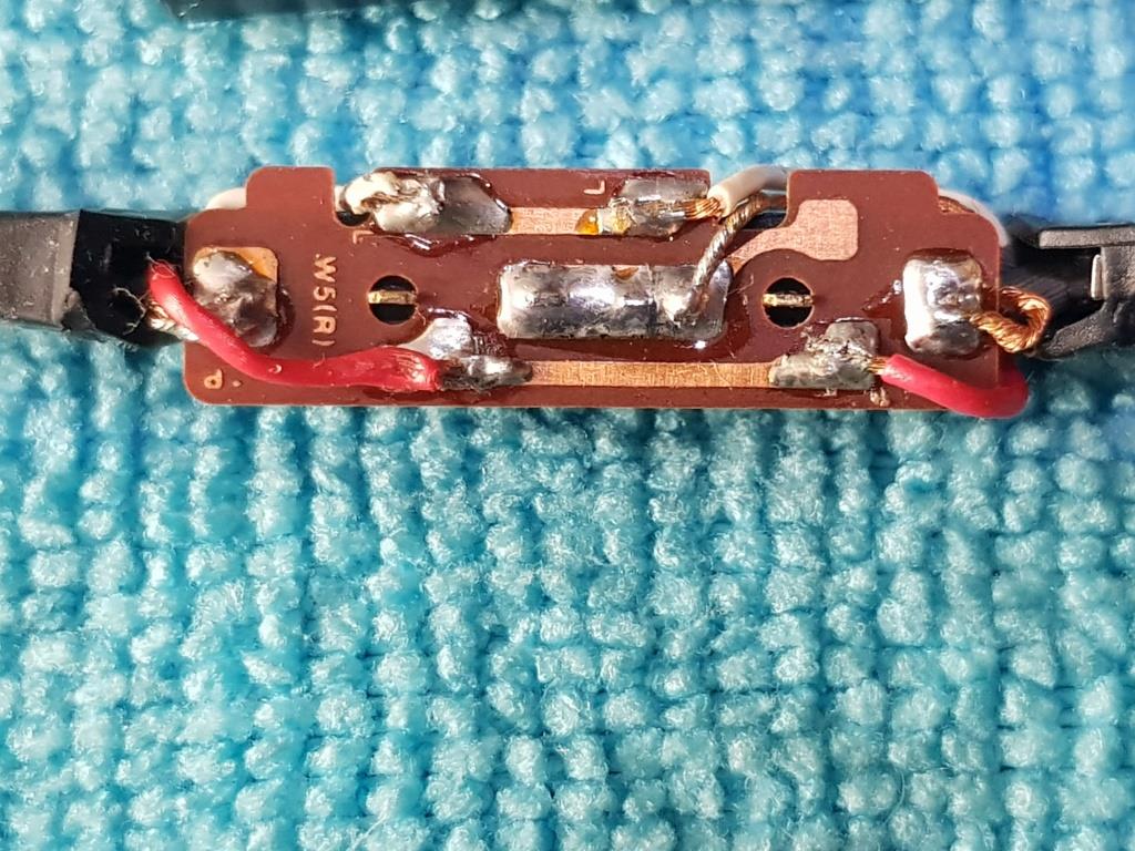

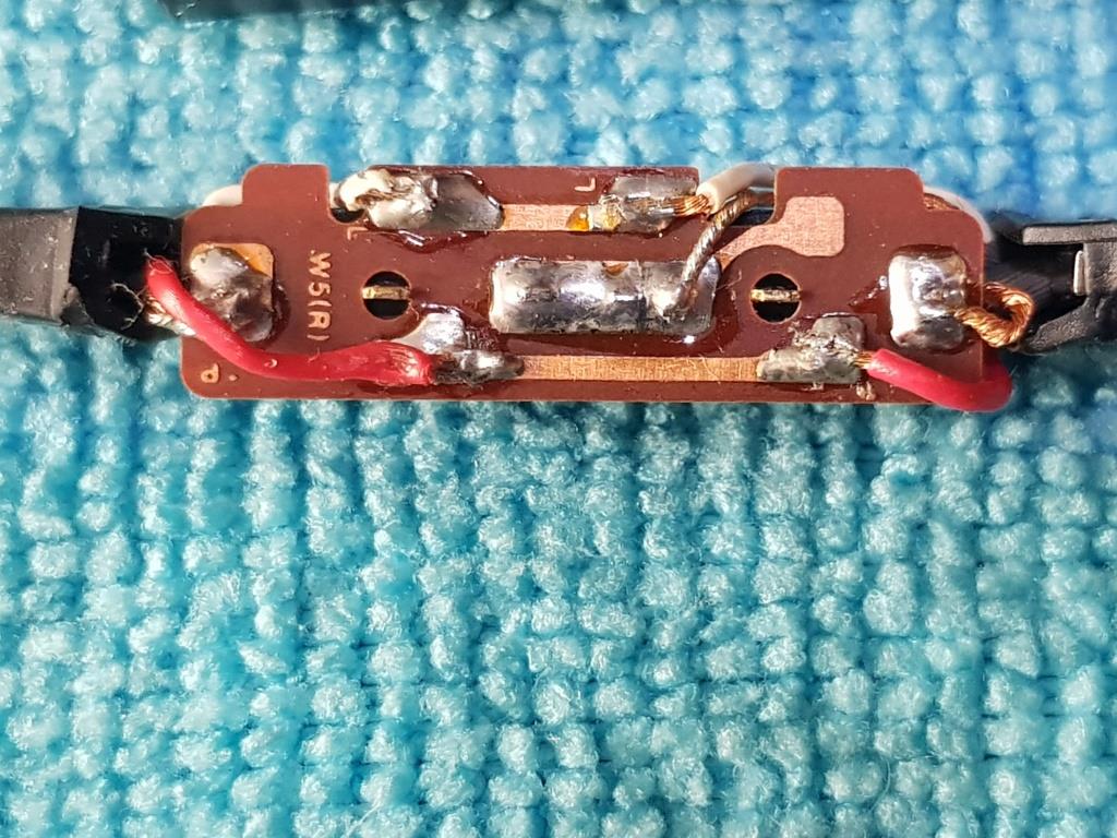

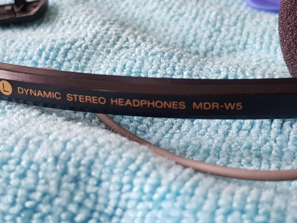

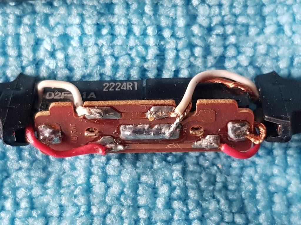

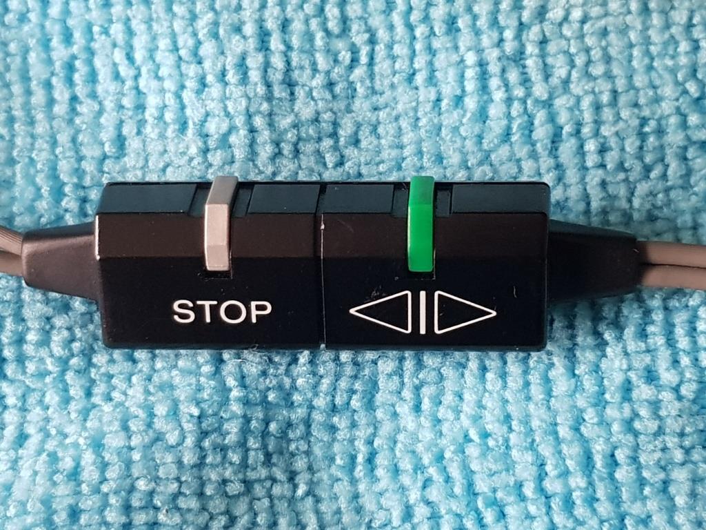

    I have several WM-7's including a pair of the remote headphones MDR-W5(R), so I opened them up to show the remote section wiring, hope this helps.
    Silver965, Boodokhan and flash_the_84 like this.

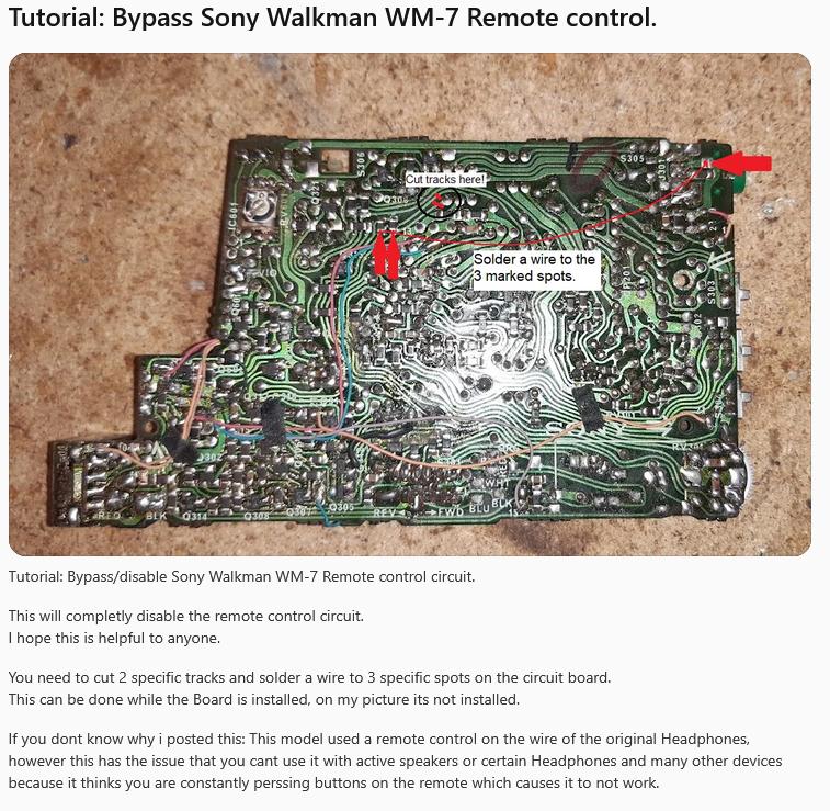

  11. dorenberg
    dorenberg New Member
    10
    Netherlands
    Hi there, is there already a solution found for this. I have the same issue with my WM-7. Just wondering is there is a solution. Any headphones I have used won't work. 4pin jack headphones. And also my Sony noise cancellation headphones.
