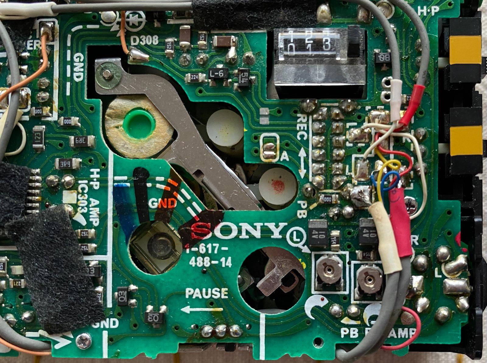

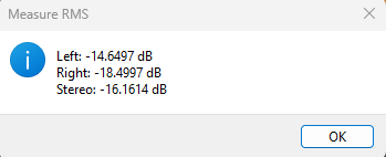

    Hi everyone,
    I'm progressing with my WM-D3 repair, now everything has been put back together and I could try a first recording.
    I have to say that playback quality is not really good on this unit (am a bit disappointed I must say) so I play it back on my WM-DD 33 which has far better sound quality. Indeed it's like day and night, recording is really good except that I have a noticeable balance issue between left and right channels, the left one being louder than the right one.
    Is there a simple way to adjust this without oscilloscopes or complex hardware (that I don't own)? I'm not looking for perfect as-per-specs measurement, simply aiming to fix my balance issue.
    Thanks in advance for any piece of advice!

    Yes, the simple way is to simply adjust it by ear. Rotate the trimpot until you can no longer hear the imbalance. Rotating counterclockwise increases the level, clockwise decreases it.
    Of course this method has a couple of issues (which are not as minor as they might look at first glance):
    1. You don't know which channel you need to adjust unless you do a measurement of the record levels on the line out and compare REC with PB
    Generally speaking, it's likely the lower one needs adjustment, but there's no way to know for sure without measuring.
    However a measurement would not be very releavant if not the PB levels are adjusted first.
    2. You don't know how much the PB levels are contributing to this issue. Those are usually off, even though by listening the difference may not be obvious.
    By adjusting only the rec levels you compensate in recording for a problem that is likely to be partially caused by an imbalance in the playback (Dolby) levels.
    3. The bias adjustment (which is L/R independent) also influences the record levels.
    So, if you want just a rough adjustment by ear, do that. However do keep in mind the frequency response on recording is likely to be off (even if it seems to sound ok) and Dolby encoding won't work properly.
    In my opinion, the most important adjustments by far are the playback (Dolby) levels because these will influence everything else. Unfortuately this adjustment requires a calibration tape.
    EDIT: Also, how do we know it's an adjustment problem ? It can be something else.
    You need to check that when feeding it a balanced signal you do get a balanced signal at the rec amplifiers and they don't get attenuated somewhere in between the line in and rec amps.

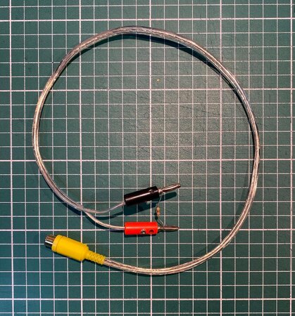

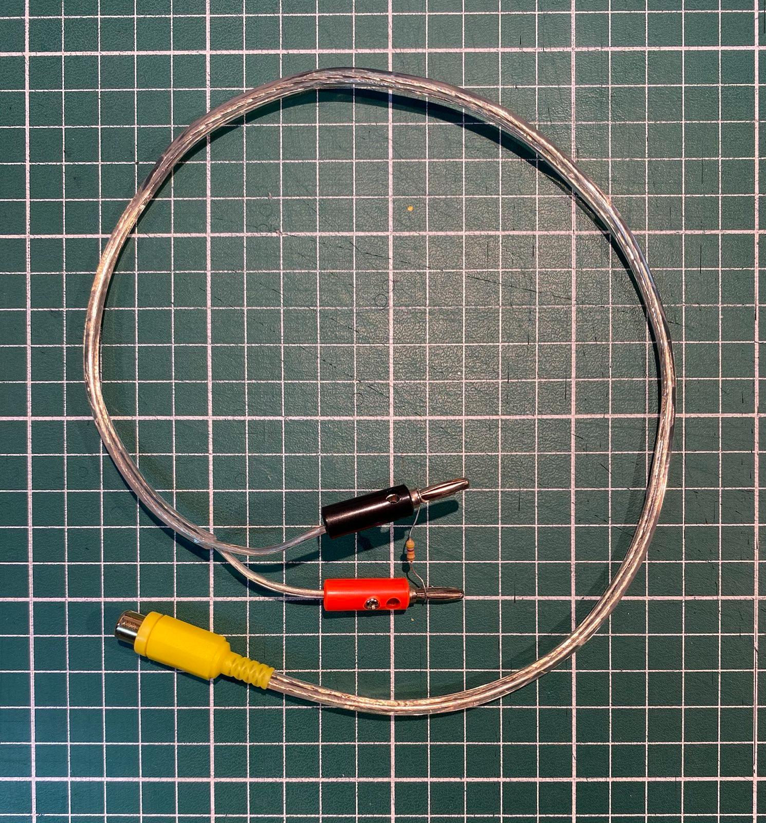

    The line out does need to be loaded with 47k for the playback levels adjustment. For this adjustment you do need to use the line out, headphone out won't do.
    Adaptors used for multimeter (or other measurement device you use) don't really matter. We're not talking about RF stuff here. Use/make any adaptor or multiple adaptors that fit your particular situation.

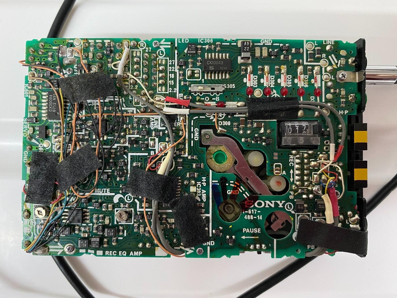

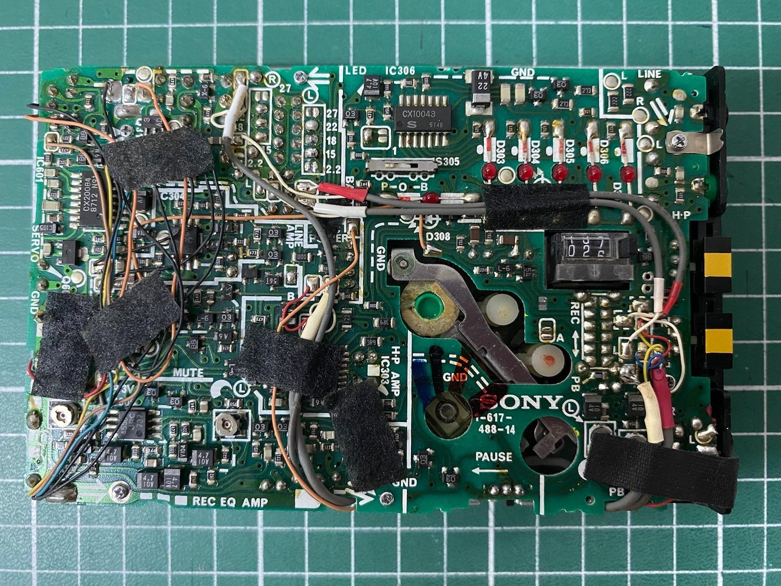

    Hello there!
    I finally received everything ordered (Dolby tape mentionned above, a TrueRMS multimeter, and small parts to build my cabling rig) and could perform the adjustments.
    I started by building my connectors (thanks to your post on the WM-D6 calibration tutorial):
    I could then start measuring my PB levels, and discovered indeed a difference between the 2 channels. Eventually I managed to set PB levels so that I read an average (was fluctuating but I guess that's normal) of 340 mV for each channel with the Dolby calibration tape (Dolby mode OFF).
    Then, I went for the recording levels, and actually had to adjust them quite significantly (i.e. with an input of 50.85 mV for right channel I started with an output of 37.8 mV, and with an input of 57.5 mV for left channel I started with an output of 47 mV). I adjusted trimpots so as to have output level matching input one for both channels, not accounting for the imbalance.
    I then checked PB levels again and had to micro-adjust to reset them to 340 mV for each channel (only by 1-2 mV approximately), and went for a recording... Tadam!!!... Pretty good to my ears, seems to be spot on - I guess my brain has to forget the initial imbalance, and that I'll need a few recordings from various sources to fully feel relieved, but I believe my problem is now fixed :)

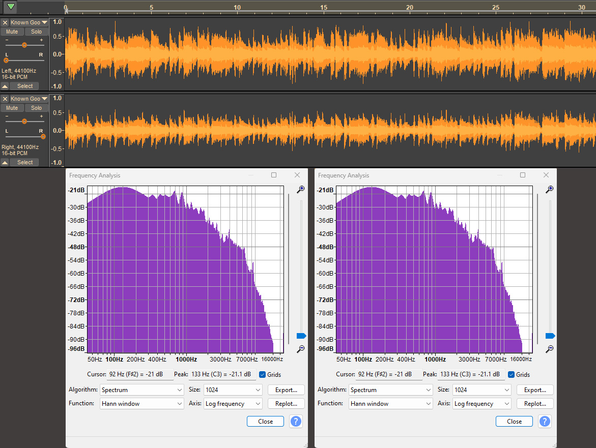

    Hello,
    I finally went through the bias adjustment procedure. I've tried a couple of different settings for the left channel, and when finally trying again the original one (15+18+22 pF) it actually proved to be the one closest (but lower) to match - strange as my first readings before touching anything showed a much bigger difference between input and output - could the unsoldering/resoldering have changed anything? Right channel was close enough, so didn't touch it.
    Then I readjusted record levels, and went through another music recording & listening test. Unfortunately issue is still there, zero improvement.
    I have to add something that may help better understand the problem. When I first listened to cassettes on this WM-D3 unit, I immediately noticed that playback quality totally sucks, so all my listening tests (not the measures) were made on my other WM-DD 33. I've never bothered to try again to actually listen what I record on this same WM-D3 unit.
    My procedure has been the following until now:
    • make all measures, adjustments etc... strictly following your tutorials, on the WM-D3 (using Line In, Line Out and Phones outputs)
    • for my listening tests, I record music on the WM-D3, and play it back on the WM-DD 33
    Today I've listened to my recording on the WM-D3 and realize that:
    • quality definitely and totally sucks - frequency spectrum is completely different, I totally lack in low and medium frequencies

    Hi, having received my external sound card I've been able to make a couple of tests a few minutes ago. I'm not finished but I'll share my first results and findings.
    The 3 attached audio files are from a known good tape I just bought on Amazon (Guardians of the Galaxy soundtrack). It is a Type 1 tape, with Dolby NR set to ON on both the WM-D3 and WM-DD 33 units. I've tried to capture with the same volume generated so as to have a good comparison basis. I've captured from the WM-DD 33, and then from WM-D3 from both the Line and Phone outputs.
    When listening to the captures before sharing them, I was struck by the fact that I didn't get that nasty difference between Line and Phone outputs on the WM-D3. When listening again directly from the WM-D3 with my headphones plugged in, I still had my crappy sound, until I realised something that completely escaped me before: my headphones have a TRRS connector (there is a microphone in the cable), whereas my jack-to-jack cable for capturing through the external sound card is a standard TRS (no mic) :confused:
    So the strongest difference between Line Out and Phone Out on the WM-D3 was due to a wrong contact in the connector plug (confirmed by slightly pulling out the headphone connector out from the plug, which fixes the issue when the connections are properly done) ==> 1 problem "solved" :rolleyes: Strange that I don't have the same with the WM-DD 33......
    Now, even with a pre-recorded tape, I can still hear some imbalance (or what sounds to me like some) on the WM-D3 which I don't have on the WM-DD 33. Typically, listen to the drum cymbal on the right channel around 20 sec and the difference between my WM-DD 33 capture and the WM-D3 ones - huge difference.
    What I can't really explain is that the difference I hear via the headphone between Line Out and Phone Out on the WM-D3 (even when cable is slighlty retracted to avoid the TRRS effect issue) is not really audible on the captures. Via my headphones, Line out is really bassy and lacks strongly in medium and high frequencies compared to Phone output, but on the captures it's similar - no idea why.
    Tomorrow I'll record the same song from my iPhone on the WM-D3, and will share the same captures afterwards (from the WM-DD 33, and then from the WM-D3 through Line and Phone outputs).
    EDIT: I see the capture files are reduced in sized during upload process, I hope you can still hear the differences.

  19. Valentin
    1,676
    I wanted to ask exactly that before my previous message, but after reading you used a pair of wireless headphones I assumed the mics are in the cups and they're probably using a normal 3 pole jack, so I simply skipped the question.
    This issue with 4 pole jacks I have seen on some walkmans and some portable CD players, although not all of them have this issue. On vintage devices it's prefferable to use a 3 pole cable, eventually an aftermarket one.
    I incline to blame it on the cable. If you have a different pair of headphones or IEMs, I do recommend trying them just to eliminate this as a potential problem.
    I listened to the files, can't hear an obvious difference between line out and headphones out, the problem seems to be there on both recordings and it is an imbalance.
    Importing the file into Audacity and doing a spectrum plot reveals there is no significant difference in frequency response between the L and R channel, but there is a strong imbalance (about 5dB) - see second picture attached.
    What is very curious to me is how this imbalance doesn't show in the PB levels measurement... Try to do the measurement both with and without 47k loading on line out, see what kind of difference do you get.
    Please post a picture of the PB level trimpots, I'm curious in what position are those relative to each other.
  20. dom69
    dom69 Member
    81
    Switzerland
    I'll try to find another pair of headphones and check if I get the same differences, however after writing you yesterday evening I managed to find another cable (without the mic) for my headphones (the QC15 is actually only cable not wireless, and came with 2 cables that you can switch) - and same result and differences between Line Out and Phones Out. Weird.
    OK I'll do again the PB levels measures (with and without the 47k load) and share. In the meantime, I've attached the picture of the trimpots:
